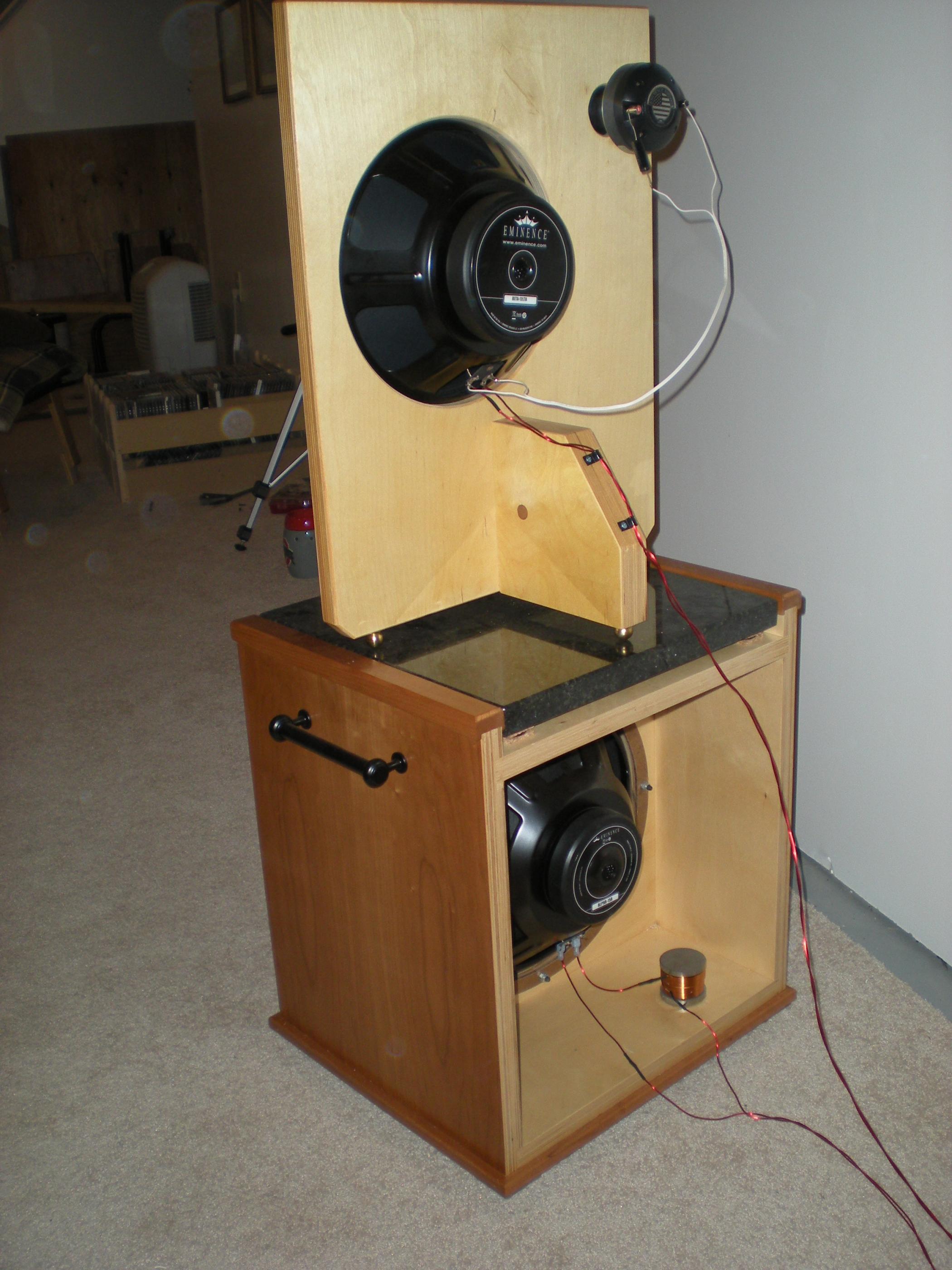

With a little bit of help from my friends...
Nice work well done.
I like the isolation between the base & baffle, I may have to see if I can apply something similar to my build, although Im probably too far in.

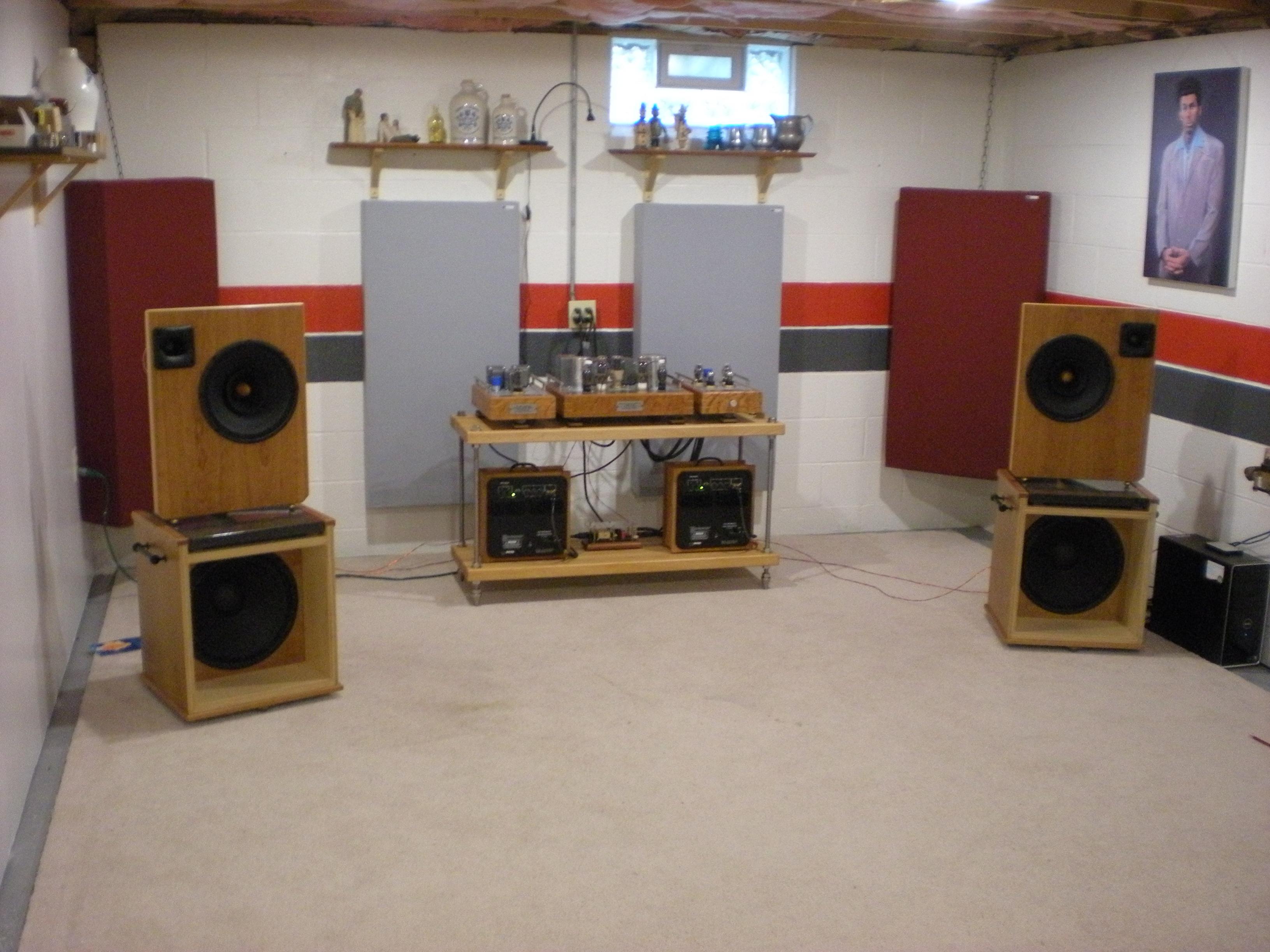

Very nice work. They look great and I bet sound great too.

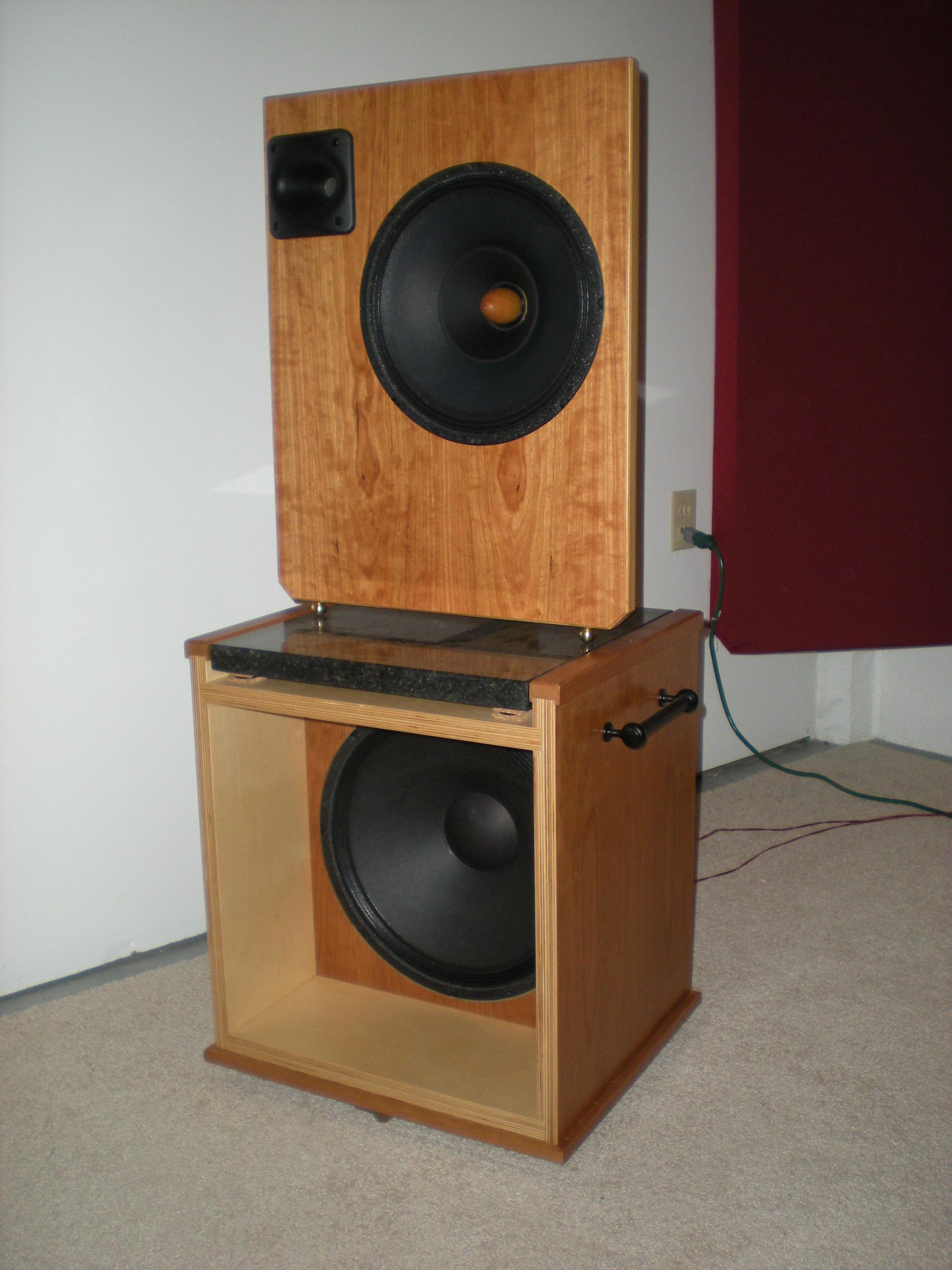

Nice. What size is your baffle? What tweeter and cap did you use?
I see Kramer watches over your system 😀
My upper baffles are 18.75" wide and 24" tall.
Based on comments I read from Godzilla's posts here, I chose to follow his direction and went with the Eminence ASD1001 1" HF TITANIUM HORN DRIVER 1-3/8"-18 TPI and wave guide. I tried several cap values, then settled on the 1.0uF.
The soundstage is huge from the 12LTA drivers and the tweeters just add that last bit of shine. I'm coming off 5 years of full rangers, so a tweeter has taken me a while to accept. It rolls off just over 10kHz.
