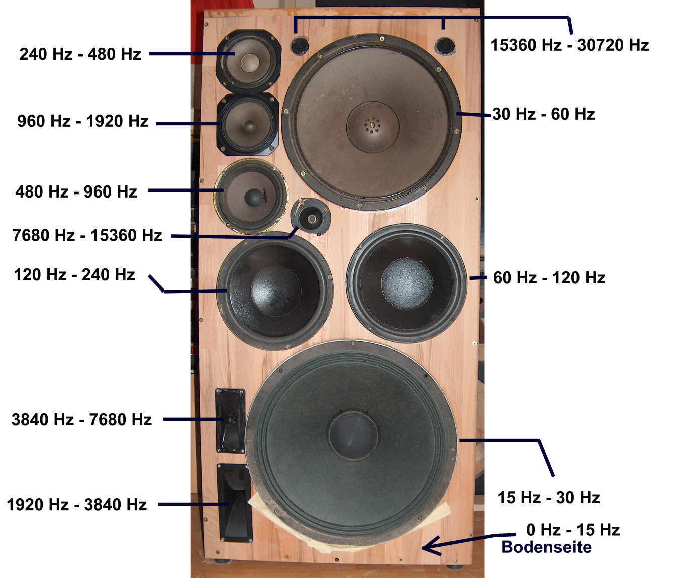

First of all your right in one point - the design causes more work than any other design.
second I´m sure that your experience in design of simple speakers might solve many issues -
but for sure there are more issues that you have not ever really touched - to go to the points that you stated / requested : the frequencyarea that a speaker is limited to operate is only 5 to 6 tones
and the crossovers used in the system are crossovers of forth order - a quality you probably might never see within a commercial system due to the fact that it is too expensive and its too much work to measure hundreds of capacitors and coils to find the correct fitting values - a task that no company would ever try to solve due to the fact that cost would explode..... and each speaker must be calibrated to a spcific given level of soundpressure emitted by the speaker to ensure the precise overall performance of all speakers in the system - and thats allready the next reason you´ll never find a company that would pick up such a task.
I´m sure you have viewed a lot of magazines that discuss the one or other issue of the task to design a speaker system and how to solve that one or other problem.
But allthough also a lot of issues are discussed without a given solution you might think of several problems to solve and at the same time
leave other problems beside due to the fact that a solution is related with to much efforts. Thats exactly the difference to this speakersystem.
This speakersystem was built under the focus to build only once a superior speakersystem and to carry out all tasks and to solve all issues and aim for only one goal : to get the best possible and technicaly availible speaker system
and to accept that that task forces the decesion that you must perform work and more work and spend hours for measuring and collecting parts that realy fit exactly with the needed values in the crossovers without
dealing with compromizes. And as explained: the measurements will be performed within the next 3 to 4 weeks - and the only reason that it needs that time is to get 3 points together:
first the transportation of the "fridges" ( my nickname to the speakersystem - bear in mind one maincase has weight of more than 90 Kg´s) to a studio in that a friend of mine usually is working as professional sound engineer,
second to get again that equipment boroughed from another friend, that has a job at Rhode&Schwarz as electronic engineer and that was allready used at that time when the speakers have been calibrated ( i guess you know that that is the highest quality of measurementequipment that can be used in such a task ) and third a free saturday or sunday that gives us (the friend of mine that is soundengineer and me ) the possibility to spend an entire day in the studio to use the echodead-room ....
but from the measurements performed during the process of speaker calibration i know one thing for sure: that graphs look nearly like drawn with a ruler....
the only reason that they must be repeated is, that at the time the speakers have been calibrated I did not waist a single thought to publish a description of all the steps of the project...
the first time thinking about documentation was two years ago after several friends asked me to perform a documentation.... and i just started that task one week ago and I´m just now searching for a bunch of other Photographs taken in those days when the soundsystem was built... and that was about some six or seven years ago...
Yikes!! 11 crossovers * 360 degrees = 3960 degrees of phase rotation. The group delay caused by phase rotation is generally inaudible with music and normal speakers but I'd be surprised if this one weren't audible. We're talking about the harmonics of an instrument arriving way before the fundamental.and the crossovers used in the system are crossovers of forth order
Sounds familiar; seems the working bandwidth of a driver is proportional to frequency. All the four way designs I've fooled with have essentially ended up with a sub for covering the excursion limited region, crossing off to a woofer above that to limit IMD and PMD.The only 4-ways I've done were essentially 3-ways with a built in subwoofer.
Depends on the listener; haven't seen any double blind studies, though I did come across one single blind result where a third of listeners didn't discriminate, a third prefered warped phase (nonzero group delay), and a third preferred linear phase (zero group delay). Didn't save the link though. Personally I scored 100% correct between linear and warped phase LR2, LR4, and LR6 within the limits of my ability to approximate double blind A/B testing last time I tried it; I always prefer linear phase.The group delay caused by phase rotation is generally inaudible with music and normal speakers.
The crossover in this 12 way may not be implementing what Linkwitz refers to as the "correct" topology and, even if it is, the earlier filters in the chain won't have achieved a full 360 degree rotation before the next one comes in (neither will have the last one by 20kHz). I'd have to sim it, but my guess would be the total group delay winds up closer to LR8 in the "correct" topology.

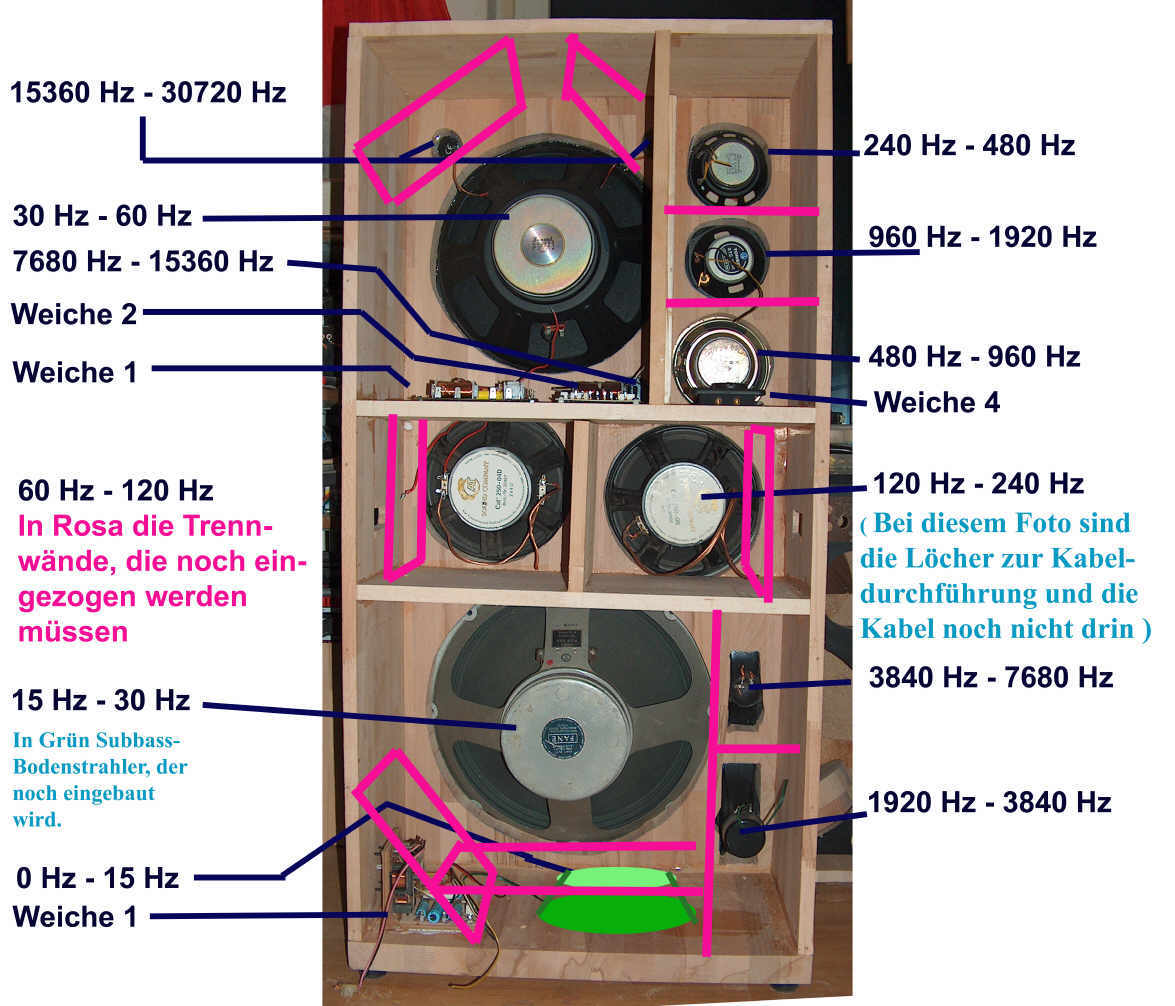

In many years of more or less professional speaker design I have learned a thing or two. For example: Component values with five percents of tolerance are absolutely fine, this is mostly far better then speaker parameter tolerances.
And if i look at the... well, not very high value drivers used here, I doubt that it is possible to build two somewhat identical speakers at all.
And no, you can't compensate speaker parameter deviation with changing crossover components (at least in most of the cases).

Here are pix off the site. my concern with this speaker is all the electronics used to integrate all the drivers with eachother. In my mind, it seems there could be a loss of something in the music.....maybe not.

Yes, of course provided this are about the RIGHT values to begin with (which means they have to approximate the acoustic filter responses together with those of the drivers) and not only some resistor & xover frequency values thrown in a textbook formula and "calculated".Component values with five percents of tolerance are absolutely fine....
Try and design a 15Hz xover and then tell me where the components are. Then do the same for 30, 60 and 120. Yea, that's going to work! I assume that's a pic of the "before I put it together" cause there is a lot of wiring missing> Those electro caps are going to work well. Just the thing for a world beater.
If it's a joke it goes too far. I am thinking that he is for real.
Terry
Well, I could say now: "I`ve told You so" .....but I don`t
This "design" and above all the attitude of it`s "creator" is the most unbelievable and hilarious thing I`ve read about in an audio internet forum EVER.
Ronin -- may I suggest that before you continue to berate people here for not having read all your documentation, you should first finish the translation? Most here don't speak German, and the links at Basisseite Final Solution 04 don't work!! The only thing that can be read is your description of yourself.
Or are only German readers allowed to comment on your speaker system?
Until that translation is available, perhaps you could describe how you handle the off-axis responses of the two tweeters down at the bottom of the baffle, down near the floor? You are aware, aren't you, the frequency response and level of drivers changes at different listening angles -- and dramatically so for horns like those?
In fairness, most of the links do work, but you need to click on the numbers to the right rather than the text.
Frankly, I still regard this whole business as quackery. To each their own I suppose, but the waffle about drivers having very narrow optimal operating windows smacks rather too much of MIT wire's (give me strength) 'poles of articulation.' As far as I'm concerned, if a driver did indeed possess such a narrow useful BW, then it is clearly unfit for purpose and should be immediately replaced with a unit possessing acceptable performance.
Even if you did decide to buy into this theory, the attendent problems of multiple XOs, several of which are slap-bang in the middle of our critical hearing BW, with disparate types of driver seemingly scattered across the front baffle without regard for system polar response do tend to rather detract from the appeal. The arbitary statements presented as fact without a single measurement to support them, and the fact that this alleged speaker (since we haven't actually seen any evidence of it in operation, let alone of its reputed performance) has apparantly also been created without any such tests being made, lead me to regretfully conclude that this device, should it actually exist, is best assessed by my close friend attached.
Incidentally, are those woofers at the top old Sansui units? They look like they've been pulled from an SP3500 to me, or something akin. If they have, it's a crying shame. Those old speakers, despite their limitations, have quite a following.
