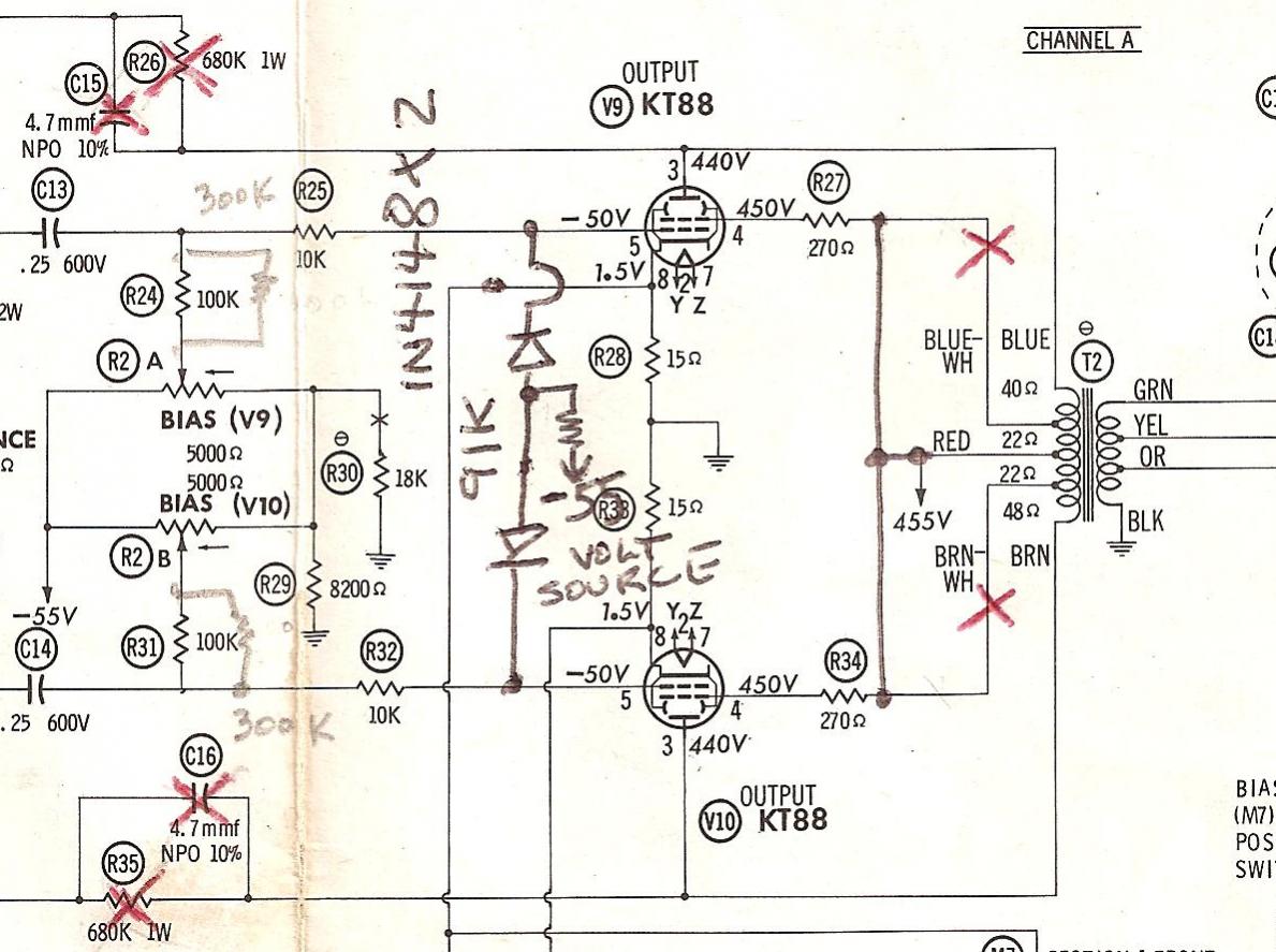

I would suggest you to take Citation II mod by Stew Hegeman. You can use 4xKT88 or 2xKT120.
You can download schematic from my blog.
Download Schematics & Service Manuals | MacGuru HQ
Additionally, you can take almost any PP amp with 2xKT88 and use 2xKT120 or 4xKT88 instead to increase output power. If you use quad of tubes instead of pair, you will need transformer with twice lower primary Z. As for KT120, ask other people on forum, I have no data for this tube.
IMHO, 10 Hz at full power is too low frequency will result in huge output transformer.

Hi LinuksGuru 🙂
3 Questions.
I think it's a little strange in terms of output transformer. look at the picture, there would you see that the top turning in the winding. It does not have the same resistance as the bottom.
Which transformer would you use if you wanted to run with 4 tubes KT 88
http://www.audiomarketing.net/bart2.htm
What about the changes that are made, shall they be carried out?
Bedst Regards Allan
3 Questions.
Bedst Regards Allan
Hi LinuksGuru 🙂
This is normal, winding on outer layer has larger mean winding turn length, so resistance of second part of primary is slightly higher.
BARTOLUCCI TRANSFORMERSÒ
Better to ask Bertoluchi himself, he knows his own products much better. I think 100W 2.5K should be fine.
Hmmm, I'm not sure. Better to sticj with stock schematic for the first time.

Actually schematic is not very original, its design is based upon simplified (stripped down) Sansui AU-111.
PS. Citation II has 30dB NFB (sorry, forgot source), so it is very sensitive to phase shift. 100W transformer is quite large, thus, even if it will have low leakage inductance, distributed capacitance will be high for sure. Resonant frequency of original Citation II transformer is over 200KHz, and this is not done just for fun, but to make amplifier stable at HF.

optimize (if possible).
I will start to change the solid state rectifier in to 2 X GZ33 instead.
I am aware that there is a higher voltage drop across the GZ33 tube than
solid state rectifier, again if I increase the B + voltage.
I would like if there is anyone which has knowledge of the M125 or any
ideas, or commentators, and especially on the basic structure of the M125,
then please say so. I have never heard the M125 play.
In advance thank you🙂
