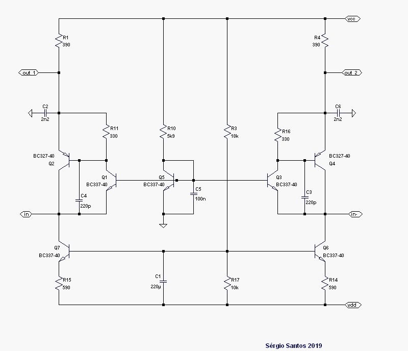

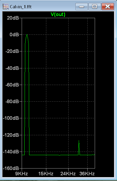

I took a look at Marcel’s FIRDAC schematics which you linked, but, on only a too quick review, the circuit appears not so simple. Being lazy by nature, I didn’t take the time or effort to accurately determine the answers to all of those specification questions I had asked about in my last post.
That said, I’m including the schematic of a rather elegant, fully discrete circuit. It is fully differential (and can simply be cut in half if only SE operation is required). Incorporates the DAC I/V function (since it is an I/V circuit). Doesn’t utilize GFB, but does use short local FB loops. Features a differential output impedance of essentially 780 Ohms, and half of that if operated SE (the values of which are inversely adjustable against the gain). It does all of that with only 7-transistors, 6-capacitors (including a 1st order reconstruction filter) and 9-resistors.
It was designed by diyAudio contributor Sergio Santos (smms73), so ALL credit goes to him. It was originally intended for use with the popular PCM179X family of differential current-output DAC chips. The other image is a simulated distortion spectrum of the circuit with a demanding 10kHz input signal, it looks like. It features the sort of figures you were hoping for. Another desirable aspect of the circuit is that, because of the local FB, the distortion performance is not based on close matching of the transistors, as would be required for an open-loop circuit. You will have to do the work of determining whether, or not, this is suitable to your specific application.

@Ken Newton : Thank you also for your feedback & pictures. As it is I actually have used the more basic variant of Sergio's circuitry - the common base coupling - for years now exactly in relation to the PCM1794. In this context, as I reckon you already know, it is capable of extraordinary performance depending on the voltages and currents used (the R1,R4 resistor value) - potentially outperforming the PCM1794 by a good margin.
I have also considered the common base (and a Sziklai circuitry similar to Sergio's) in this context, however, as I have been thinking about it there are a couple of additional factors to include with Marcel's DAC:
