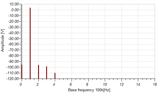

@ThorstenLRegarding the Kulish circuitry I linked to, in LTSpice it simulates to ~-122 dB 2H with the setup shown in the link (see attachment). Output level 4Vpp. However, other transistors simulate better than the 2N3904s.

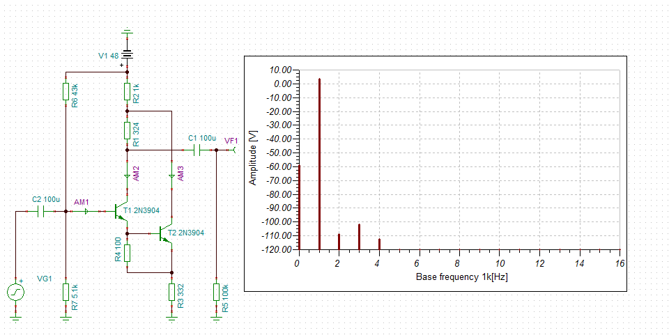

I simply put the circuit into TINA as shown. It simulates as I show.
Knowing what I know about practical circuits I think TINA is on the money and why Switchercad is one to two decades out of the ballpark may relate to the simulation engine or how well the transistor models are made. Simulators are only as good as the models and underlying math,
In practice I have found it to be capable of at least - 108 dB 2H -
Interesting. With 2N3904? Without trimming resistors just so? Do you have any posting about this?
Also, which resistor needs trimming to get the minimum H2. I'm open to see if tweaking this in TINA, which has different models, gets a better result.

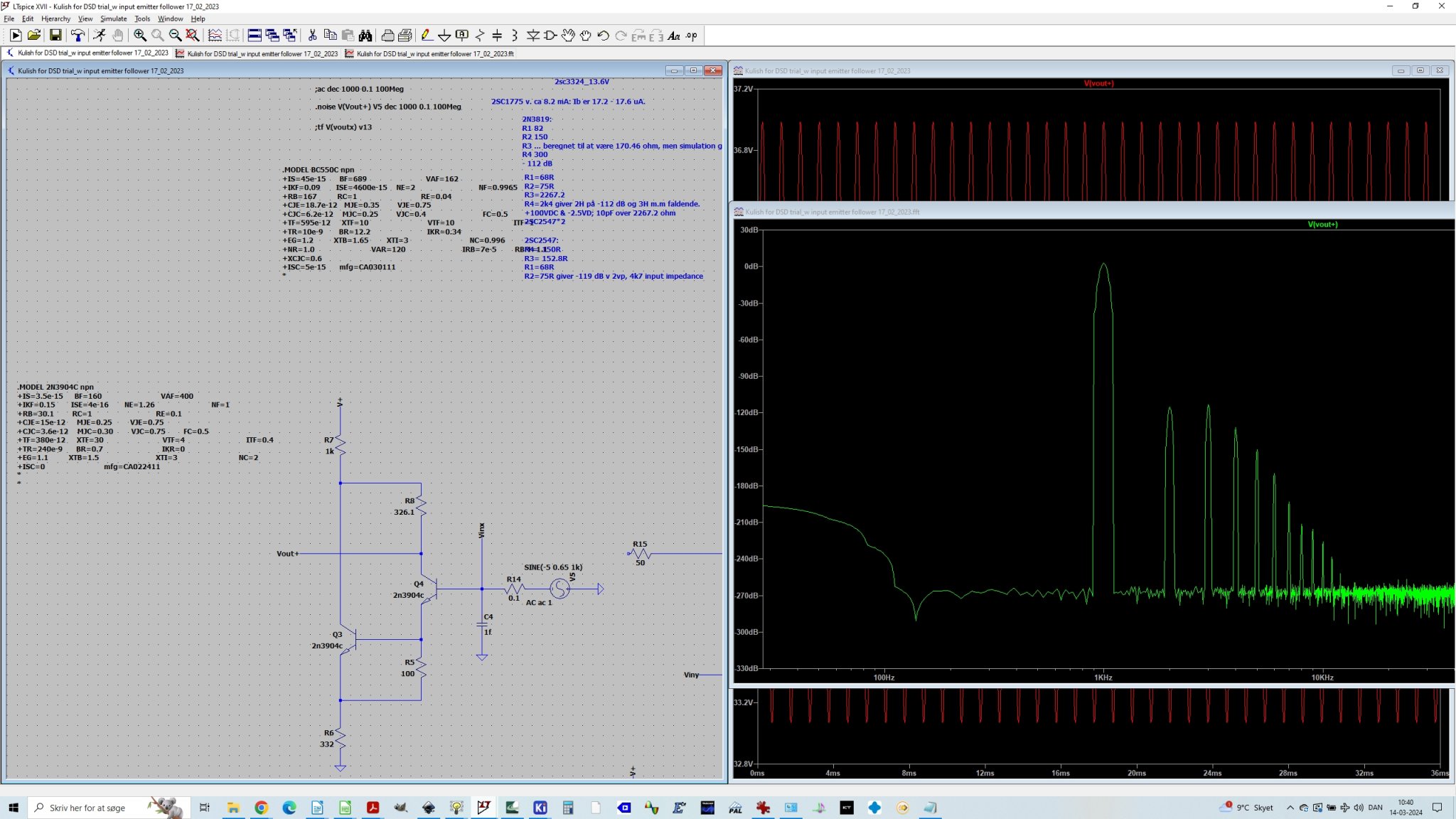

Regarding the Kulish circuitry as I mentioned it is quite picky with regards to parameters so I would not expect a different model to give the same result in simulation. I have attached a simulation where I use Cordell's spice models and have made a preliminary optimization of the typically relevant resistor (318 ohms in the link I posted). With this optimization the distortion drops from - to my memory - ~85 dB 2H to ~-115 dB 2H. Again done in LTSpice.
As you can see it is quite discerning regarding the correct resistor value and on my PCB I mounted a trimmer to be able to fully optimize the distortion level. Then I intended to subsequently replace the trimmer with fixed resistors. I don't have any precise recollection of which transistor combination achieved the -108 dB 2H but it probably was something like the 2SC3324 or its newer successor. And again, the setup was not optimal so I would not be surprised if it was possible to achieve a better result.

Ok, so I had another go.
I added the minimum components to make it a practical amplifier.
So yes, we can cancel H2 ( I suspect with more effort to zero).
However the resistor value that does this is very precise. Being of 0.3% either side means the cancellation effect is gone. Changing simulation temperature a few degrees also changed HD considerably.
Rise of HD with frequency is also considerable:
I suspect to actually get such performance in practice means trimming and frequency compensating each amplifier and operating in a temperature controlled environment.

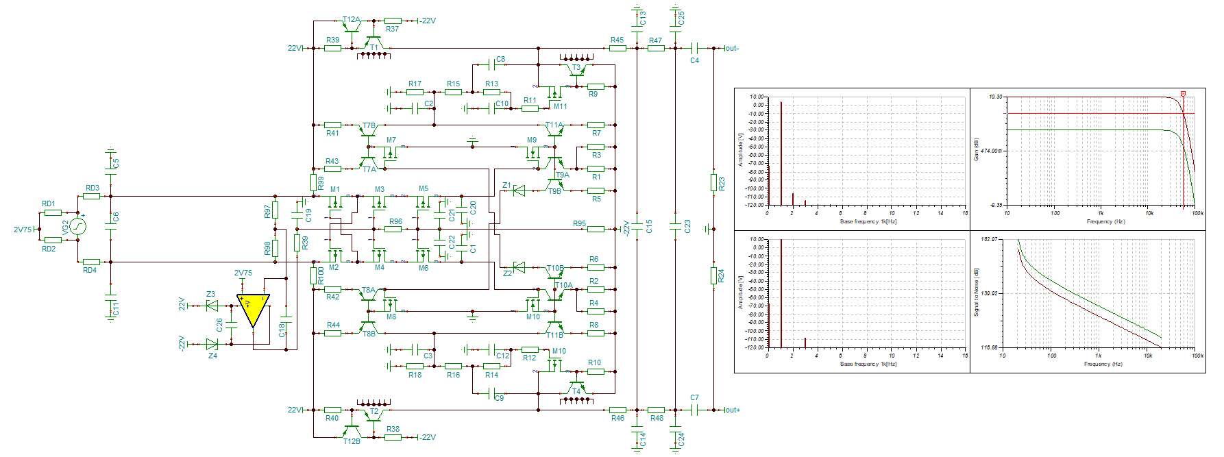

So I chased the cross quad I/U with CM splitting/mixing through some iterations.
First, the cross quad works better with Mosfet's, which is how I have seen it before.
Specific parts are some low noise dual SOT363 SMD small signal Mosfets or the single equivalents. But the noise in the circuit is not really sensitive to transistors, resistors in the DAC and CM's are determinant. The PNP & NPN are again "generic" low noise, high hfe types duals again. Pick what you like.
The degeneration resistors in the CM's need to be matched to the specific transistors to give lowest HD. The minimum is relatively shallow, but distinct to transistor types. The optimum degeneration resistors for the PNP mirrors are around 4 - 5 times that of the NPN mirrors, no matter what specific types are plugged in. I suspect 2SC2240/2SA970 if available as duals (or at all) would do very well.
Each transistor and/or FET has an "Ideal" offset current supplies by R99/100 for lowest distortion, resistors show lower noise and HD in the SIM compared to a CCS. If I where to make a PCB I'd probably include options for CCS/CM for biasing and see if CCS biasing can be made to work IRL.
Using the parts I simulated with, we need ~120mA @ +/-22V, quite a bit of current and dissipation.
Don't ask for the values and types, don't ask for a PCB GB etc. This is just an investigation into principles.
In principle low noise and low distortion is possible with this circuit. Trimming is required and the Sim can only be trusted so far. On the balanced output -120dB H3 and ~117dB SNR seem possible. No global or looped feedback of any kind. And in my books at least the circuit is relatively simple.
Ok, that's my conclusion on my contribution in this thread.
Thor

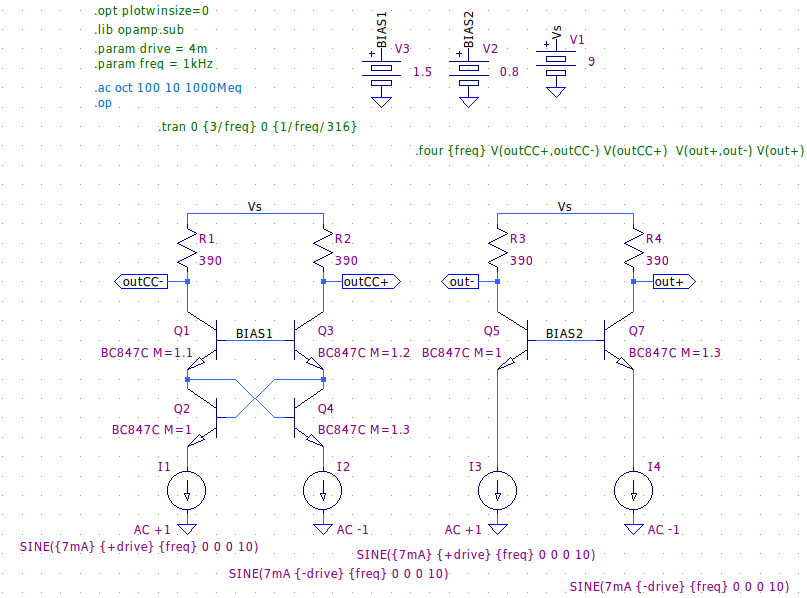

I played with @MarcelvdG's basic crossquad but fail to see the improvement. Distortion of the differential output is good but no better than that of the simple common base. What is better, though, is lower input impedance but the voltage at the input node is much more distorted.
What am I missing?
Fourier components of V(outcc+,outcc-) Harmonic Frequency Fourier Normalized Phase Normalized Number [Hz] Component Component [degree] Phase [deg] 1 1.000e+3 3.094e+0 1.000e+0 90.00° 0.00° 2 2.000e+3 3.774e-6 1.220e-6 1.77° -88.23° 3 3.000e+3 2.330e-6 7.530e-7 52.32° -37.68° Partial Harmonic Distortion: 0.000144% Fourier components of V(outcc+) Harmonic Frequency Fourier Normalized Phase Normalized Number [Hz] Component Component [degree] Phase [deg] 1 1.000e+3 1.547e+0 1.000e+0 90.00° 0.00° 2 2.000e+3 5.024e-5 3.248e-5 177.67° 87.67° 3 3.000e+3 1.156e-6 7.473e-7 51.33° -38.67° Partial Harmonic Distortion: 0.003249% Fourier components of V(out+,out-) Harmonic Frequency Fourier Normalized Phase Normalized Number [Hz] Component Component [degree] Phase [deg] 1 1.000e+3 3.111e+0 1.000e+0 90.00° 0.00° 2 2.000e+3 1.689e-6 5.427e-7 15.64° -74.36° 3 3.000e+3 1.386e-6 4.456e-7 71.24° -18.76° Partial Harmonic Distortion: 0.000071% Fourier components of V(out+) Harmonic Frequency Fourier Normalized Phase Normalized Number [Hz] Component Component [degree] Phase [deg] 1 1.000e+3 1.556e+0 1.000e+0 90.00° 0.00° 2 2.000e+3 5.092e-5 3.273e-5 177.85° 87.85° 3 3.000e+3 6.908e-7 4.441e-7 68.37° -21.64° Partial Harmonic Distortion: 0.003273%
I wonder if it still works better with MOSFETs when mismatch is taken into account, particularly beta mismatch if you use them in strong or moderate inversion and subthreshold slope factor mismatch if you use them in weak or moderate inversion.
That's why I am going to use a dual from a fab that is pretty consistent. With around 5 Ohm effective source impedance and enough voltage to get into the saturation region I think it will be ok, given the source degeneration from the DAC output impedance.
Given pinouts are compatible, one might always sub dual BJT's if it's NDFG.
Thor
