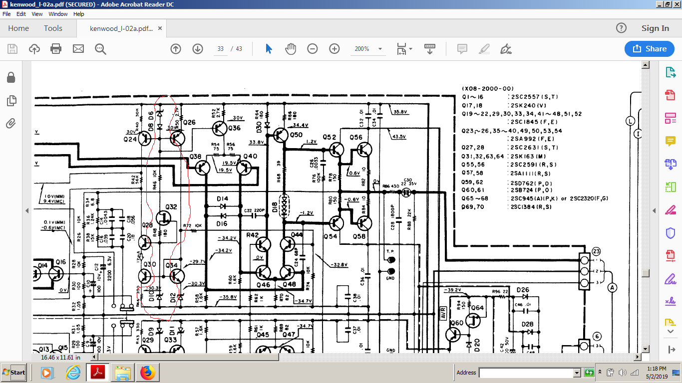

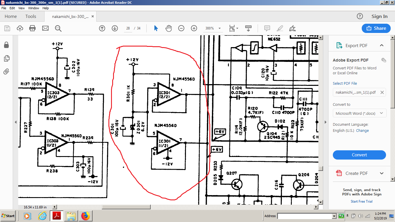

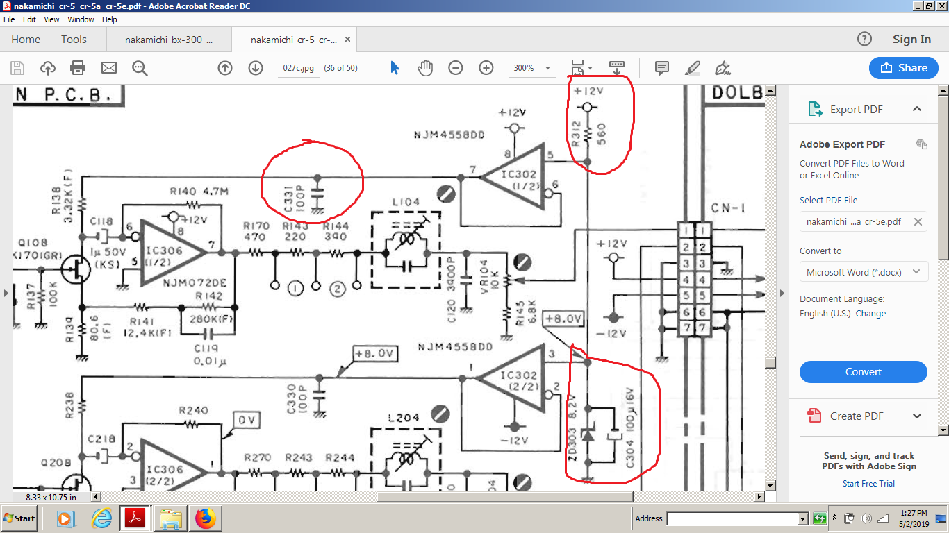

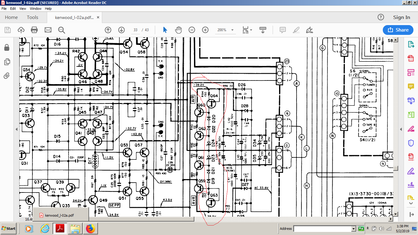

Here are all the techniques learned from the masters that i use in everything that needs to be low noise:
1.At high power supply use a bf256 as current source for a 6v2(5v6) Zenner(zero tempco) in series with a suitable diode to make thermal compensation of the ccs if it's the case.This simple technique is used in some of the best phono preamps, including kenwood l-02a which i talked about many times and you have it attached.

3.You can introduce the j-fet ccs used in Kenwood to improve the psrr of the op-amps reference in Nakamichi .
4.See also how they made the virtual ground(6v ) in Nakamichi bx300.Better opamps could do it for modern electronics.Tape cassettes don't need huge slew rates.
5.See the simplest capacitance multiplier at work in one of the lowest noise circuit ever made for audio, the same nakamichi bx300.Its output impedance at high freq can be improved with higher hfe or darlington transistors loaded with a resistor to ground in each base of each transistors and the final emitter as AudioNote dac 4 did it.Some chokes might be needed too in the transistor bases.
You can use a 78lxx in series with a capacitor multiplier as in the last photo.It's where i broke my first rule of additional loading of the 78lxx with a resistor for at least 5ma as in the datasheet, or better with half the current taken by the regulated circuit.

NOW: if i only use op-amps with high psrr and cmrr for a low noise preamps i only use a 4.7, 10, 22...47ohms resistor(depending on the load current) series with 220uf...470uf capacitor(usually i use the most infamous panasonic fc used and reused and taken from scraped industrial electronics, but if i have the opportunity of using better capacitors i won't refuse it.
