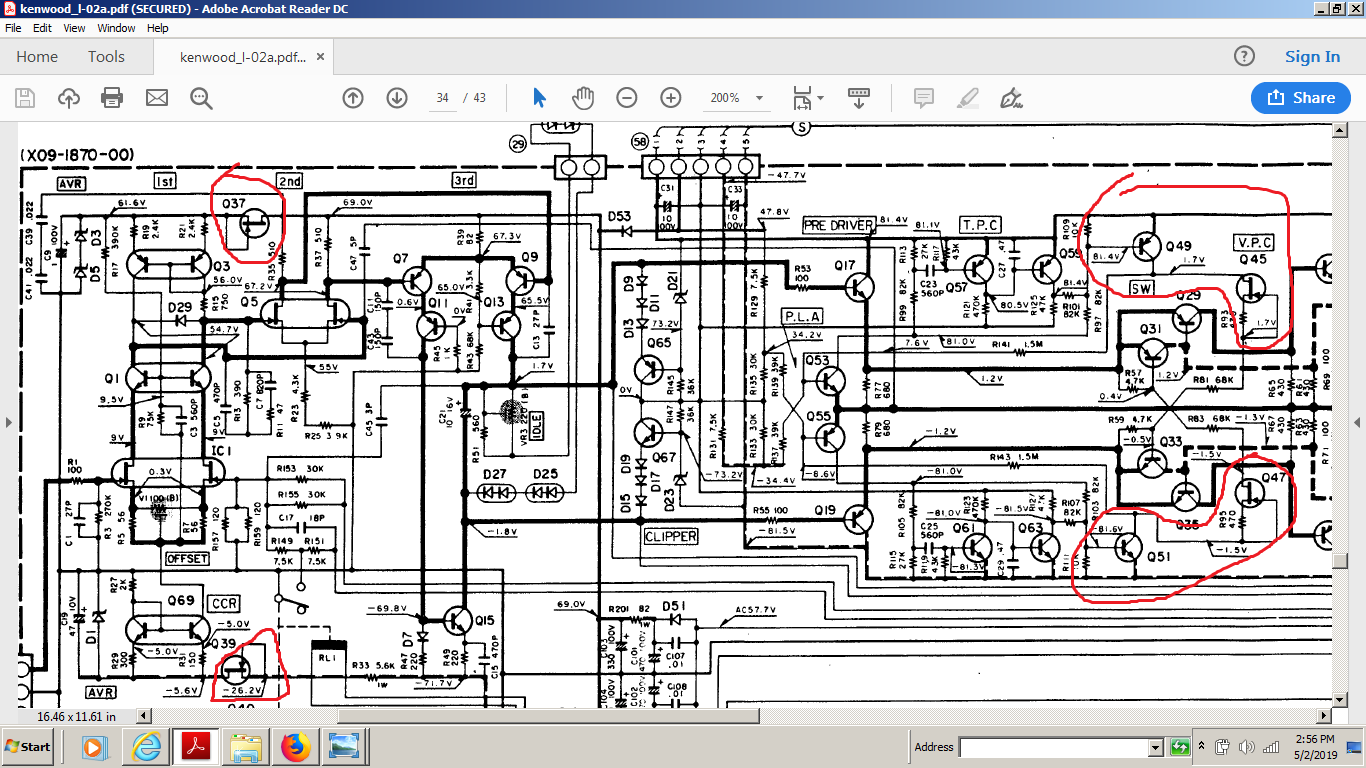

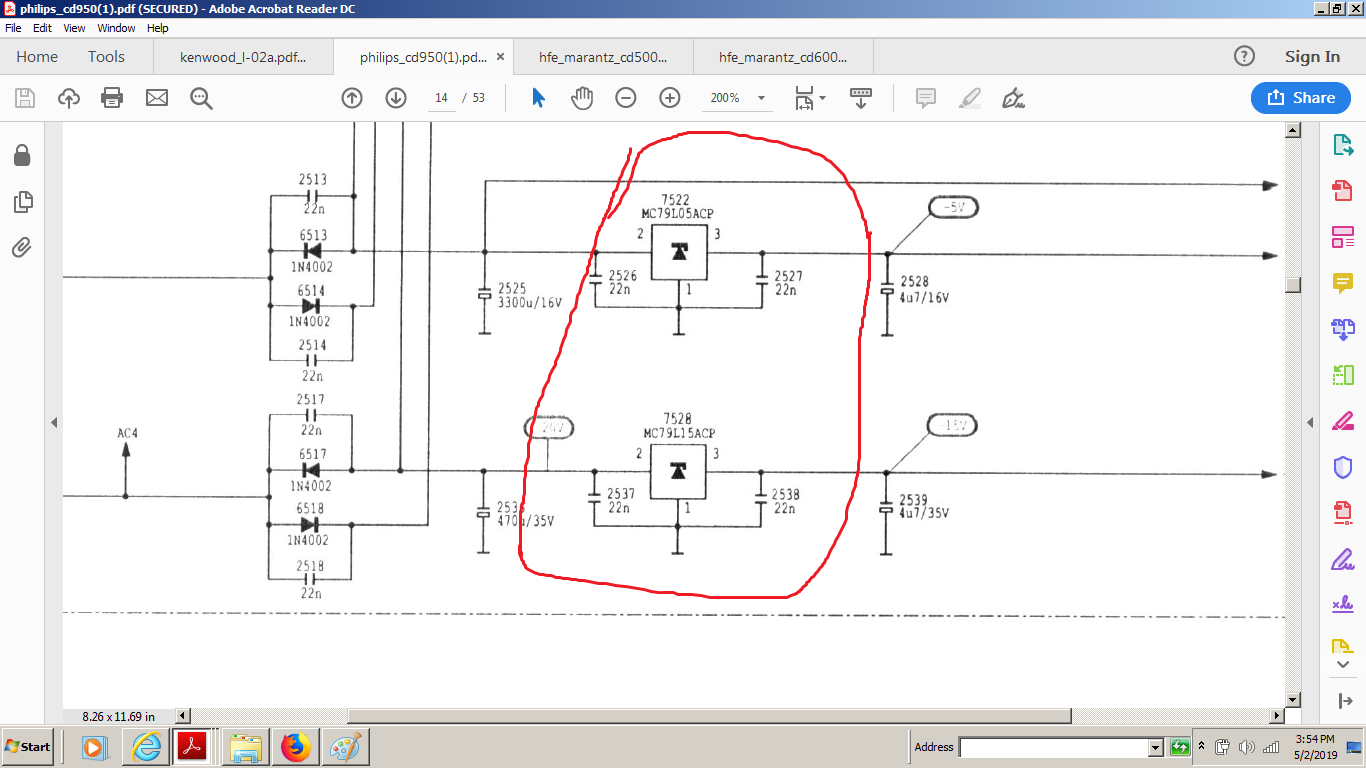

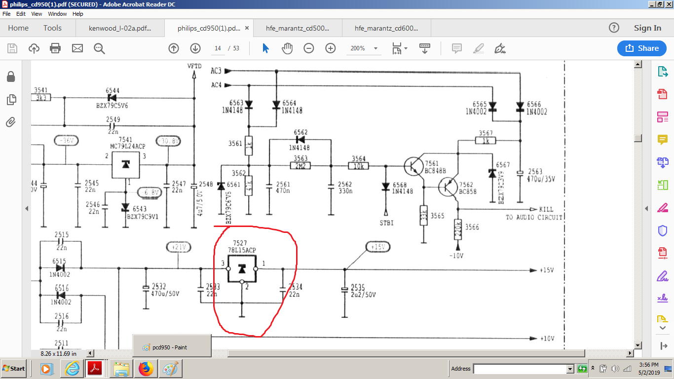

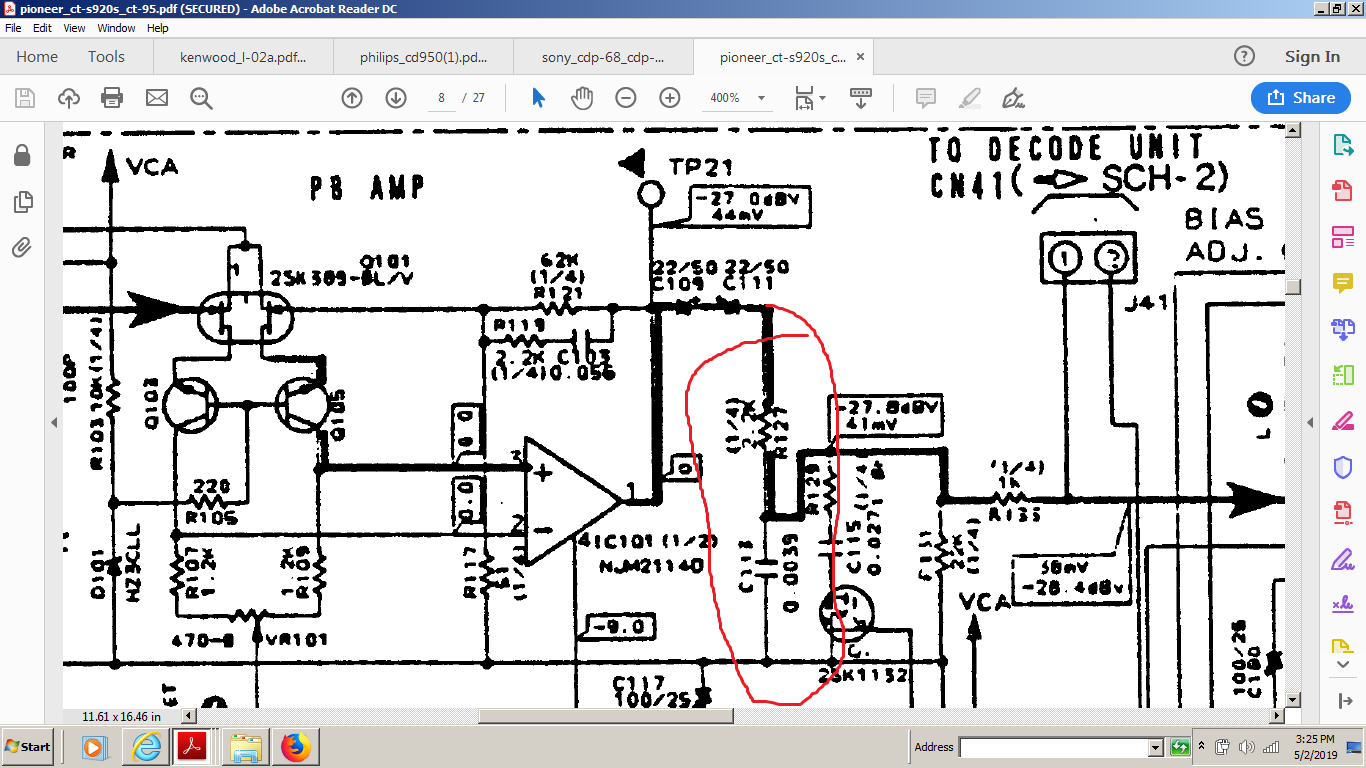

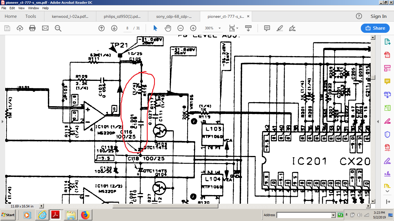

I simply find this rc circuit in pretty much everything i fix or buy form the 60's, 70's, 80's , 90's and 2000's...so I could simply assume that it must be good even if i wouldn't know any theoretical aspects.
Everybody, and I mean everybody used it most of their designs , being it high end, hi-fi or consumer products.
Now i'm happy that somebody produced such a simple and good explanation for that.

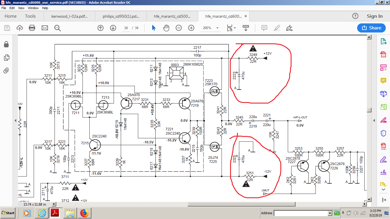

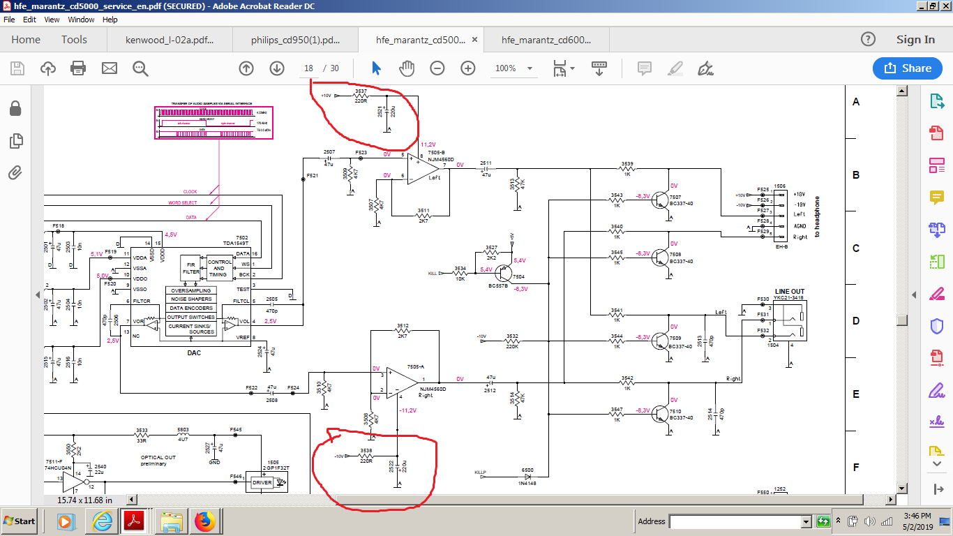

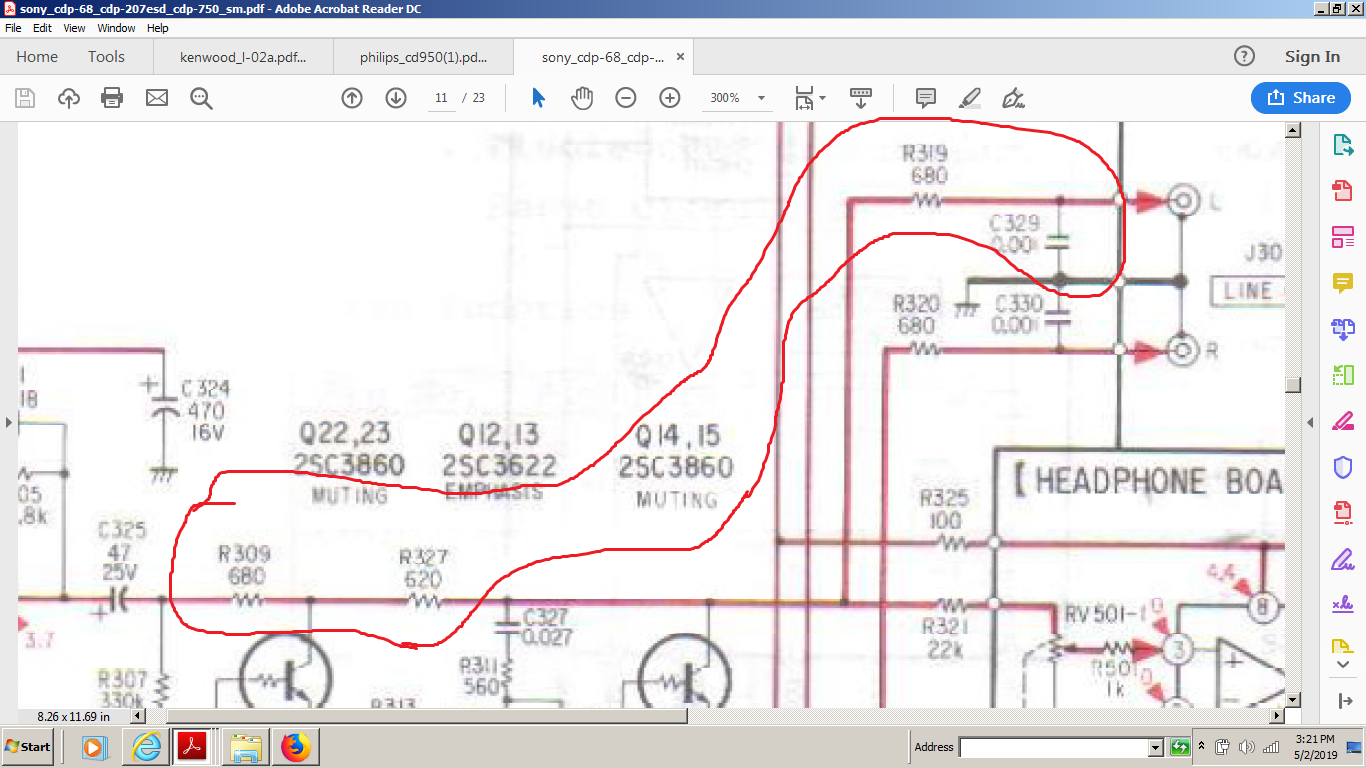

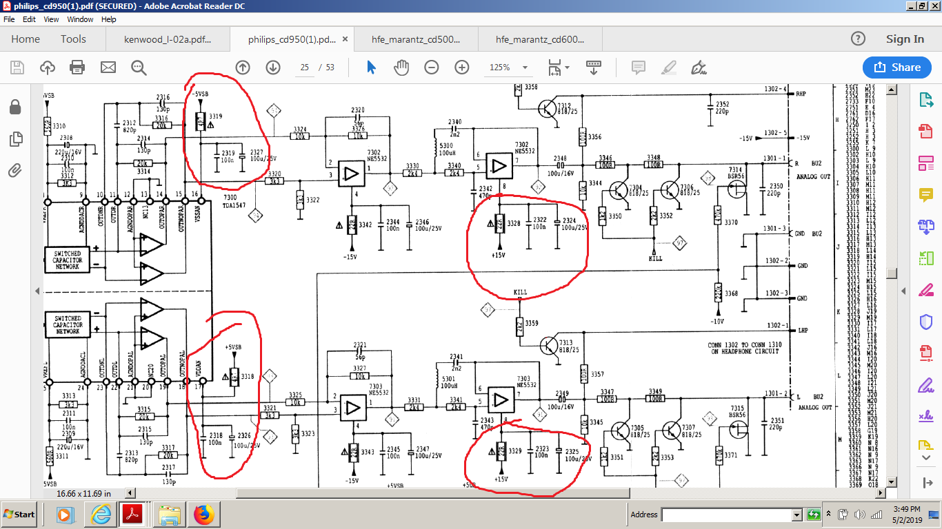

One more rc filter in action filtering a very low psrr circuit the HDAM2 in Marantz cd6000:
The same -6db /octave RC filter , just different values cut the signal bandwidth so that you won't have weird oscillations or intermodulation due to high freq content in almost all the hi-fi or consummer products of the last 50 years too...

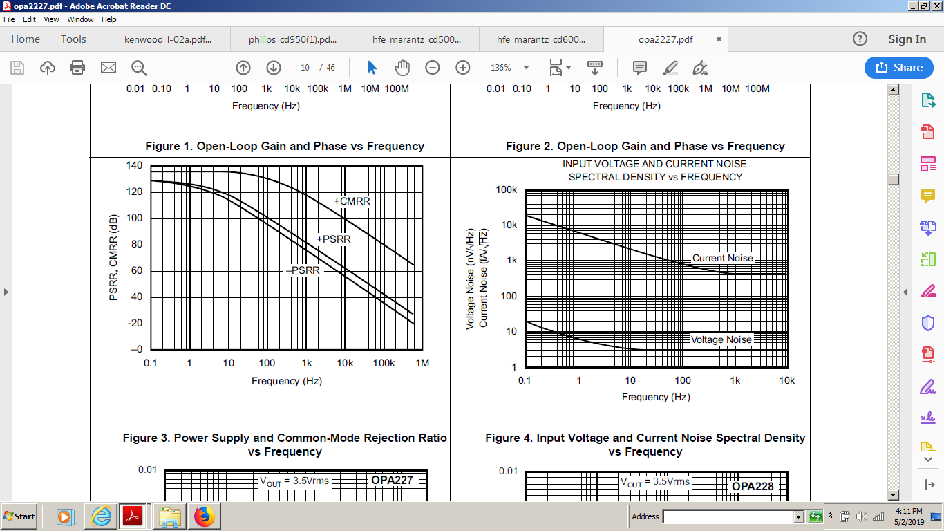

Indeed it's used heavily in sensitive instrumentation too for that reason.For current and voltage error and regulation circuits in SMPS using op-amps with low idle current and high precision op-amps 47/100nf...1uf film do wonders and it's often used with circuits like opa2227 which has huge psrr and cmrr only at at low freq completing the whole rejection spectrum this way. Of course you need special reference circuits for that kind of application if the noise is very high and you need much precision.
