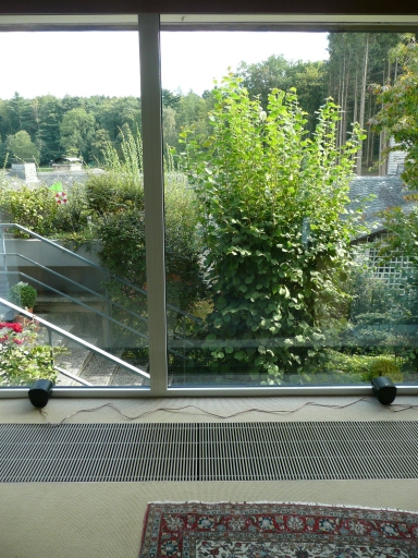

the glass wall?
attachment.php
anyway, these are hardly HiFi speakers
Frequency response and radiation pattern linearity are better than 8" Fostex FR drivers. Distortion will be higher, yes, but I did not listen at high levels. Anything else in the driver that would explain the lack of spatial precision?
against back wall and 1.5 m from side walls?
tu put is short: this is not a flooder in Beveridge placement, isn't it obvious?
Where did I claim this to be a Beveridge placement? My introduction told you that it is not. Is your "flooder" only valid in Beveridge placement?
this is a kind of flooder-like thing but with low-fi Cantons, apparently unsuitable for the purpose plus suboptimal positioning
Obviously you didn't tell us all the prerequisits for a "real" flooder. Tell me more, what has to be obeyed to build a "real" flooder?
furthermore:
just the carpet, isn't it too live?
Of course there is furniture, plants etc. in the room. Does the "flooder" need a special room treatment?
I can't explain - perhaps looks like o joke = sounds like a joke? but it is no rule, Elias' cardboard stereolit with pillow also looked like a joke
absolutely not
I referred to Beveridge placement because it's been discussed recently in this thread, to make it clear that Your negative test doesn't apply to it
ask el'Ol, tinitus an many others, recently JamesTRexx and Kjeldsen - all of them set up their experiments more-or-less according to my suggestions and found the results promising and worthy of further development
not to my knowledge, any typical room should be ok
can't explain Your results in any other way than bad luck, something wrong, I don't know what
certainly looks like a joke, perhaps herein lies an explanation - bad attitude?

Hi Rudolf,
Forget about the almighty flodder. There is no documented reference design just anecdotal appraisal from a single user.
It's basically just a speaker on the floor creating colored direct sound and strong reflections from the ceiling. You'll perceive a high level of ASW but that's where the list of favorable attributes ends.
P.S. Try toeing in the speakers on the photo a little bit and angle them so they directly shoot at the first reflection point on the ceiling.

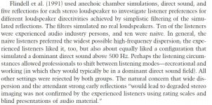

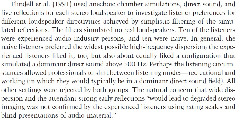

Flindell conclusions as quoted in Toole:
from those conclusions:
THE NATURAL CONCERN THAT WIDE DISPERSION AND THE ATTENDANT STRONG EARLY REFLECTIONS "WOULD LEAD TO DEGRADED STEREO IMAGING WAS NOT CONFIRMED BY THE EXPERIENCED LISTENERS USING RATING SCALES AND BLIND PRESENTATION OF AUDIO MATERIAL."
Of course something unnatural sound alien ! Why half of the industry professionals are not able to hear that ?
It must be that the half of the industry professionals have twisted priorities, unnatural ones.
yes, this must be the case, they simply have a kind of occupational disease

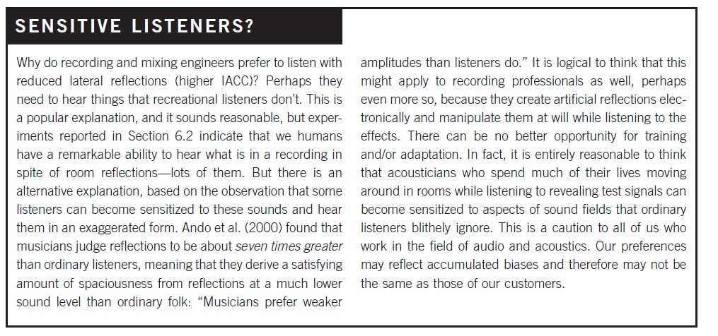

that this must be the case is also an opinion of Dr Toole:
SOME LISTENERS CAN BECOME SENSITIZED TO THESE SOUNDS AND HEAR THEM IN AN EXAGERRATED FORM

The way I would look at the results is that when asked to vote on which sound presentation they "preferred", there was a tendency to vote ...
(mine)
but this is not the point! the conclusion was not just about votes on preferences
it was about whether strong early relfections lead to perceivably degraded stereo imaging
again, in "7" font size, the biggest I can use, perhaps it will help:
THE NATURAL CONCERN THAT WIDE DISPERSION AND THE ATTENDANT STRONG EARLY REFLECTIONS "WOULD LEAD TO DEGRADED STEREO IMAGING WAS NOT CONFIRMED BY THE EXPERIENCED LISTENERS USING R A T I N G S C A L E S AND BLIND PRESENTATION OF AUDIO MATERIAL."
