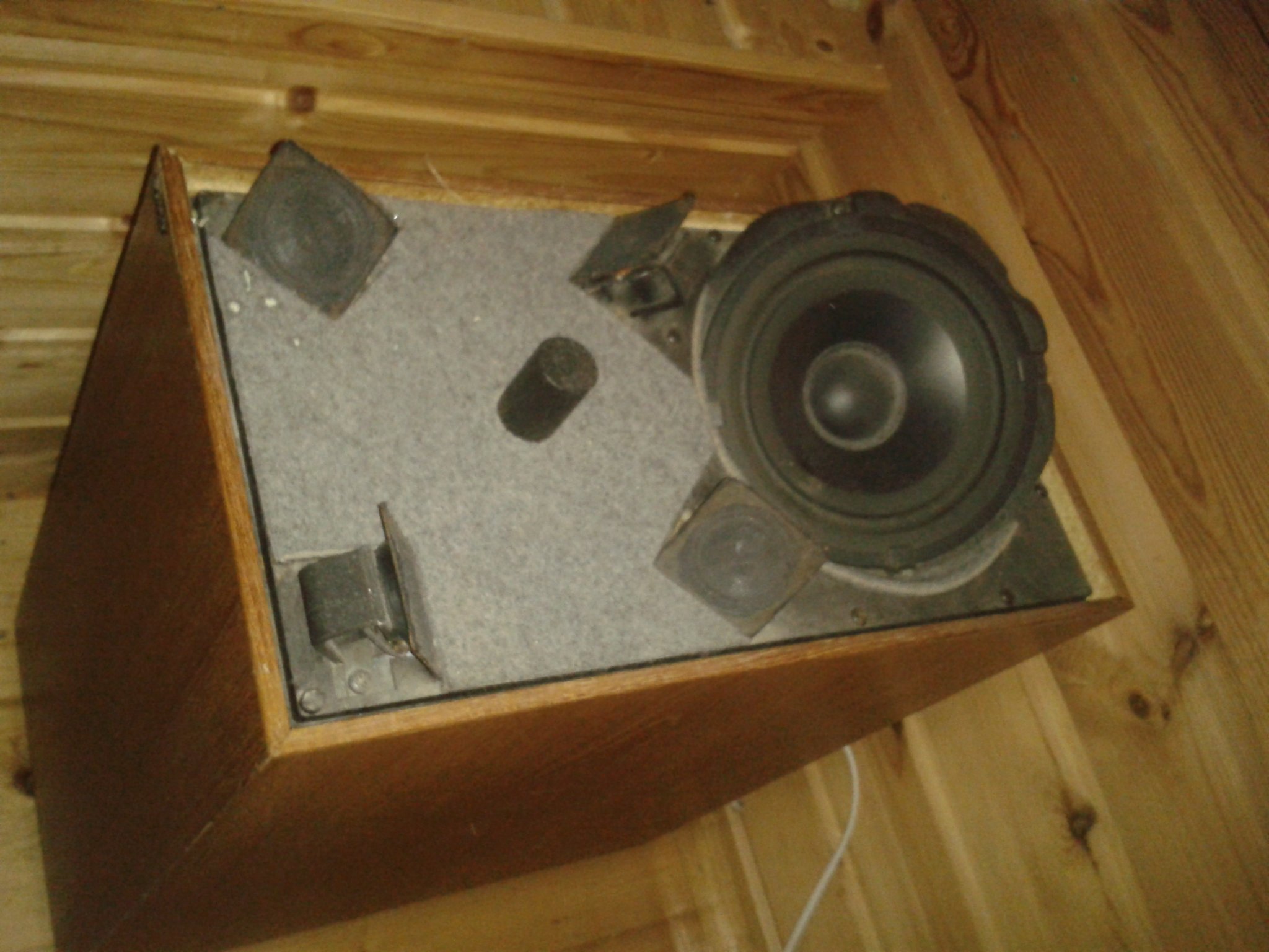

Sonab has four tweeters and a midwoofer. Speakers were as in the pic. Mic was about 1,5m from speaker at sitting ear height, in the middle of the room. AINOgradient mic was 2,5m from the speaker at similar height - room is bigger.
