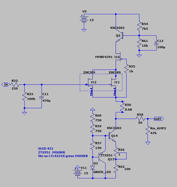

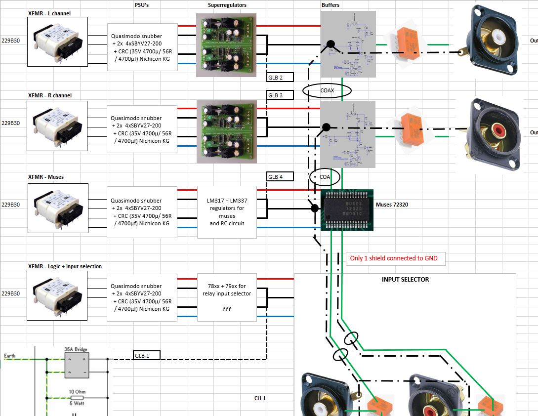

I've used GBR's in my main amps. But would not know were using them in buffers (circuit below).
I've tried as much as possible to create full mono preamps. However, the muses 72320 chip has only 1 ground. So I have to start from there again forwards with 2 GND traces or wires.

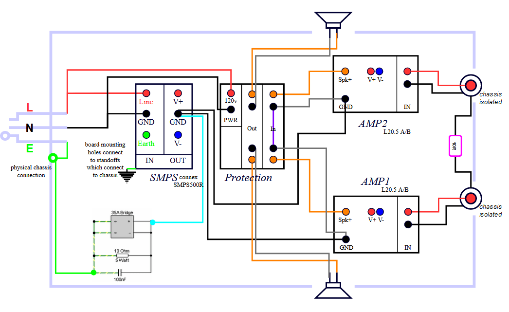

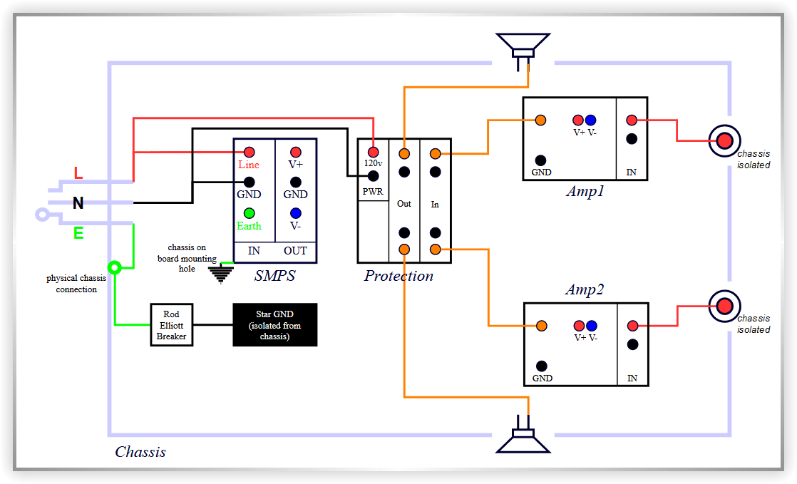

ok, after reviewing a number of threads, i have a general understanding of what my star grounding should look like
however, after seeing a number of different diagrams, there seems to be some slight conflict

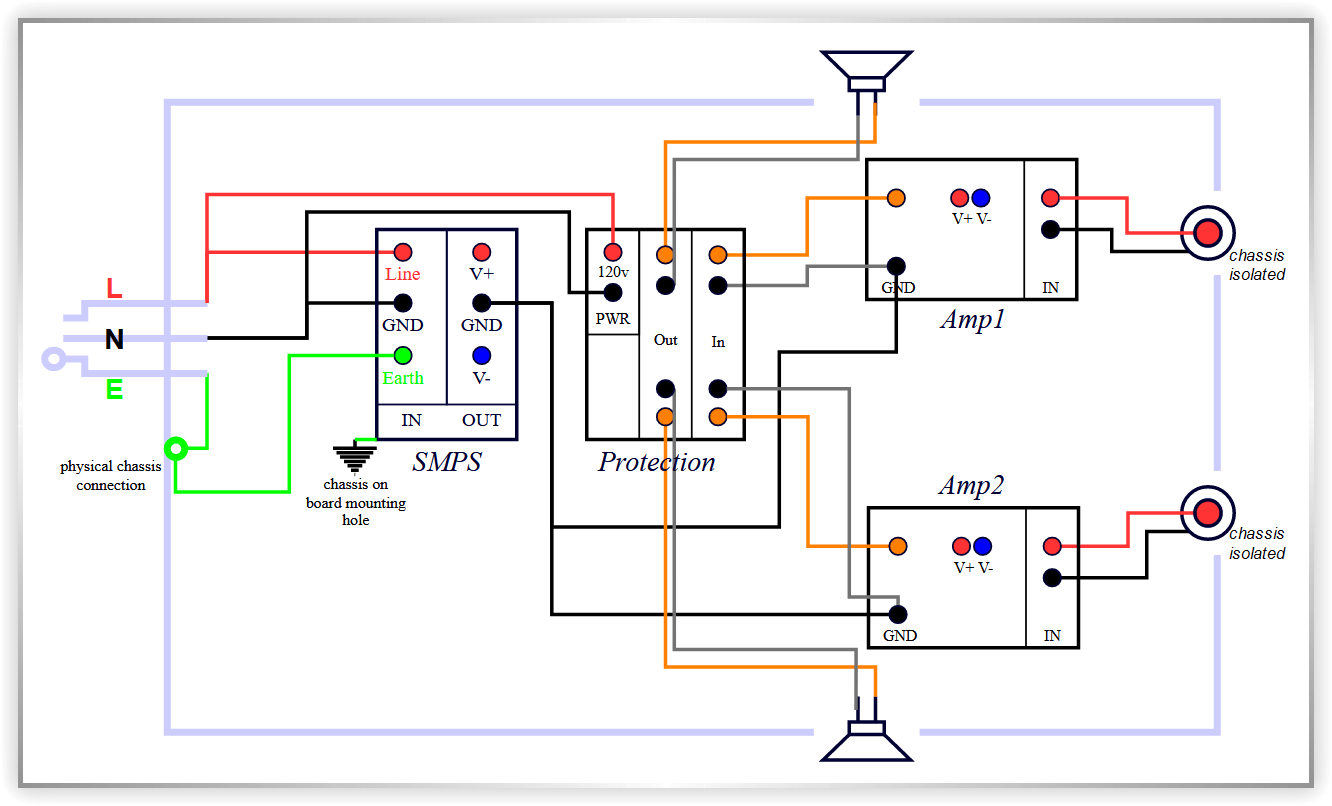

one of the later and final diagrams of this thread (ignoring the fact that they are dual mono) shows the RCA shield and Speaker Negatives, going BACK to the amp module before passing to the star ground
however, on this page we see a mostly similar, but the RCA shields and Speaker Negatives go right to the star ground, and not going back through the amp module GND
so which is it? also, seeing as many/most have a protection module, i figured we'd want to address that as well?
let's play 'fill in the proper grounding and earth lines for this setup'
wire up ONE amp only, WITHOUT the protection board, and tell us what you get.
pure dead silence, like ear millimeters away from the speaker, couldnt even tell it was on. i left the protection board in place so it was one less thing to mod, and with how quiet it was, it didnt even bother to take it out of the equation (which i've done in other tests)
waiting for the caps to discharge and going to test the other side
on another note, i shorted the shields on the RCA inputs (when both modules hooked up), and that made a very large difference compared to without, however audible noise at about the 8-12" to the speaker with that configuration. i will admit however that this was done with just alligators, perhaps actually soldering a proper wire would potentially yield better results
edit: testing the other side, basically the same dead silence, maybe a tiny grumble noise, but you practically have to have your ear touching the tweeter to pick it up
hooking both back up, with a better location on the alligators for the short of the rca jackets, and it's a bit better noise wise, maybe audible within 6-8". i'm wondering if just adding a 0v to earth/gnd with a breaker circuit will help? or perhaps a cap or resistor on the input?
short was added between RCAs (largest improvement thus far, hot pink line in diagram), wondering if the line in bright blue would be needed to finish knocking down the rest of the noise
several documents from member Bonsai website that are well worth reading:
https://hifisonix.com/ground-loops/
p.s. i trust your diagram is in error when showing amp2 gnd tee'd into amp1 gnd :unsure:

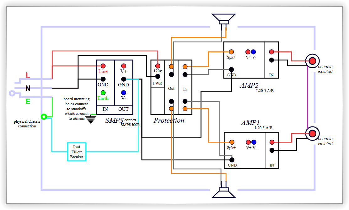

i updated the diagram to potentially reflect the GND on the amp1 and amp2 which meet at the GND output of the SMPS

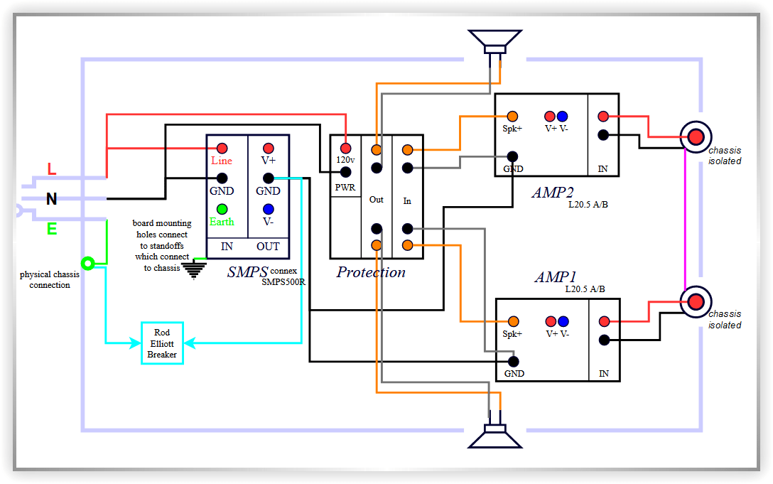

this is my next revision based on some feedback from others
1) adding a 10R resistor on the RCA bridge (pink)
2) adding in the elliott breaker circuit (light blue)
3) someone is proposing running a short on the GND on the protection board (purple)
thoughts on each of the 3 above?
