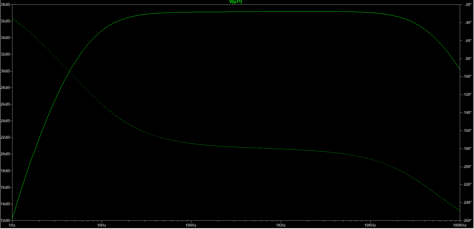

Finished drawing schematic in LTspice and done full simulation with a Laplace function voltage source simulating a MM cart as input. Here's a Bode plot of the output at TP11, just before the last series output resistor. That point is where negative feedback is taken for the active riaa eq. Does that makes sense? What worries me is that there's more than 180° phase shift and I learned that can lead to oscillation - But my knowledge is insufficient to know if this is good or bad in this specific case...

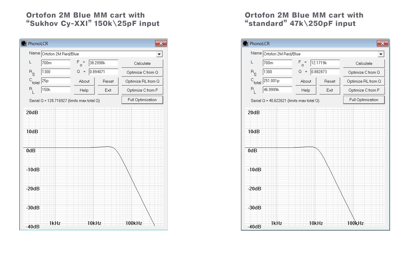

Thanks Nick for the graphs, seems like load capacitance is in an inverse relation to load resistance, so for MC one would need high-ish capacitance with respect to the low input R. Makes sense I guess that explains the high values on top-end preamps and hints that the 100p here is not optimal when in MC mode with 100R load.
For reference the series resistor R246 is a large 1K, the scans are really bad. But in MC mode that resistor is shunted by the 10R yes. However in my design I will drop the 1K and hard-wire the 10R resistor only. The freed DIP switch position will accomodate a 2nd load capacitor.

Nick Sukhov likes to use moving magnet cartridges with a non-standard load: far higher resistance and far lower capacitance than usual. A consequence is that the moving magnet amplifier has to be built into the turntable, otherwise the cable capacitance messes up everything. Moving coil (normal or high output) cartridges are much less sensitive to the load capacitance than moving magnet.
