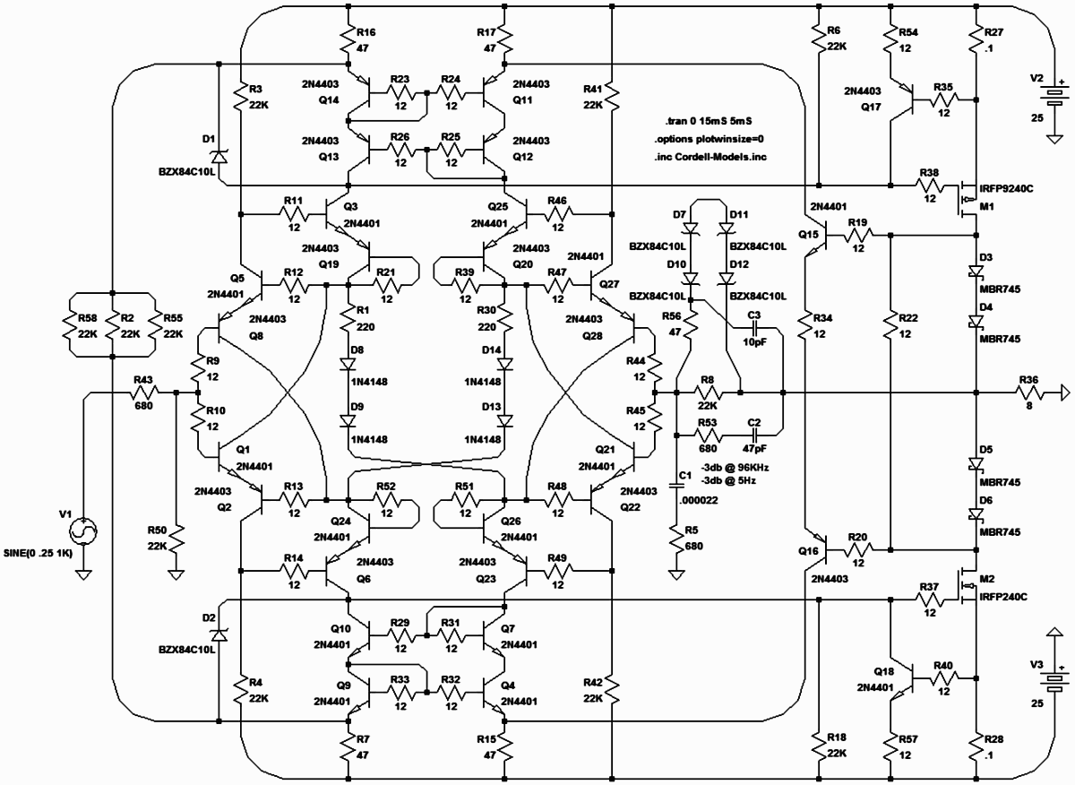

you can add my favourite complementary input stage to your consideration list:

You make some good points here. Every topology has its plusses and minuses. The full complementary has many nice features, but unfortunately it requires complementary JFET input pairs that are hard to find. As far as issues brought up about amount of current that can be produced or any effects of phase shift, these are things that can be readily evaluated by simulation, and my experience has been that the proper use of a unipolar input design can virtually always do as well as a full complementary design.
It is certainly true that if the JFET LTP is run at the same tail current and the same device is used for the N-channel device, all else remaining equal, the full complementary approach will often be quieter. However, I believe that any power amp that can do 5 nV/rt Hz or better in input-referred noise is fine. Others may disagree with this.

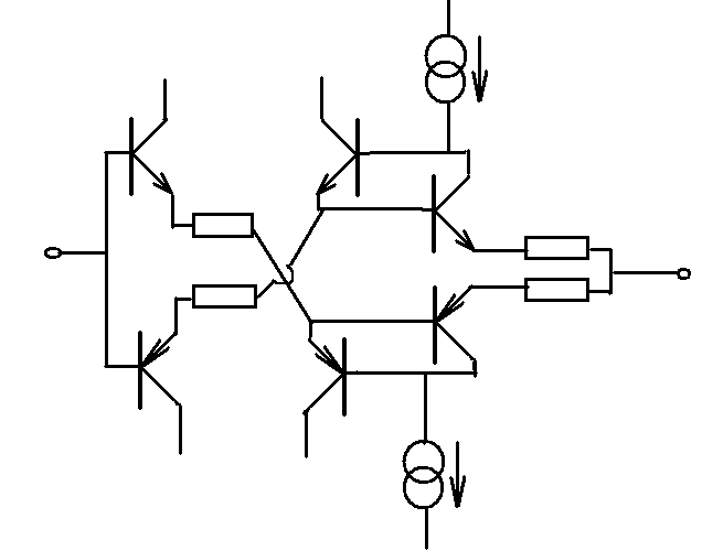

Was messing with near same idea, some time ago.
Don't got matching P depletion device? Fake it...
Once had a less cluttered minimalistic drawing, but
I've long since lost track of where I mighta stashed it.
Bout half these parts easily Muntz'd without seriously
degrading the performance.
Since both fake P and fake N contain both flavors of
emitter drop in series, they should naturally match.
This one relies upon VBE at near constant current,
and doesn't care too much about Beta. So matching
should be easy. Was my theory of the day anyways...
