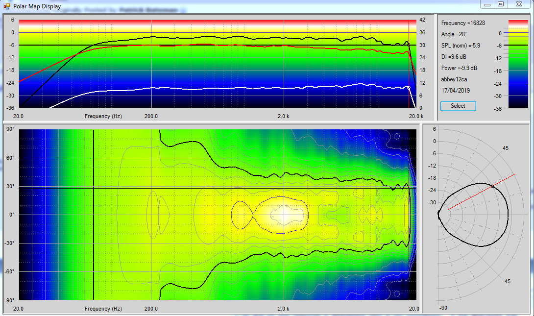

There seem to be various opinions about the exit of the drivers effect on the maximum frequency directivity is controlled by the wave guide. Certainly if the exit dictates this quite a lot of drivers have a small section of horn in front of their actual exit (quite often the same driver is offered with 1.4" and 2" exit).
I took this screen shot from Gedlees polar map software, it shows that this speaker (Abbey 12ca) which has a 1" exit driver has constant directivity to 17kHz whereupon the on and off axis response is diminishing (plot is not normalized). If the directivity was dictated only by the exit you would expect it to narrow beyond 13kHz.
One of the normal critiques of small exits is that the high pressures at the exit cause harmonic distortion. Is anyone aware of a paper where this is quantified? I.E. if you aim for a certain SPL at 1m with a certain coverage angle what exit size will you need.
