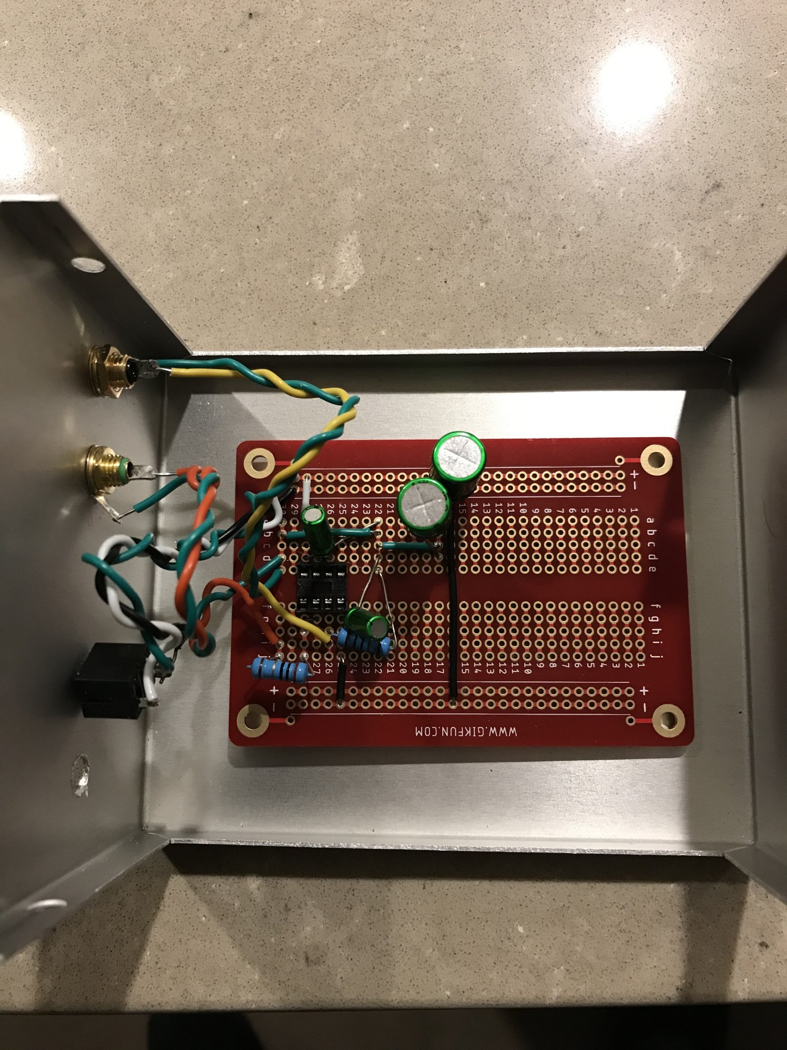

Also a pic of setup was requested earlier and I finally resoldered it.

For example in your picture you could try unsoldering the orange and yellow input leads and tagging those to the ground of the sockets. Having done that couple it all up (so now just the ground connection is connected via the leads) and see if the noise is still there.
Those sockets do not look isolated (insulated) from the chassis which may play a part.

@Mooly Yellow is input and orange is output( its 1 channel only). So you mean ground the yellow, plug the dac ouput into that jack( where it does normally go) and check for

The body of those jacks are grounded. Should I undo that?

OK, so unsolder yellow and tag it to the green ground wire. See if its silent like that.Yellow is input and orange is output( its 1 channel only).
If not then remove the sockets from the metal chassis and just have them free as a test.

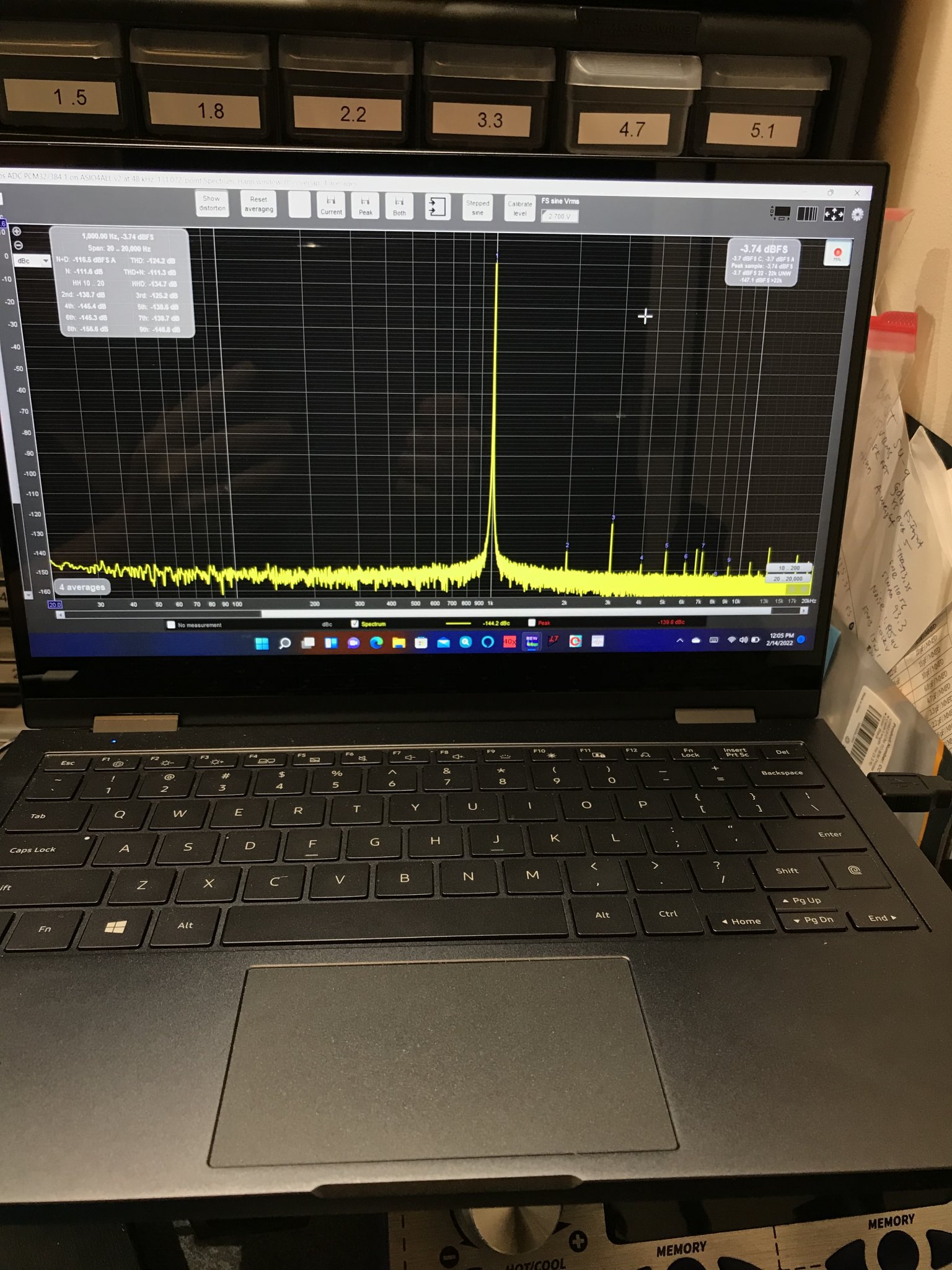

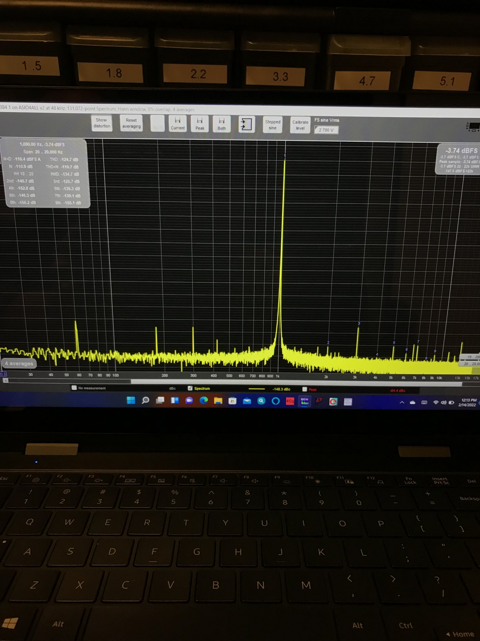

@Mooly shorted input but hard to tell ac harmonics from noise. However, taking the whole thing out of the aluminum chassis and thereby the signal grounds out of the chassis and picked up about .8 db in noise improvement.
First pic is direct connect rca into left and right channels of dac but signal only output on left channel into xlr into adc. Second pic is circuit no longer in the aluminum chassis. Still have thise few ac spikes but thd and thd+n are very close. Maybe I should put it in a cardboard box!

@Mooly interestingly the ac harmonics are predominately odd order. I also discovered that the output of the dac, not connected to my buffer, has a dc offset that has a full wave time of 16 seconds and goes up and down at a very regular rate from .6mv to 1.4mv. Any ideas what that is? It is reflected in the buffer output.
