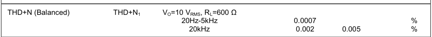

If you could publish all the same specs into a 600R load, it would be very useful information for many of the use cases of this board.
Some may argue that any source gear competent enough to drive the 50K load of this buffer, would already be competent enough to drive the 100k load this board is subjected to in your testing. Putting into question the benefits of adding the extra circuitry into the signal path.
Yes, this. My situation is power amps with 5k input impedance. Would be interesting to see some measurements for both some gain and a tougher load than 100k.
Yes the 2v output and 100K input measured results are great for getting a bunch of oooh's and ahhhh's from the numbers guys. But certainly doesn't reflect a real world application. I'd like to see 600R with 10V output.
Kinda like saying your car can do 200mph. But only when doing a burnout on an ice patch.
10v and 600R is a pretty standard test condition. If we look at the That 1646 for example, that's what they use in the data sheet:
http://www.thatcorp.com/datashts/THAT_1606-1646_Datasheet.pdf
No? Common input impedances for amps tend to sit around 47-48 kΩ. As you pointed out earlier, the difference between that and 100 kΩ is largely academic.

It was just a simple request to see what this board can do under industry standard test conditions. Not sure how that is "throwing it under the bus"??
Not sure why anyone would need this buffer to drive 2v into a 100k load. What source gear that can drive the 50k input impedance of this board can't do that already? I'm a bit confused.
It appears many people have plans to use this buffer in front of the Purifi amp kit. Which means it will need to drive 10v into a 2200R load. 600R is a standard input impedance test level, and likely a preset already in your analyzer. Which is why I picked it.
OK. So five requests for testing with 600 Ω load. Got it!
Please see Post #116 where I've committed to taking that measurement. I'll add 2 kΩ load as well. Do we need to argue further or will you allow me time to perform the testing?

Just inquiring on why those test conditions where chosen to showoff what this board can do. That's all.
If you could provide an example of a typical use cause where this board would be used under those conditions, and why this buffer would be beneficial in this particular application, it would clarify things a bit more for me.
Light load will always show the best performance, so I chose that operating point to start. As you can see in Post #116 and #118, I am adding other data points.
There is only one of me and only 24 hours in my day. I have other competing priorities as well. Making five requests and demanding justification for anything you happen to read between the lines will only distract me from taking the measurements. If your goal is to have those measurements provided, I hope that you are able to see that you are working against yourself here. Unless you're trolling, or have a competing product to sell. In those cases, it would obviously be in your best interest to keep me distracted.
A typical use case would be a preamp with differential output: Source -> Volume Pot -> Universal Buffer. In that case, the Buffer is likely to see a 48 kΩ differential load.

You can just say that the real reason for those test conditions is because you wanted the sensationalized headlines ( Universal Buffer achieving -140 dBc (0.00001 %) THD) and that most potential buyers would never question the measured results anyways. That honest answer would have worked. Considering there was 108 posts before mine and nobody else questioned this, your strategy had some merit.
