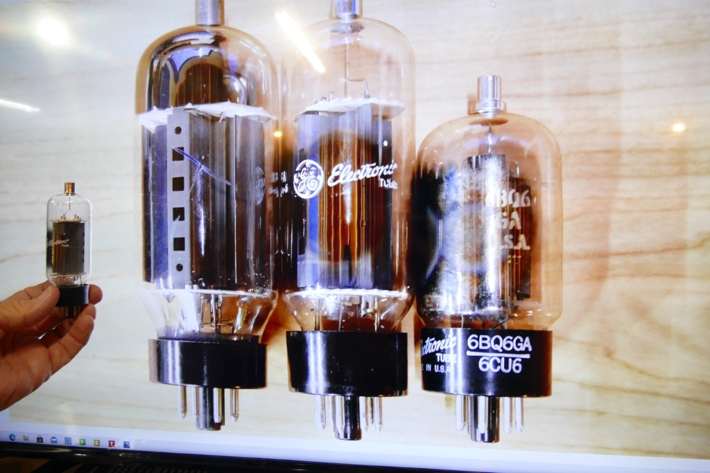

Objects May Appear Bigger on a 25" OMM (Old Man Monitor).
PLUS, the 6BQ6GA I happened to have had on my desk is the SKINNY bottle version, so it's even wimpier looking than your Fat Bottle.
Even though we are the same age, my old man eyes needed a 32 inch screen for PC board layout 10 years ago, and that went to my current 43 inch size when Sams club ran a 43 inch Hisense 4K TV on Black Friday for $229 about 4 years ago. Now I need the big screen AND glasses.
Objects do appear really big.....even when you don't want them to.

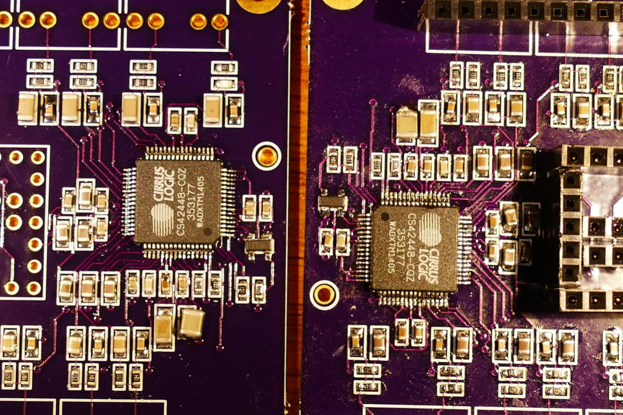

There are two ways to do SMD assembly. The "safe" way involves soldering each part one at a time with tweezers and a soldering iron. Bumping a part or two won't move anything since each part is soldered before going to the next one.
The "fast" way was what I called the frying pan method at Motorola because that's what I actually used the first time I did it. Each part is sitting in a sticky goo until the entire board is "reflowed." It is possible to make a total mess requiring a complete do-over with a misplaced tweezer strike.
You put solder paste on each SMD pad, either with a tiny syringe, or a solder stencil made by the board house and a squeegee. They you place each part in the paste with tweezers, place the board in the frying pan, and place the frying pan on a hot plate turned up to about 280C. Once the solder has reflowed, move the frying pan to a large heat sink. Heating up a Teflon pan may not be so good for the person doing it, so the pan was replaced with a piece of 0.100'' aluminum held with a pair of Vise Grips.
The fast way makes for a better looking board. The board on the left was done "fast." The board on the right was done "safe."
