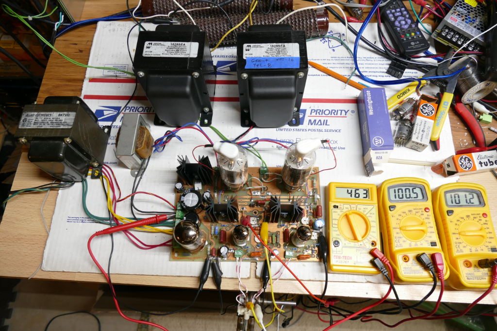

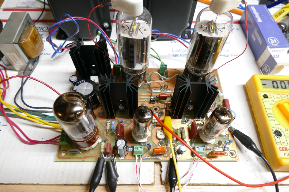

I got the version 2 prototype back on the bench today for some testing. I connected it to an Allied 6K7VG power transformer, which according to the specs printed right on it is too small for the job.
It is the brother (I bought 10 or 12 to make guitar amps back in 2004) of the transformer in my SSE which is still running after 17 years of my abuse which involves sucking 220 mA out of a 150 mA rated transformer. Yeah, it gets too hot to touch, and starts to smell funny after 8 hours of this abuse, but it doesn't fry. If it does, I still have 3 more still in their boxes from 2004.

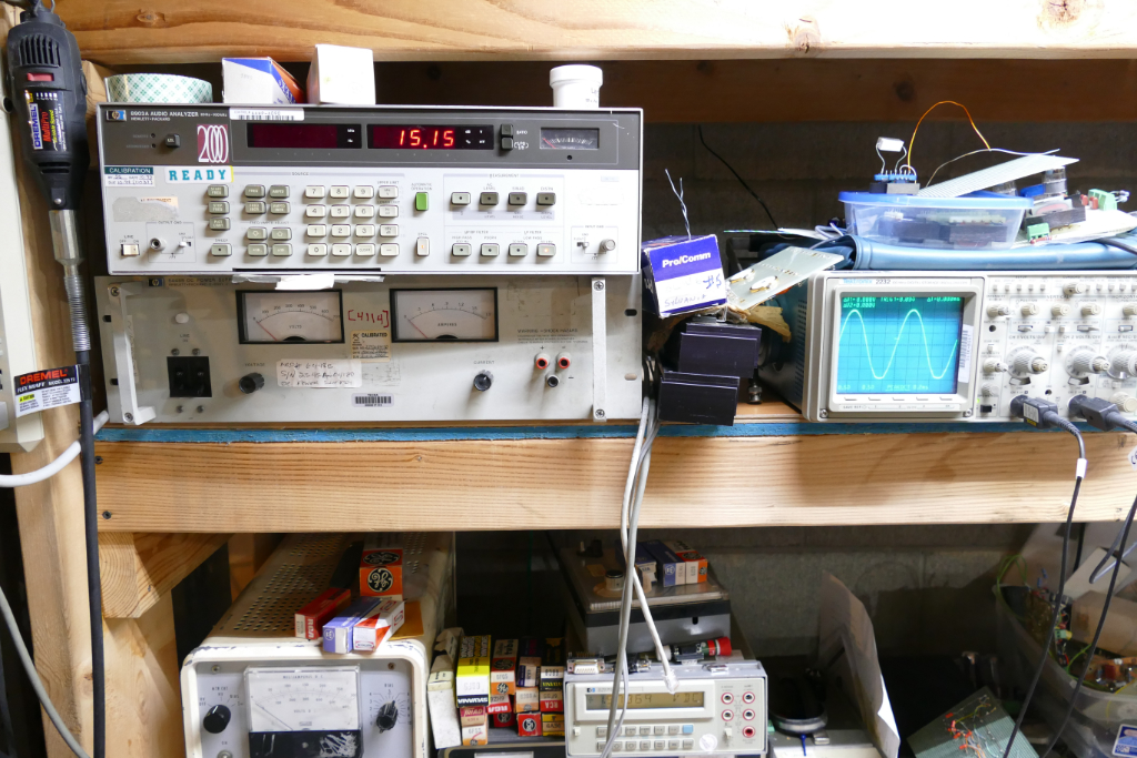

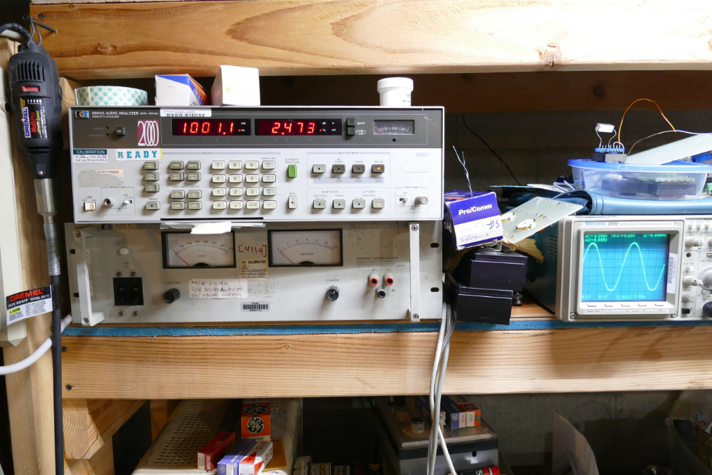

So with $22 worth of tubes the amp makes 15 WPC at the edge of clipping into a 5K ohm OPT with 100 mA of idle current per channel and 463 volts of B+. The THD at this point is 2.47% at 15.15 watts.
Rewiring the OPT for a 2.5K ohm load, and cranking the current up to 130 mA per tube gets me 22 watts at 2.1%THD, but things get too hot at this level.

I got the version 2 prototype back on the bench today for some testing. <snip>
Excellent news and great performance you are extracting from those “cheap” tubes.
