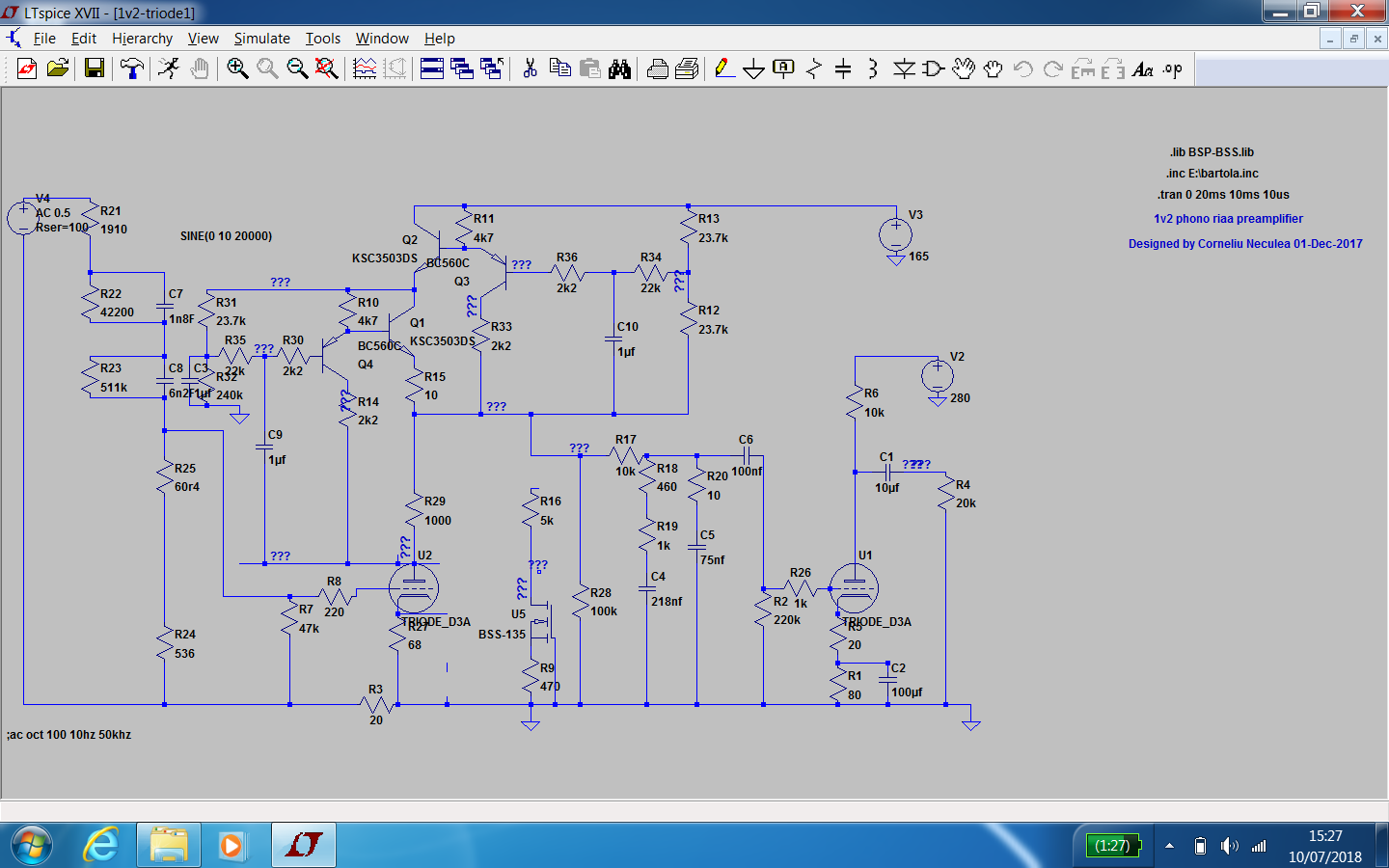

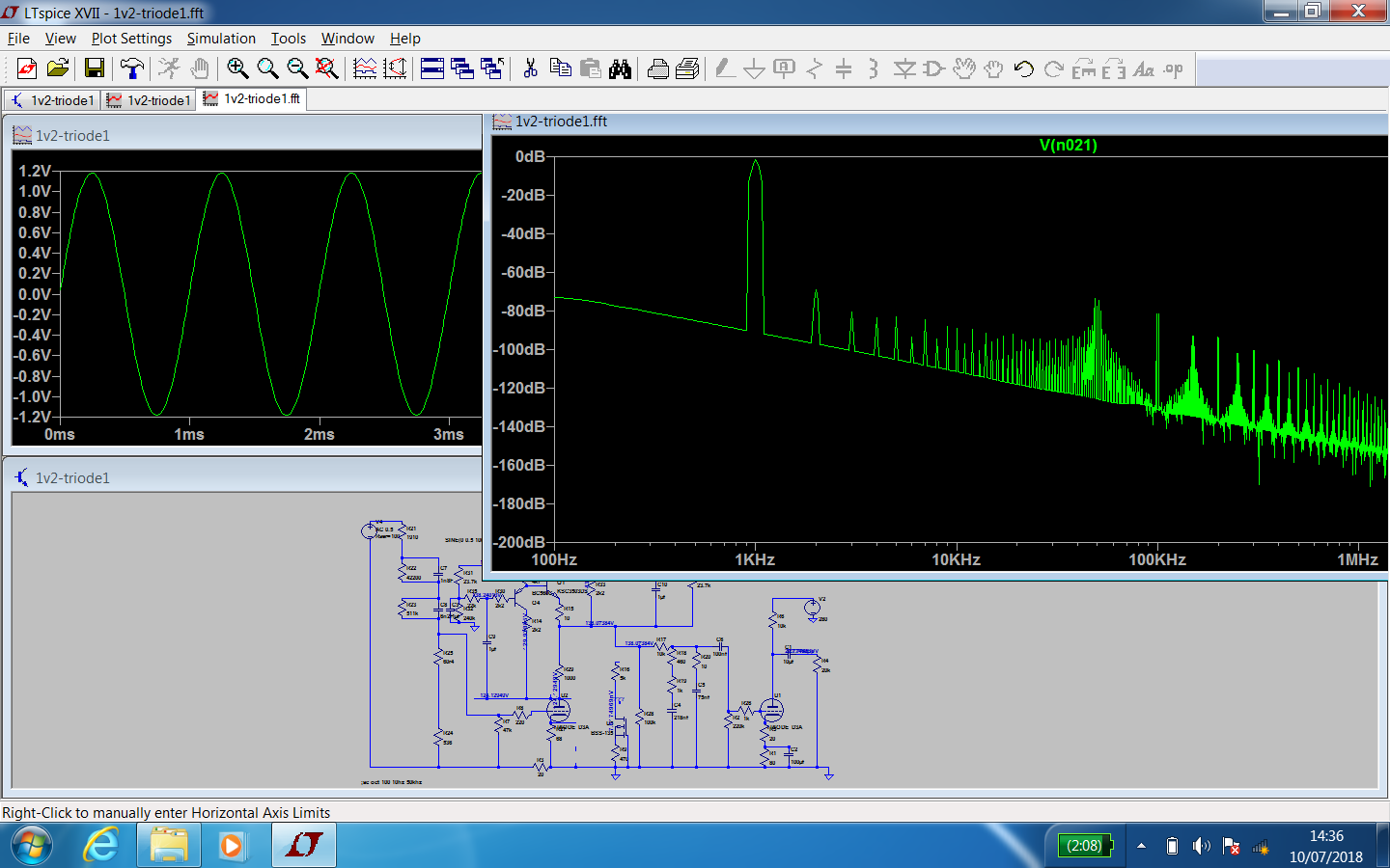

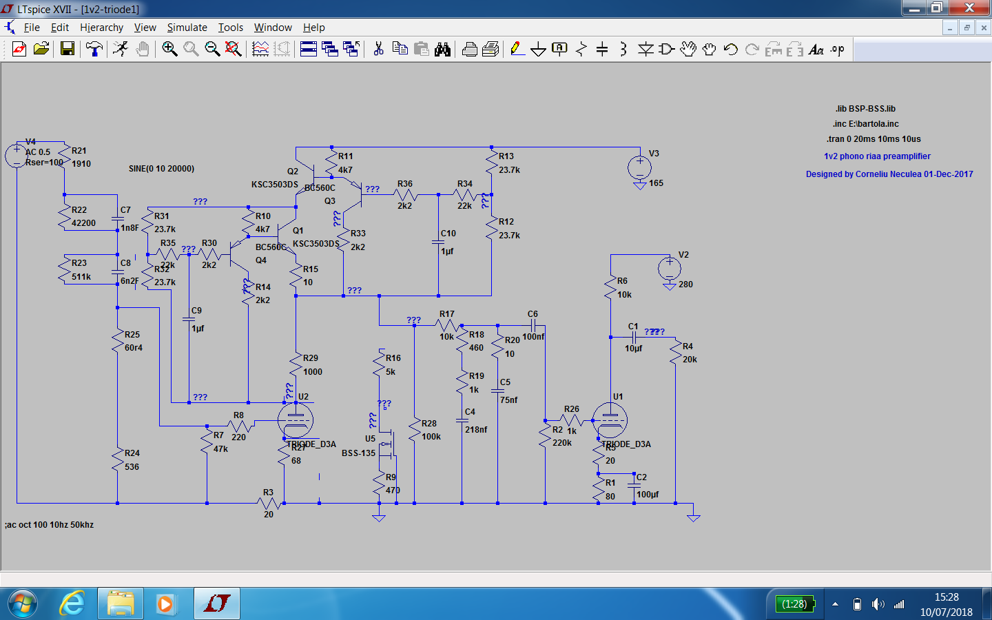

last schematic of the input configuration:
http://i62.tinypic.com/33xwsaa.jpg
I don't remember exactly the riaa componenents.

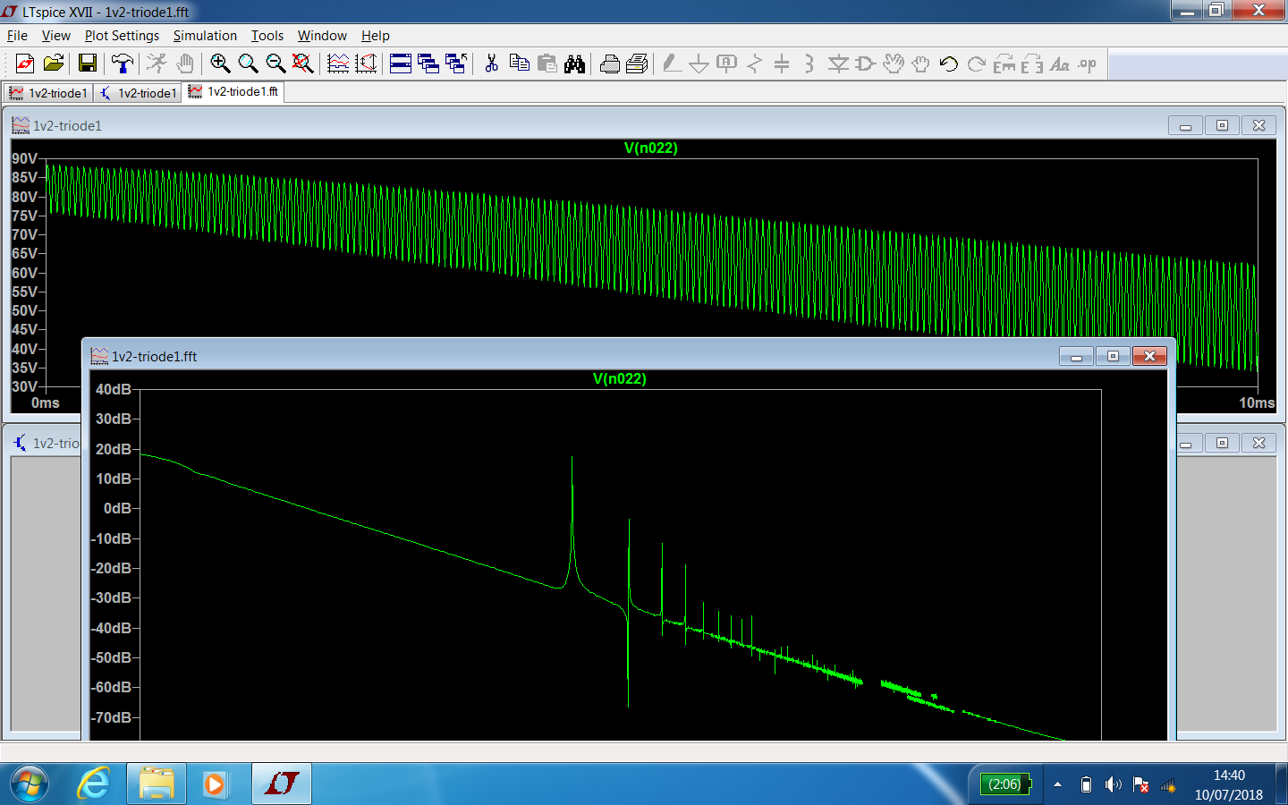

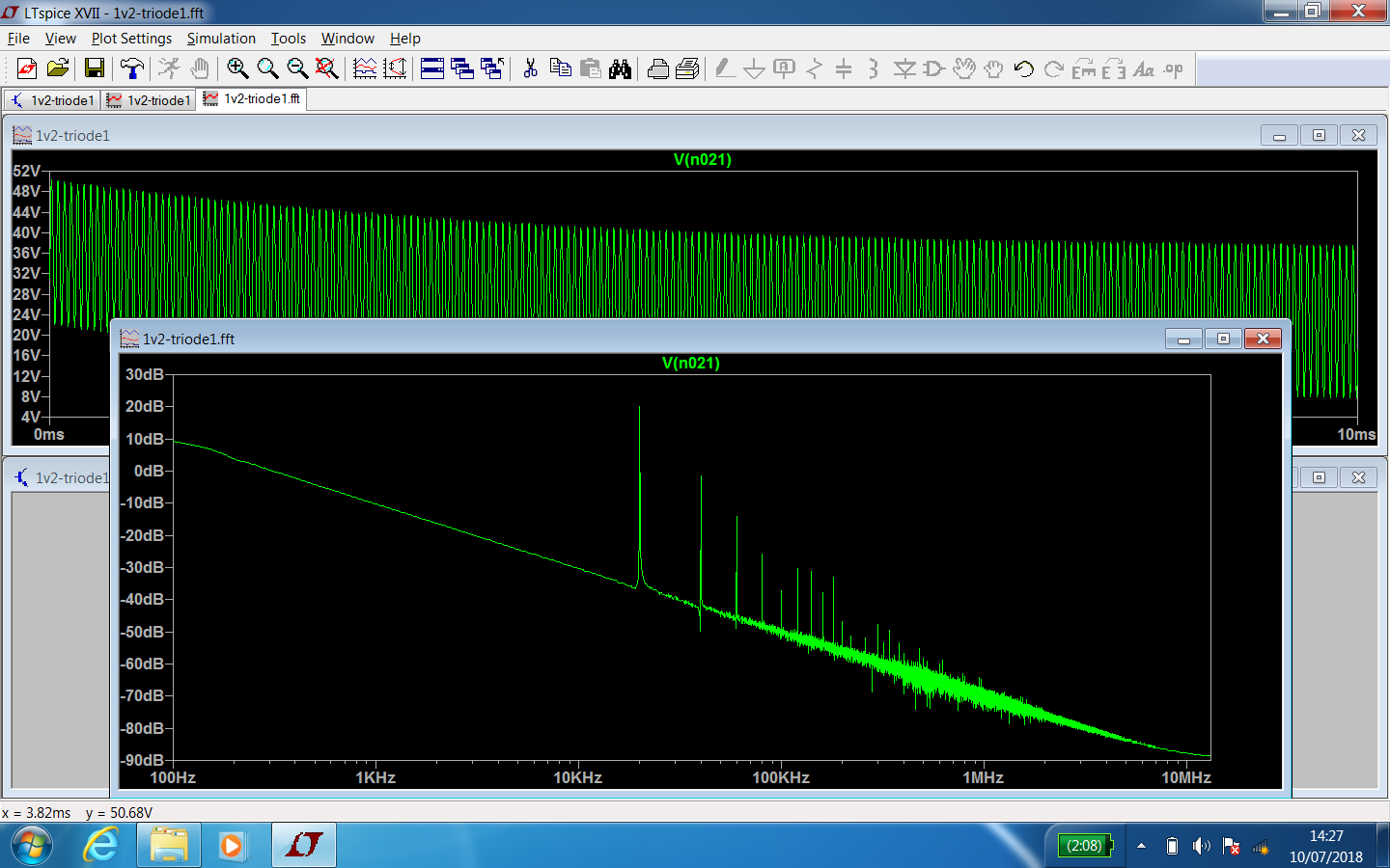

first measurement when I got the scope:
20khz
last output measurements with anti-riaa(Patrick Turner) and riaa filter involved-there is some nonlinear transfer characteristic for the low frequencies but i don't know exactly if the anti-riaa ,riaa or both filters are guilty.The measured output signal is the upper one on the scope and last on paper.The lower signal on scope is at the input of anti-riaa filter.
http://i61.tinypic.com/e7ylpz.jpg
http://i60.tinypic.com/s5a2kp.jpg
http://i61.tinypic.com/27x08rn.jpg
http://i61.tinypic.com/2m43880.jpg
http://i57.tinypic.com/zivx94.jpg
http://i57.tinypic.com/1zlu1k7.jpg
http://i59.tinypic.com/167o9yc.jpg

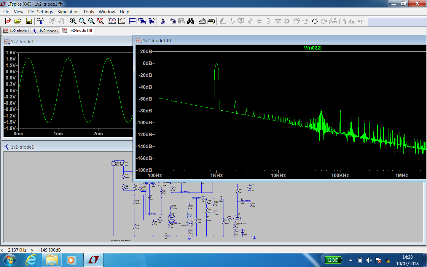

last measurements right after the first stage and the riaa filter:
http://i61.tinypic.com/2dufj12.jpg
http://i59.tinypic.com/1687uz7.jpg
http://i58.tinypic.com/k3kns3.jpg
http://i57.tinypic.com/es4utd.jpg
http://i57.tinypic.com/8yyohc.jpg
http://i58.tinypic.com/j8zb6o.jpg

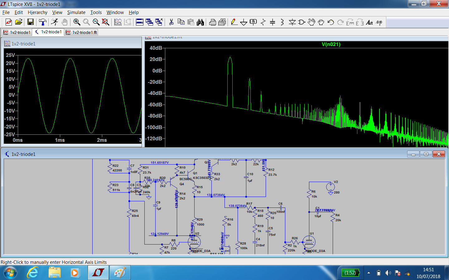

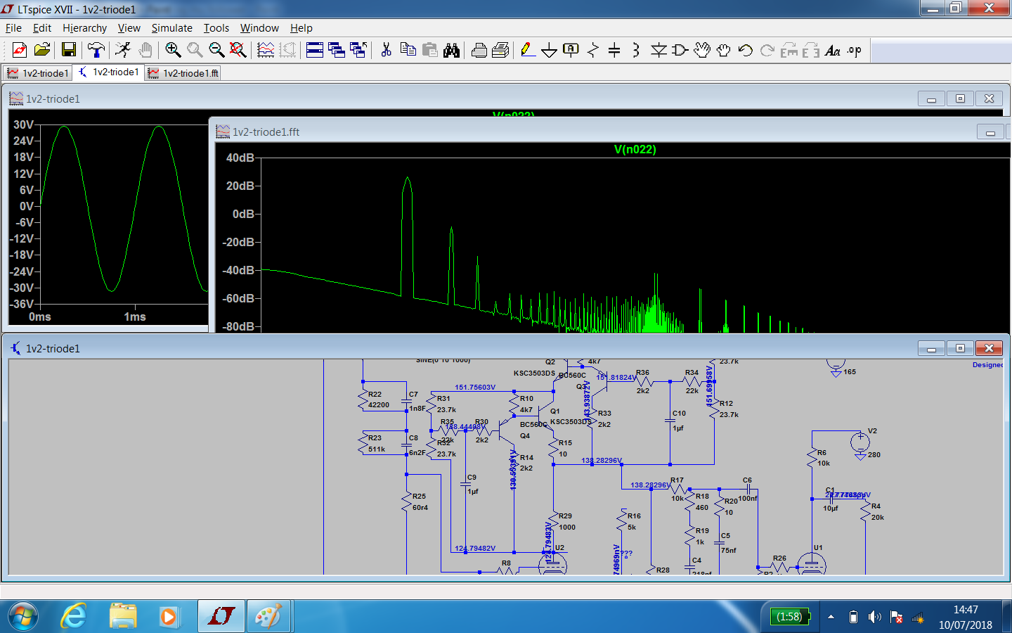

I tried a new riaa passive network with lower impedance , than I made a new circuit that could change between the high impedance and low impedance riaa network.This are the schematics of the two filters:
These are the new lower z filters:
http://i60.tinypic.com/317f9n8.jpg
Image - TinyPic - Free Image Hosting, Photo Sharing & Video Hosting
http://i62.tinypic.com/oj1hk1.jpg
These are the scope pics with the measurements with lower z filter on one channel and the higher z filter on the other.I suppose it doesn't matters who is who and which is which, but on the paper in each picture "SUS" means upper side on scope(lower z network) and "JOS" means down side of scope where higher z is measured:
http://i58.tinypic.com/2iw8v0h.jpg
http://i57.tinypic.com/15eiiy0.jpg
http://i57.tinypic.com/10z79qu.jpg
http://i59.tinypic.com/2a0i9mo.jpg
http://i57.tinypic.com/wmjapt.jpg
http://i58.tinypic.com/123y1xi.jpg
http://i59.tinypic.com/1z3p5y1.jpg
Again the low frequency attenuation is here because my generator can't make a fair enough deal with the anti-riaa network but I can assure you that there's enough bass , ever more than I am used to.

But...the sound is slightly different in each case .With lower z fillters is less vibrant, more flat like response and i feel I listen to a good transistor preamplifier period.I made this try to know if I could rely on trying lower z rlc filter and I think I can.

I felt that i needed to address the noise problem as my first attempt in 2014 had no issue with that , being helped by ultra low noise bipolars. To my shame in 2014 i didn't know how to use a simulator and i lost a lot of time for the first design when now it took me just two days to do the work i did in months of trial and error before...
So i wanted to give that monster a second chance by simulating it for better specs if possible.I used some other transistor pairs in the sim , but bd139, mje340,bf459 instead of ksc3503 and 2sa1038, 2sca992 instead of bc550c might be some other good choices too.My original design used mje340 and 2sa1038 ...I'll probably go with bf459 and 2sa1038 or ksa992 now...
You have here some sims with two slightly different mu-follower ideas:
In the floating mu version i have 300mv more output at 0.5mv 1khz, but most probably i'll be having some issues with different operating points as high transconductance valves go wild sometimes, if they are not given some constraints and i've seen it a lot with d3a, but everything is capacitor coupled so no real worries.
The distortion pattern is raised by 15...20 db by the second stage actually .I consider using an op-amp for the second stage to make this a cristal clear sound, but a valve has it's benefits when clicks and pops come in .
Most probably i'll be giving a new trial to a proper pcb for this version .I,m not good with pcb design ...so it might look like mess as usually does, but as long as it works well, i don't care of the commercial finish.It's for my own use and i am really glad that nobody believe me when i say that this design is one of the best possible in the whole phono world.
Don't copy it, just go ahead with the usual "no sand" crap !
I totally dumped allan's kimmel mu-follower idea as loading more the bjt has no beneffit.I just load it with a high value 100kohm resistor that simply helps at start-up.I simply used the 1v2 previous sim as a base for the older design.As you can see, i didn't even change the design name...
