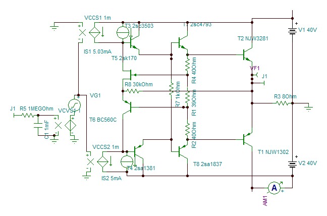

Yes, but what I don't like with such a solution is the lack of symmetry.It looks like bias setting pot for Elvee's silicone version works OK in this location.
OK, it is a bit of maniac obsession, but I prefer nice, balanced circuit, even if they aren't really required

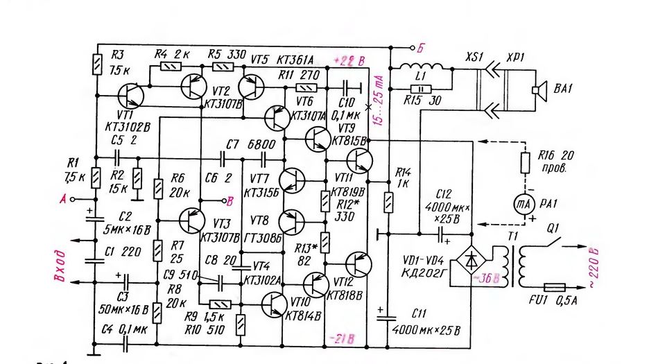

https://www.diyaudio.com/forums/att...3d1594929669-unusual-amp-1987-a-captureap-jpgI remember I built this in the early 90's ... I was a student and I didn't have money - so it was never finished (no enclosure etc) , but it sounded good, as far as I remember![]()
This amp uses Single Floating Supply, a decade before Onkyo, three decades before my presumed invention. The input error stage VT1,VT2, can be replaced by Rush cascode advantageously. It uses current bias, but what controls the crossover? I will simulate to find out. It might be possible to make it non-switching.

The crossover is controlled by a deep GNFB. Partially VT7, VT8 - voltage controlled current shunt.

Single supply has been used before, by Quad most notably, and IIRC in RCA application sheets amongst others.This amp uses Single Floating Supply, a decade before Onkyo, three decades before my presumed invention.
Since the only advantage is the absence of a CT on the transformer, it is now disregarded (Quad used a low-power supply balancer to keep a control on the synthetic ground, which added some components to the BOM).
It is possible to use the amplifier itself as a supply splitter/balancer, but there is no need to resort to such acrobatics when a CT is almost free
It is probably possible to operate the circuit in a non-switching mode: I have used a similar topology to that end.The crossover is controlled by a deep GNFB. Partially VT7, VT8 - voltage controlled current shunt.
The Single Floating Supply is not a usual single supply described by Elvee, It is used in most prestigious models of Onken. This type of floating supply enters in the feedback loop of the amplifier which decreases dramatically the impedance of the power supply, producing much more powerful bass compared to split type, and without armada of reservoir capacitors . The dark side, it requires individual isolated one for each channel. On the other hand it doesn't need speaker protection.I'm assuming it would work equally well with traditional rails, right?

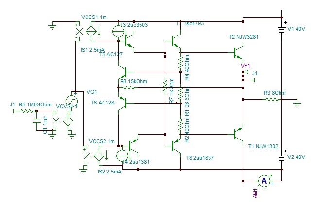

I am analyzing only the output stage. It is indeed a current biased. If I ground the output, the current has very low distortion with push pull input current. The problem I am looking for, what making it distorted when I let the output voltage swing. The Early is not the main cause.
The spice model I found for GT308b has Vbe threshold of 0.8v instead of 0.2v, so I am using the AC128.
