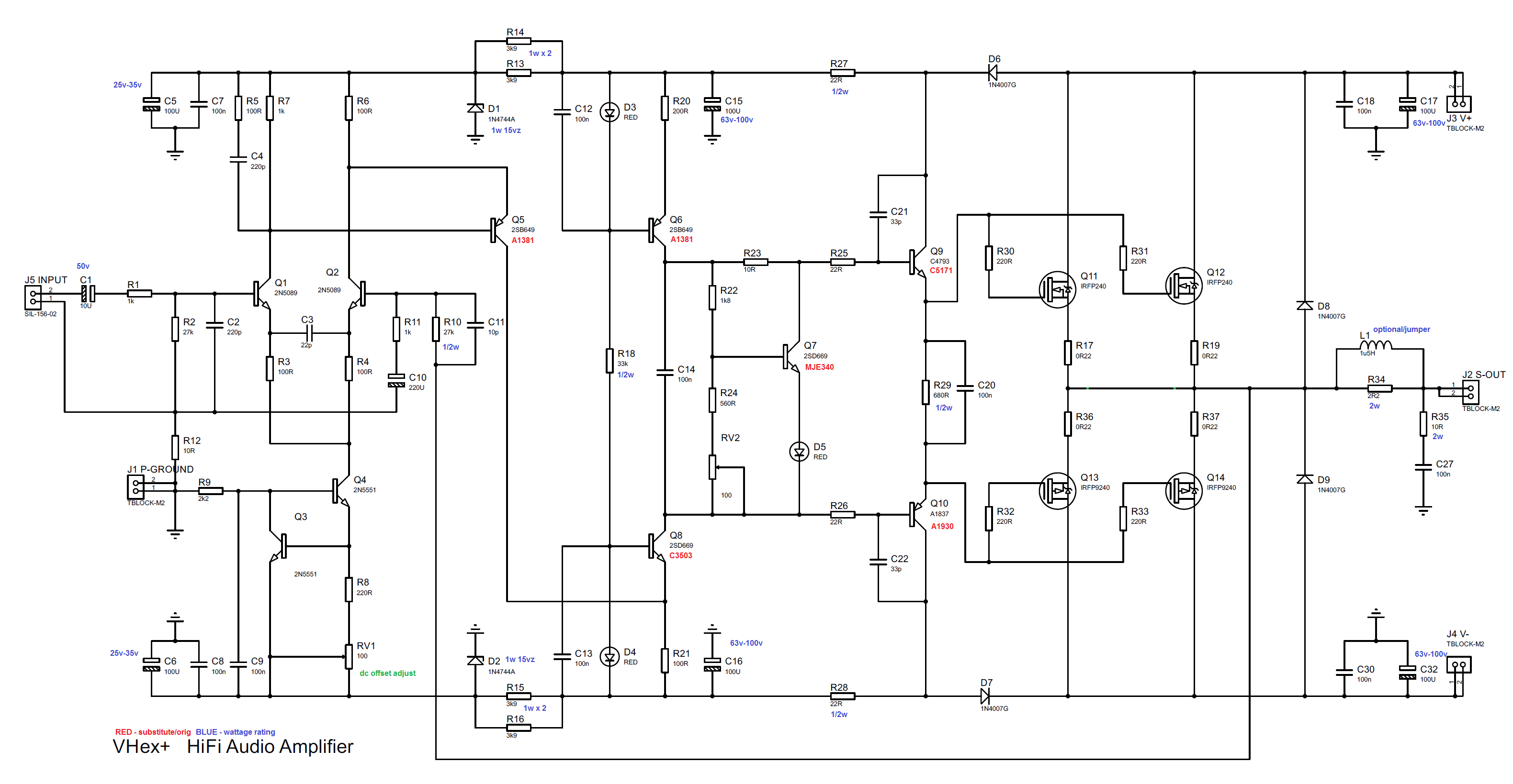

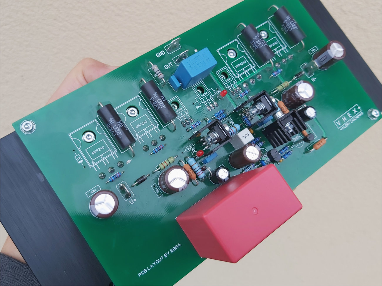

The scheme is interesting to look atSince there are too many possibilities to put the Wiederhold VAS into practice, I decided to build it in the simplest form first. Kletzov / Zaichenko VHEX +. The sound is much better than most traditional amps, very clear and smooth.

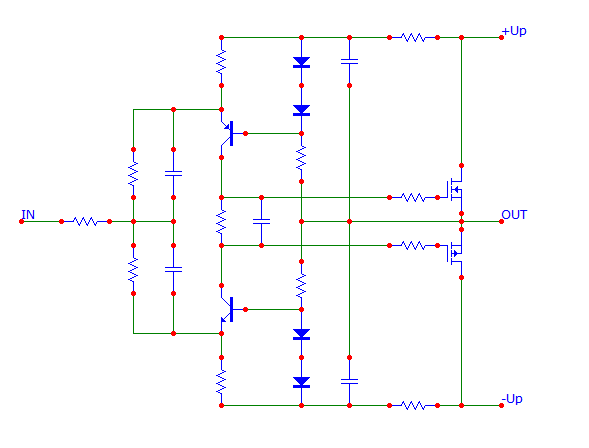

Practical solution from vegalab. I never seen any similar before.

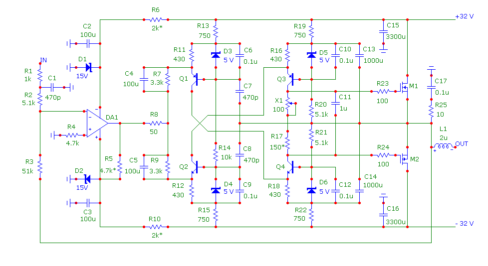

It's not Kletsov. Kletsov's feature is in the complete absence of cascades with a common emitter@Maxim. What do you think about the layout below? Wiederhold principle extended to output. LATFETs driven by controlled, bootstrapped CCS'.
Has the right to life.@Maxim. What do you think about the layout below? Wiederhold principle extended to output. LATFETs driven by controlled, bootstrapped CCS'.
an excellent amplifier.But it does not exceed the ones described above in the topic. one level approximatelyPractical solution from vegalab. I never seen any similar before.
Right, but it's much simpler, and very fast.

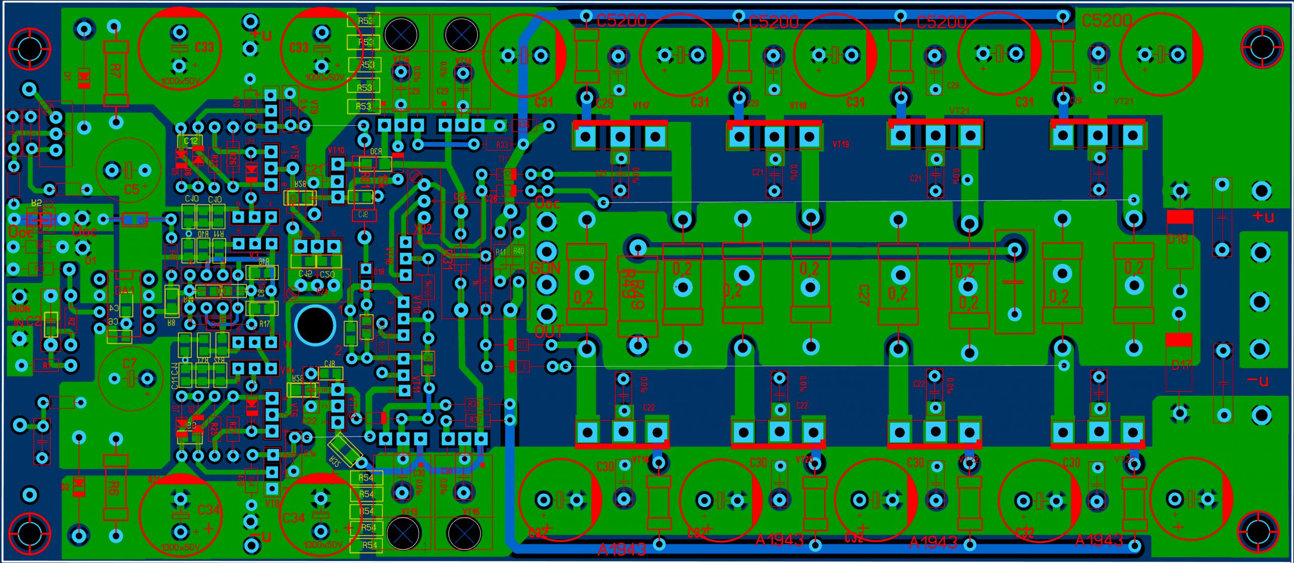

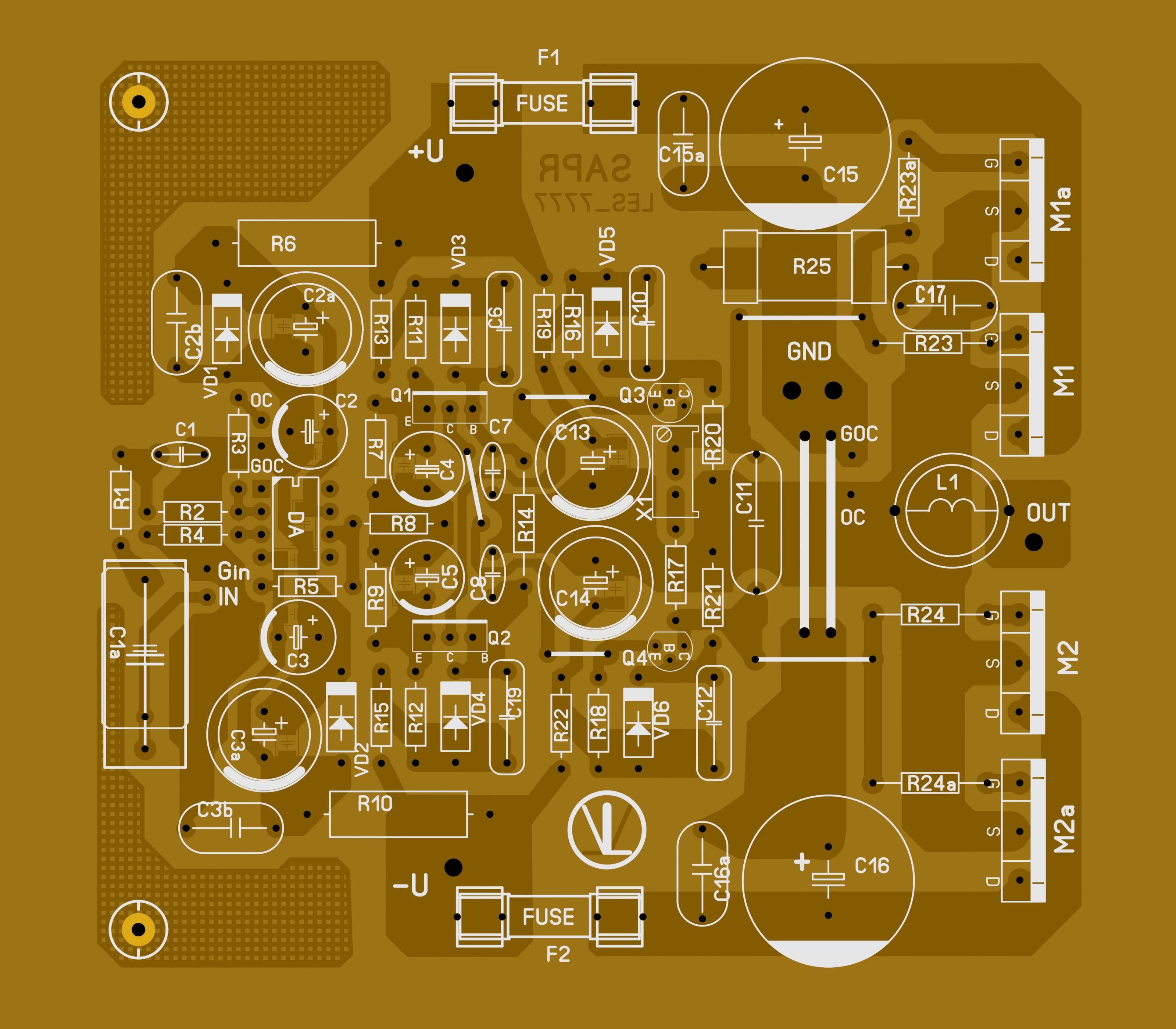

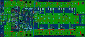

The printed circuit board is easier to make without errors
Some use this PCB, but it's worth to design a common PCB with power supply, avoiding wiring problems. After VHEX will fully completed, maybe I'll build this (LES-7777). It's an impressive circuit, has very low parasitic capacitance issues in a whole circuit results clean, smooth and natural sound. And pretty "unusual" ... as the title of this thread suggests.

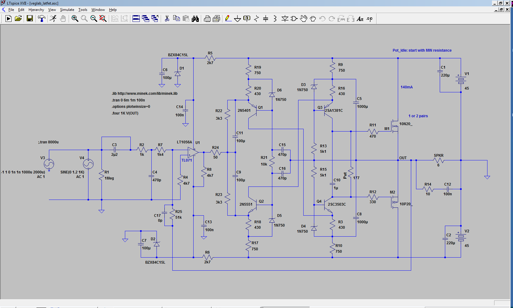

Here is quick sim.
As is, square waves are definitely not optimized (yet).
FFT and Thd profiles are relatively good (compared for instance with VHex), but far from being 'the best' in this thread.
More work is needed, especially for getting better square waves.
Also, doesn't look particularly fast, judging from the speed of (distorted) square waves.
Still, may sound better than BBC-2011.. We can only dispute measurements or sims, not individual's opinions..
1) Q1/Q2 run at 20mW
2) drivers run at 260mW - these can't be small transistors. they are only good up to 80mW
Instead of looking at currents, look at power (just move mouse over the transistor, bottom status will show power dissipation).
My sim is at higher rail voltage than original.
Well, technically Q3/Q4 are not drivers.. 2nd cascode? Whatever the correct name is....
