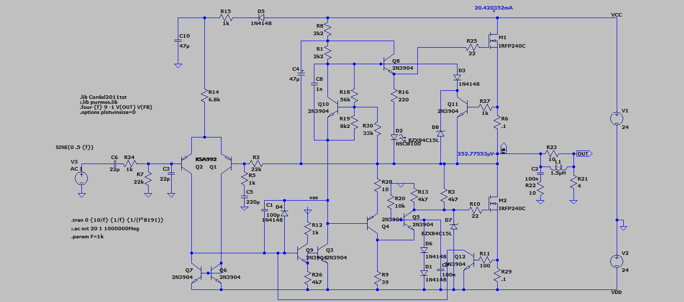

I promised to post my folded cascode quasi MOS circuit. Note that this is well behaved:
1. Good rail sticking, little to none.
2. Good THD (0.001 @ 1KHz) at low bias (20mA, 15mA)
3. Clips < 2V from both rails.
4. Includes current limit protection and gate clamps.
5. Easy to stabilize.
This example was done with cheap bjts so the supply is only +/-24 but you could easily go higher with better BJT transistors. At +/-24V you could probably use smaller TO220 FETs, ie real cheap.

The idea for R30 is to create a cascode function in Q10 and local feedback around M1 because M1+Q8 have more loss vs the quasi side. It is a partial feedback vs total feedback used in some amps to control idle current like the old "Specrta Sonic 701"
http://www.waltzingbear.com/Schematics/SpectraSonics/SpectraSonics701amp.pdf

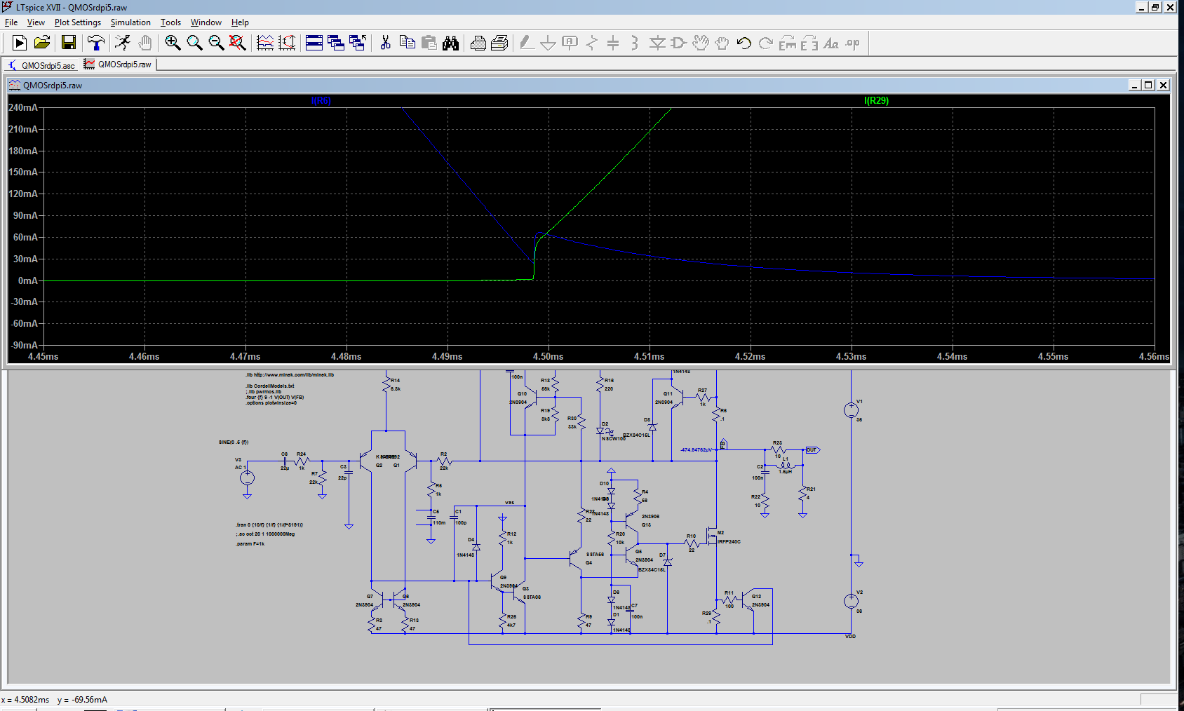

I didn't test it much so it may not help. I actually did this a while ago and I forget where I left it. There is a little glitch on the falling crossover that I'm still working on.

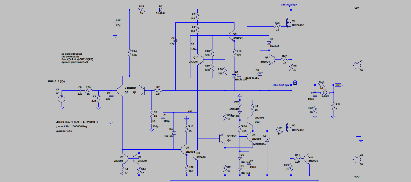

Improvement
This is better. R3 was a mistake because it causes phase reversal/clipping on positive peaks. And R13/R9 is supply voltage sensitive so I have replaced it with a CCS. The same is true of R8 because the VBE is not rock solid, but this post is about the quasi driver so I just changed R8 for 36V. I changed a couple BJT for higher voltage but note that Q8 is still a cheapo because there is only 8V on it. Note that the 1KHz THD is still ~0.001% and the bias is even lower, almost class-B.

How about replacing the upper bootstrap with CCS as well?
And then, using an op-amp instead of LTP :)
Actually TL072 might be cheaper than LTP.. and you are getting JFET input, perfectly matched.
I wonder if I could use biasing, lower driver+ccs, and upper driver from your schematic, and plug it into one the op-amp amps from this thread..

Ya, a VAS CCS is better in a couple ways. Mostly I was concerned about supply voltage sensitivity. But I was trying to keep it simple. I would probably still bootstrap the CCS in order to drive M1 gate above the +rail. The LTP could use a CCS too.
You could replace the whole IPS with a folder cascode VAS and op-amp but you would probably have stability problems. You are better at that than I am. I usually give up and stick with a LTP. CFA is also an option.
You can tweak the idle current and R9 etc to optimize the XO. It's not perfect but better than many amps. I will continue to fiddle with it but I thought the CCS vs R3 was a significant improvement that I should share.
This driver circuit is "fast enough" but not a slew champion. I think we know how to improve that but do I want/need to?
