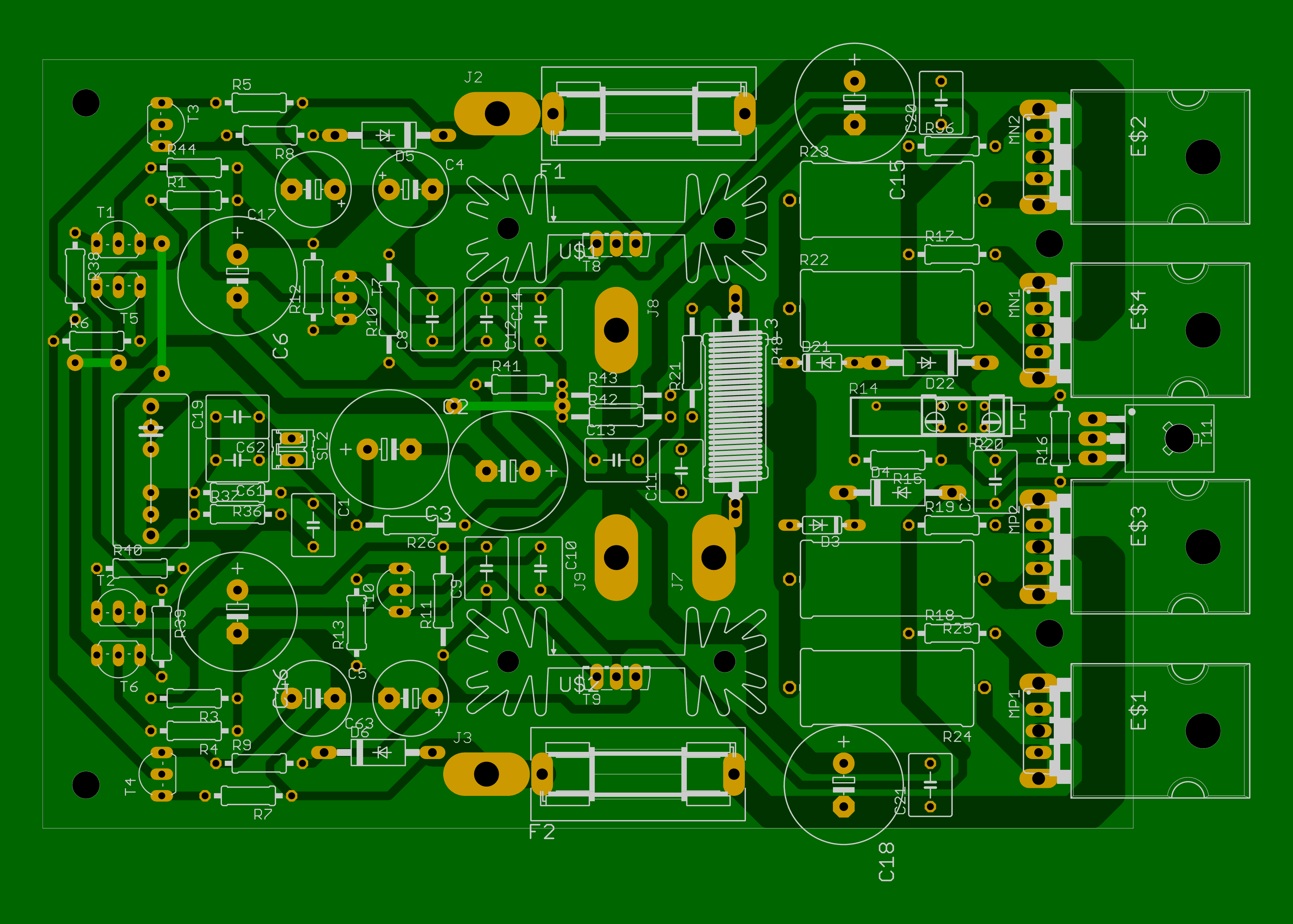

R31+C14 makes a very heavy load for the output.I would like to share some playworks. Close to original, but with additional places for plastic power transistor packages. Also places for compensation caps, as spice shows unconditional stability with few more pickofarads. All there in attachment, if some mistakes please write it here.

It is only for spice analysing purpose. In praktice that conditions can occur only for short moment. This circuit shows no overshot on 20kHz square loaded by 100nF, and acceptable peak with 1uF, and without output coil.
By adding 2x 6.8 pF, 2x 10pF and decreasing four resistances this amp can simulate unconditional stability. Now it should be proved in practice.

checking the layout, i found that the used output transistors have a BCE pinout (why bjt here?). the LATFets 2sk1058... and the Exicons have a GSD pinout (equivalent bjt BEC).
The used pinout is for Vert. Fets like IRFP 240/9240, and Toshiba 2SK1530/2SJ201. But they will not work in this board, since the temperature compensation for these types is missing here.

Thanks for check. Forgrt bjt, it is here only to take measures.sorry Kay

GSD variant in attachment

sounds interesting, but one remark for your VMOS version. The BD139 of your temperatuer compensation must be themally connected to the output stage, otherwise it will not work proper.
One further remark, for tuning the native Elektor Crescendo from 82 , just enter 'ray's audio page' in Google and you will get a lot helpful informations to update your existing Crescendo 82.
Based on these informations i think a new layout would be better using the parts that he suggested, for example the capacitors, the non inductive source resistors . If you use output transistors in plastic verison TO-264 or TO-247 . this layout can be shrinked by half. Also hard and expensive to get the TO-3 versions of these lateral Fets.

Input transistors thermaly coupled due to lowered emiter resistances.
Bias current thermal control on board.
Almost half a size
If interest, I can upload gerbers.

two remarks so far,
a) please make it also possible to place metal band resistors (MPC71or BPR56) as source resistors (dot pitch 9mm) for prevent oscillation due to lower inductance
b) why not use a bipolar capacitor for C5 and C6 ( like Frolyt EKSU RM 5mm) ?
