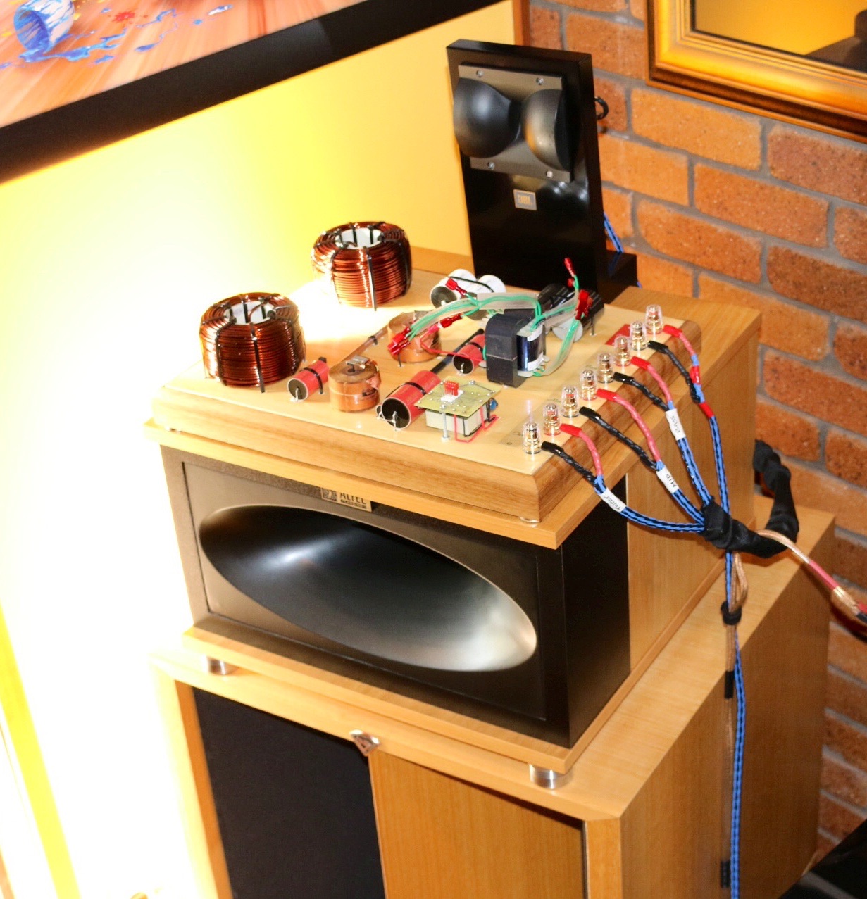

First, could you give more details on your speakers.
Yep no problem
Heavily modified 3 way Klipsch La Scalas
Drivers Consisting of
Crites CW1526C 15 inch cast woofers.
Great Plains Audio 399 A mid compression drivers, fitted to -
Elliptrac 400 timber mid range horns with adaptors to suit 1”, 1.5” & 2” horn drivers
JBL 2404H compression tweeter driver and “Baby Cheeks” horn
Bass extension bin fitted to lower section
Add to that custom made crossovers with db adjustment
Cheers
FR
