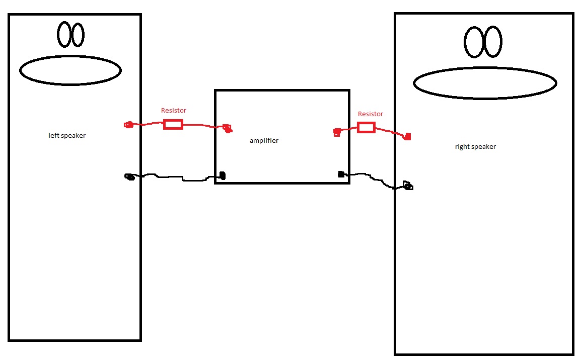

add 0R33 (5W or more) in between speaker and F5 output , and observe what's happening
it will give at least a part of needed info
Thanks Zen Mod
I have a few resistors of different values on hand from the crossover build
So lets give this suggestion & easy test a go if time permits tomorrow and see what transpires

Resistor experiment conducted
First connection impressions of 10W resistor connected to positive terminal of amp to speaker
It's the only value resistor pair I have in the spares basket
Result of experiment
Volume is lower by approx 10 / 15%
On turning the volume up to match previous level for comparison
All speakers seem flat by a small percentile ( read that as a little lifeless ) as previously they are engaging to the point of reeling the listener in on a fishing line
An example to explain - Listening to string instruments like the violin And the deeper chelo - - normally the bow can be felt as it passes over the stings
Triangles just ting where before the whole note was held from start until it was exhausted
Also the multi layer nuances have gone the same way
Result not as nice as without the resistor
