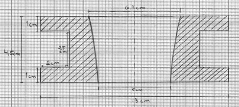

Also I have a main question. In the process of making my 350Hz SBs, Till has been helpful researching possebilities for a throat piece adapter in metal (aluminium). The only problem is the piece cannot be made with a tractrix flare, so I'd have to start the horn expansion with a Conus flare in the adapter piece. Now, will this introduce any problems?
Would it yield better results having no expansion at all in the 4,5cm adapter and then doing the pure tractrix contour in the wooden part of the horn? Opinions?
At the time being, I will not focus on the top end, but I am curious, wouldn't it be a trick to mate a 350Hz TD-4001 SB upwards with a smaller SB, for example with the TD-2001 in a 2kHz tractrix flare, possibly crossed in the 3kHz-4kHz range?
Or should I get the adapter piece made with consentric rings, and sand it down to an extension of the tractrix contour maybe, for a pure tractrix shape on the entire horn? This might actually be my solution..
You should use the same flare throughout the horn if possible.

Thanks. I'll try to get the piece made with concentric rings then, and work it down to tractrix.
"You should use the same flare throughout the horn if possible. "
what is the flare inside the 4001? i guess it is conical. i would make the adapter also conical as it is better in precision, with a larger angel than the part inside the drive. Tthan you work the part were horn and adapter is connected to an inbetween curve.
but it will work with your method also.
till said:what is the flare inside the 4001? i guess it is conical.
Thanks Till
I mistakenly thought it was a straight pipe with no expansion, but checking it out, it does indeed appear to be a conical flare. Then, if I go for a conical adapter, Why should I not continue the same flare expansion as within the driver? Wouldn't this be "safer"
because exactly the same is not possible to machine (even not to measure), and i suspect a smaller angle would be of disadvantage. i would make it at least a bit larger to be on the safe side. i read somwere a "faster" opening horn gives less THD...
i don´t know what production method you will use for the horn - i designed my adapter the way it is because i was limited to what i was able to make at the horn.
Well, it seems like I will go for the concentric rings concept, working it dow to tractrix... I guess I'll have some time to think about it though, Tell me when you get the materials quote, I understand it'll be expensive, but I have no idea about the price range..🙄
