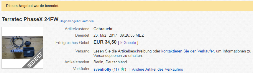

This one can do -110dB THD and -101dB THD+N @-3dBFS, not bad for a card that costs EUR35-60 from eBay (I just ordered one
It even has Toslink for digital in/out, the catch being that it only works with Windows XP/7 and needs FireWire.
