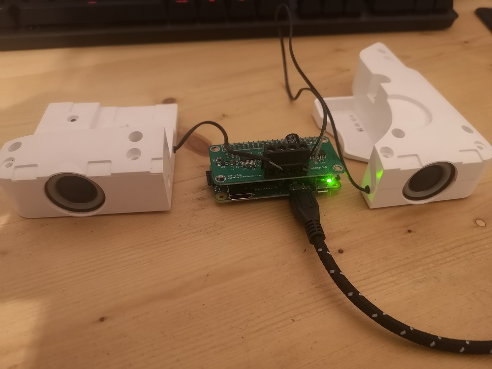

I've been trying your script out with a Raspberry Pi Zero, coupled with a HifiBerry MiniAmp. I'm using old iMac's speakers that render a pretty good sound, given their size. Also I'm powering the whole directly from my Windows computer's USB and... it works very well!
I have two questions:
-> Do you allow me to publish your (slightly modified) scripts and HOW-TO for the rpi zero on a GitHub repo? I would of course credit you as you want for the scripts.
Sadly, I ran into a wall with the MiniAmp: I don't know yet how to set the volume. The MiniAmp doesn't have Software Control, so I added it thanks to this post, but of course it doesn't work.
-> With your gstreamer wisdom, do you know how I could set the volume of gstreamer dynamically, let's say with a little rotary controller like this one?

Yes, of course, please do! I'm glad that you like it enough to share it with others. That's what DIY is all about.
You cannot change anything about Gstreamer dynamically when using the command line invocation of Gstreamer. Instead, and what I do, is you can create a new ALSA softvol control for the input or output from your soundcard (if there is not one already). Then I control that via the command line using amixer. You could write a script that polls the rotary encoder for state changes and then sets the volume in a similar way.
