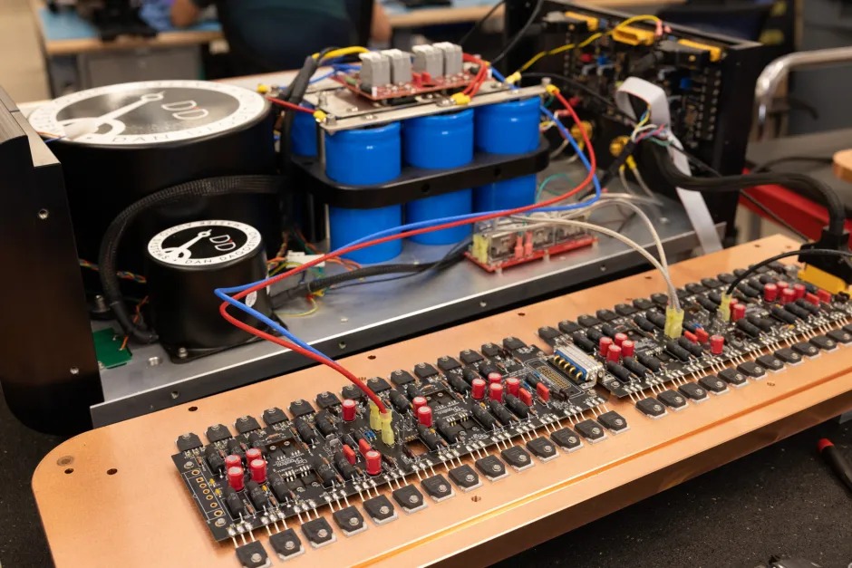

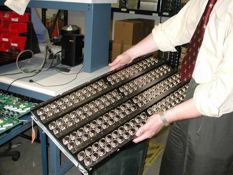

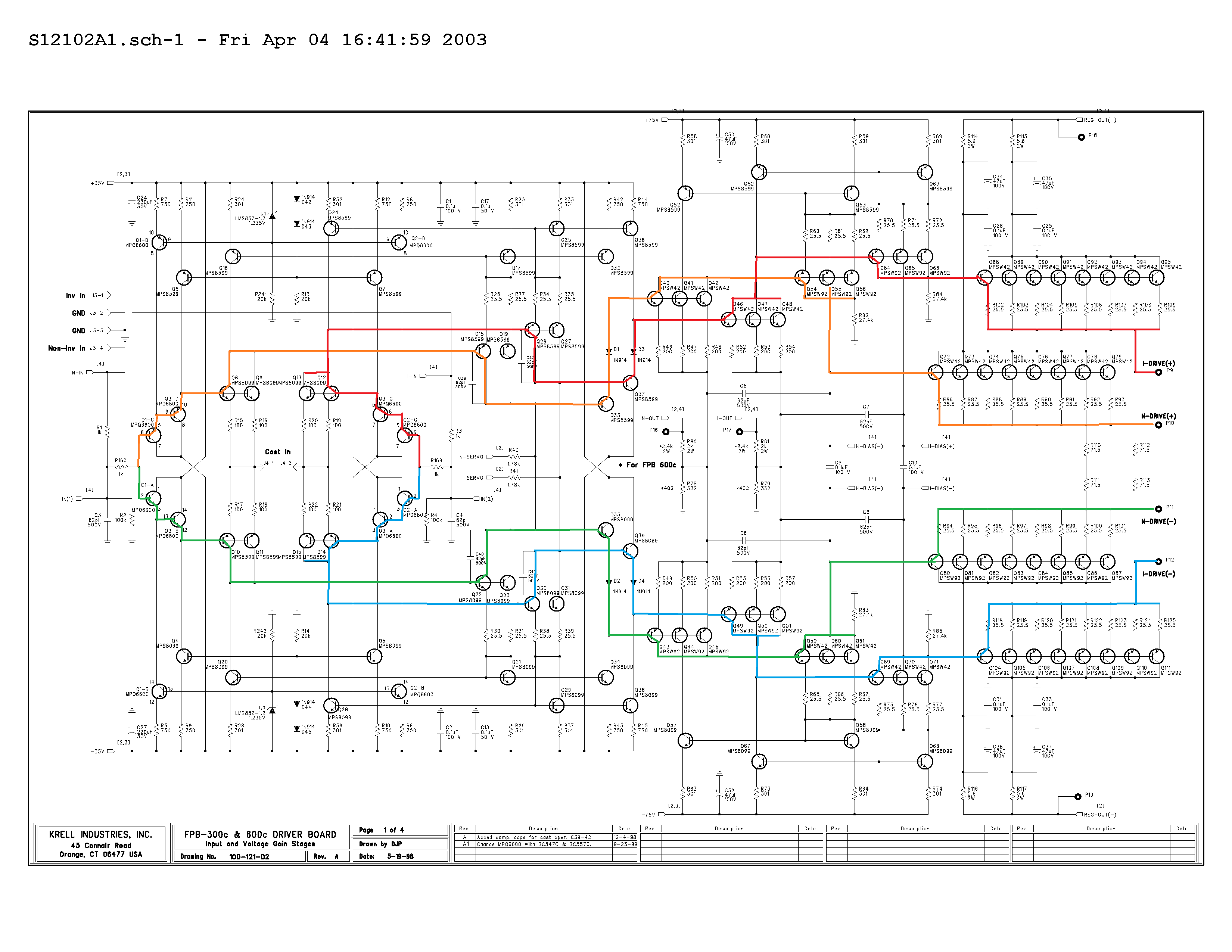

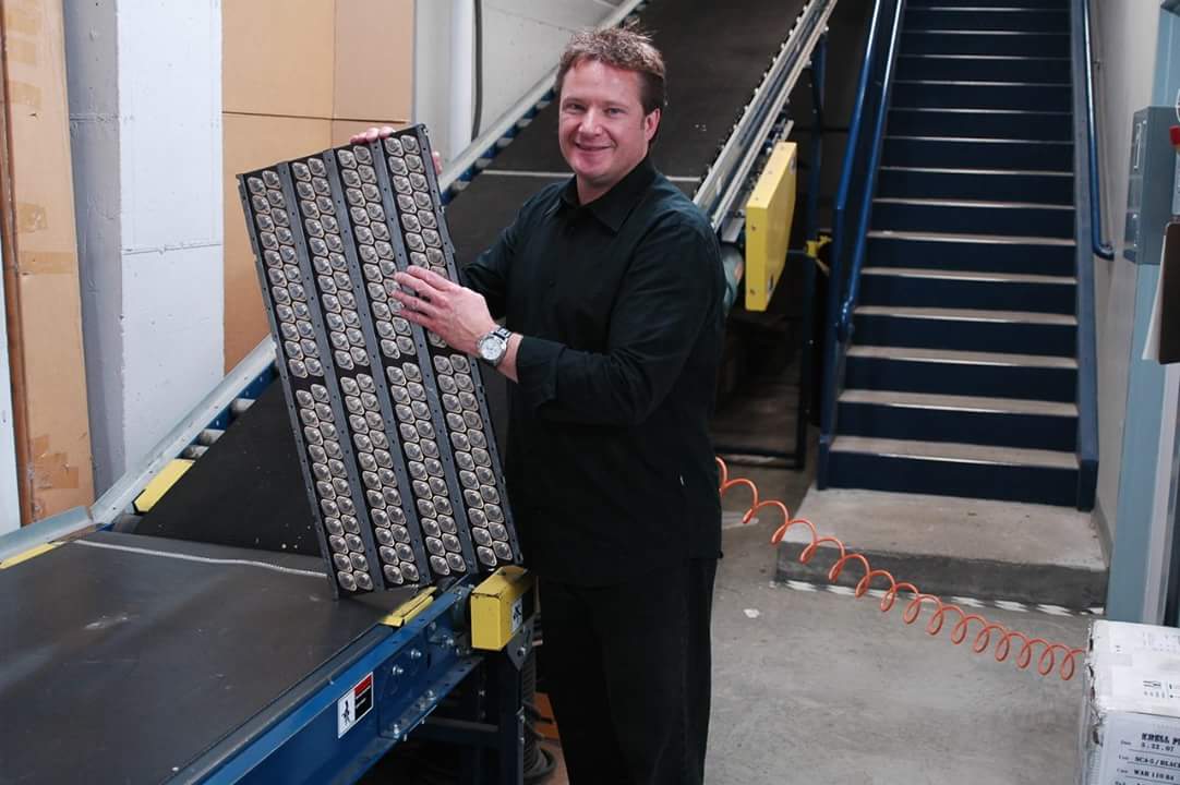

any news?I am still looking for commercial audio amplifier brands, where are in use a bunch of small or medium signal transistors in the output power stage instead only one or only few BjT power device in each half.
commercial amp devices seems to be very rare. But where are the best schematics for diy projects in this matter (except the above mentioned and the follow:This approach seems to be very good in view to the sonic quality. Thule's integrated amp IA120 work with a bunch of paralleled TO-126 (unfortunately I haven't the schematic).

Obviously massive amount of BjT's with TO-247 or TO-3 outline in a parallel mode more often to find in commercial amp devices than such with small outline like TO126 - check out the attached imagescheck out in this case the first attachment in post #57 (and my question) under
