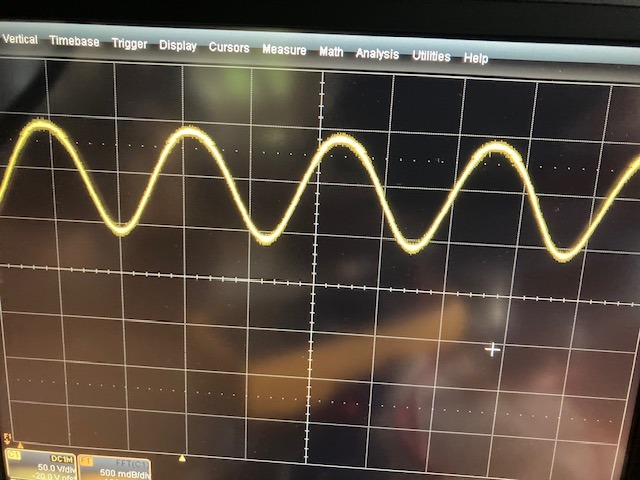

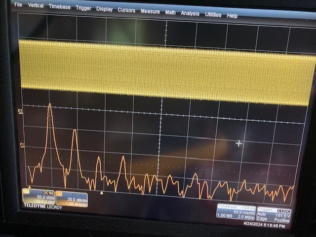

Learned a ton about Class A using EL34 before building
I am comparing Jfet distortion effects to Class A amp for guitar
So far everything lines up with bench testing. Tube models look very accurate.
