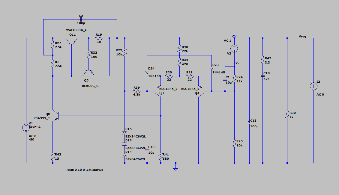

Just for the fun of it, to see what did change, I added the capacitance multiplier used by Goldmund Mimesis 9 to the 2 transistor regulator.
This time I got -100dB at 10 Hz.
You can stack regulators, passive & active filters ad infinitum and get -300dB PSRR, but what's the point?
What are the pros and cons of capacitance multipliers?
You can find all the information on the net or this forum, but remember that cap-mults, in their simple form are just like simple regulators, except they don't regulate, and their PSRR is limited also by the Early effect
OK, things are getting to a nice closure over this power amp supply.
Let me tell you what I think it's worth using.
1) LDO, good DC performance and low output impedance are interesting. Point to the two transistor regulator.
2) Asymmetry is not essential, but easy to have with a trimpot. Point to the two transistor regulator.
3) Adding a CM adds one more transistor, but I get better specs than with the three transistor regulator. Point to the two transistor regulator with CM filtering.
The would provide me with an adjustable LDO, good DC performance and low impedance regulator. Am I right?

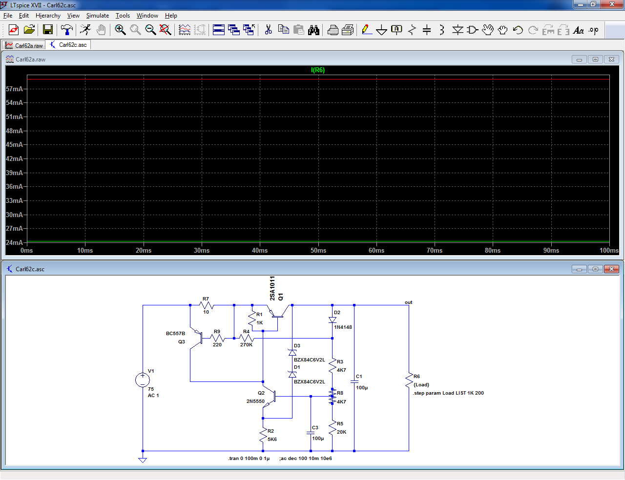

How and where should I add a protection transistor, and why? I will add DC protection circuit, also inspired on the one used by Goldmund, which also protects from oscillations.
Now I will open another thread, as I had mentioned, for the RIAA preamp's power supply. And your Denoiser and NoNoise design will be main contenders.
A protection is always optional, and you could think that it is only needed in bench supplies, and you could be right -most of the times-, but it is inexpensive, easy, and can save the day when you are experimenting with your circuit, or if a cap goes short, etc.
Here is an example of such a protection, dimensioned for ~60mA:
attachment.php
Thanks to a strange LTspice quirk, the first load is 200ohm and corresponds to the 24mA trace.
60mA is for 1K

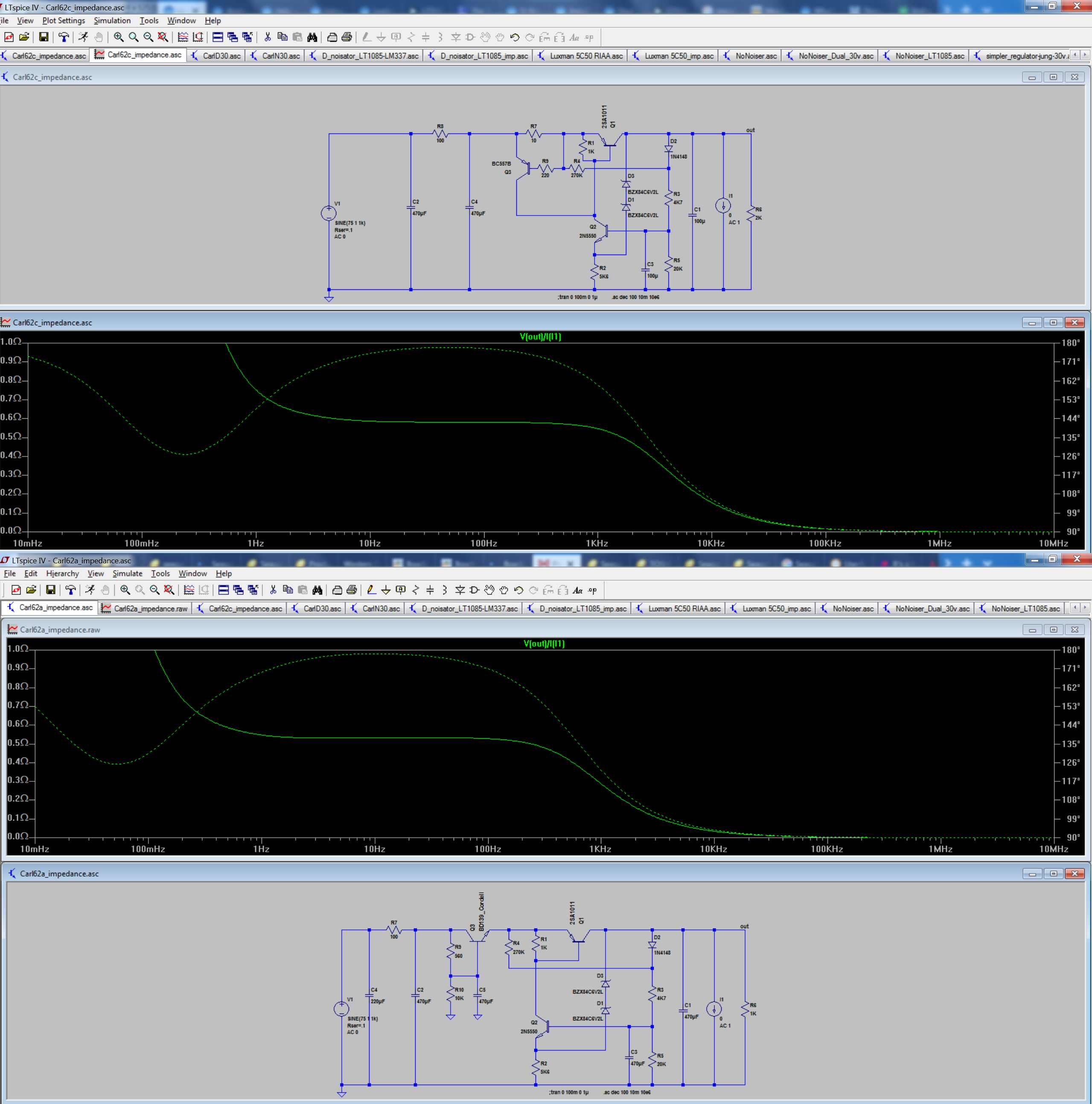

Some further investigation on the High voltage low current regulators we had been working with.
This time the theme is impedance.
Hopefully the simulating setup is correct.
Curve results are not as good as the superregulators and similar that are being analyzed on another thread.
The unsolved question is how a power supply impedance affects the audio quality. Or how PSRR or how noise does affect sound quality, particularly on this case where the signal levels we are dealing on power amps are a lot higher than on sensitive low current preamps.

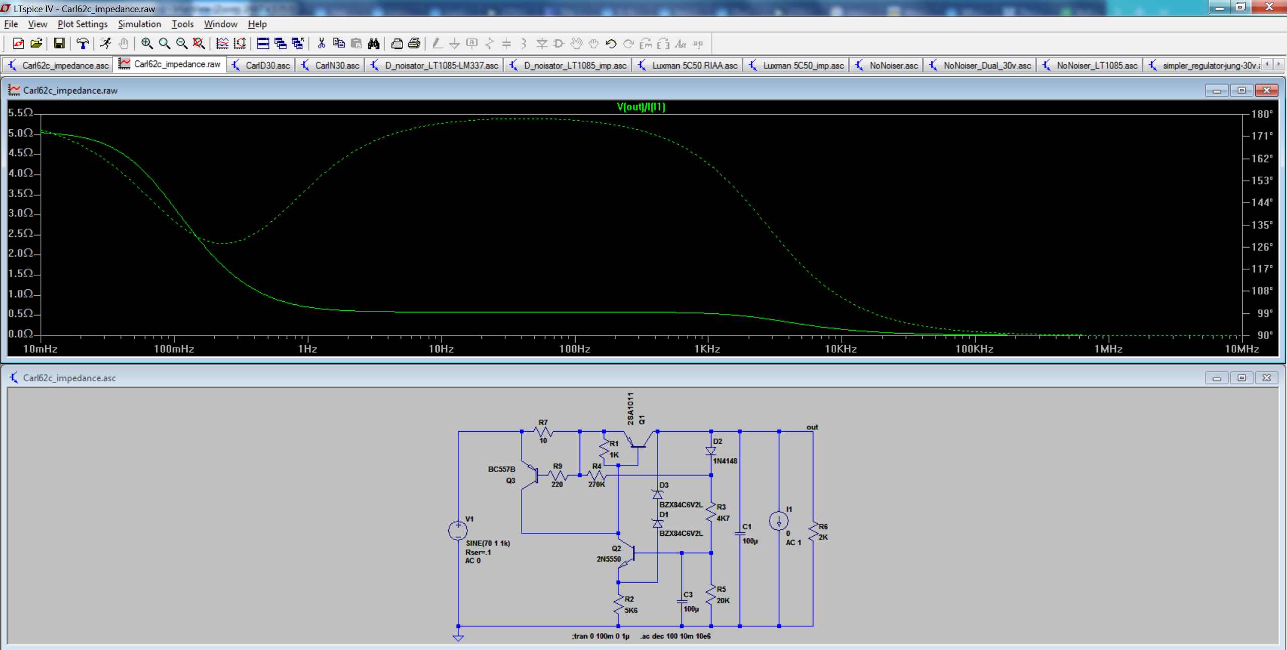

An strange case for this comparison was between these two versions of the same original two transistor regulator.
One with transistor protection and the other with a capacitance multiplier between input filter and regulator.
As it can be seen, the version with the CM behaved slightly better than the other one in impedance response.
Stranger yet, even if not shown, was that adding the CM to the protected regulator resulted in an even worst impedance response.
Not strange at all: the series resistance has to be corrected and has a small impact on the output Z.
When you use both the CM and protection, you have the addition of the series input impedances resulting in slight degradation of the output Z
So you have to get to a compromise between output Z degradation and better PSRR from both regulators?
Though I wonder if this would result in audible changes for different combos.

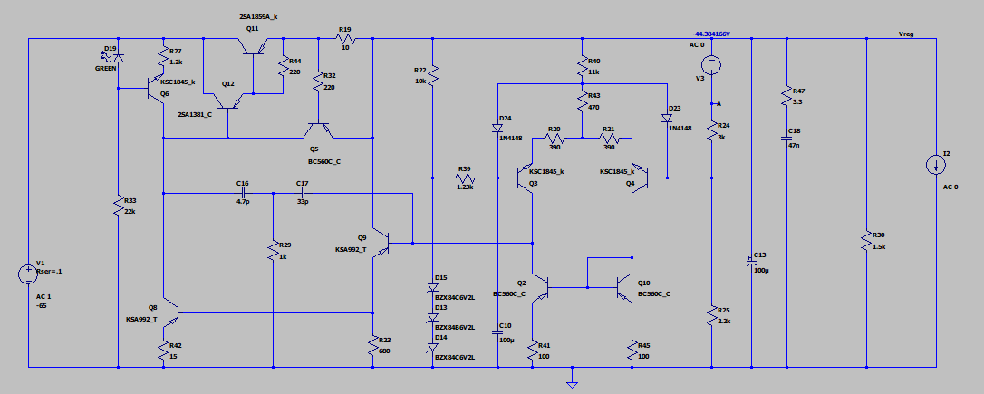

You could try something like the circuit below, it's a bit more complex than the 3 transistor circuits but will provide much lower output impedance and 90 dB line rejection in audio band. It does need some more dropout voltage for the bootstrapping to work, otherwise it can be replaced with a CCS. This is the negative version, just invert polarities and flip diodes for positive version.
attachment.php
Sure, here you go. Note that C13 includes ESR and ESL specified. The ESL comes from another thread here where people measured actual ESL of real electrolytic caps. Hence the presence of the output Zobel, without it the output could ring when stimulated with output current pulses.
If you get bored, also attached is the original design which is even more complex. I call it the Blameless regulator since it resembles Doug Self's Blameless Amplifier reconfigured for regulator service. This is more of an academic exercise at this point though I would not be surprised someone actually trying to build it. It even has two-pole-compensation! Maybe I'll put it in a new thread if people care.
attachment.php

If you replace R2 by a zener and D1, D3 by a resistor and make Q1 an NPN, it'll get better.
