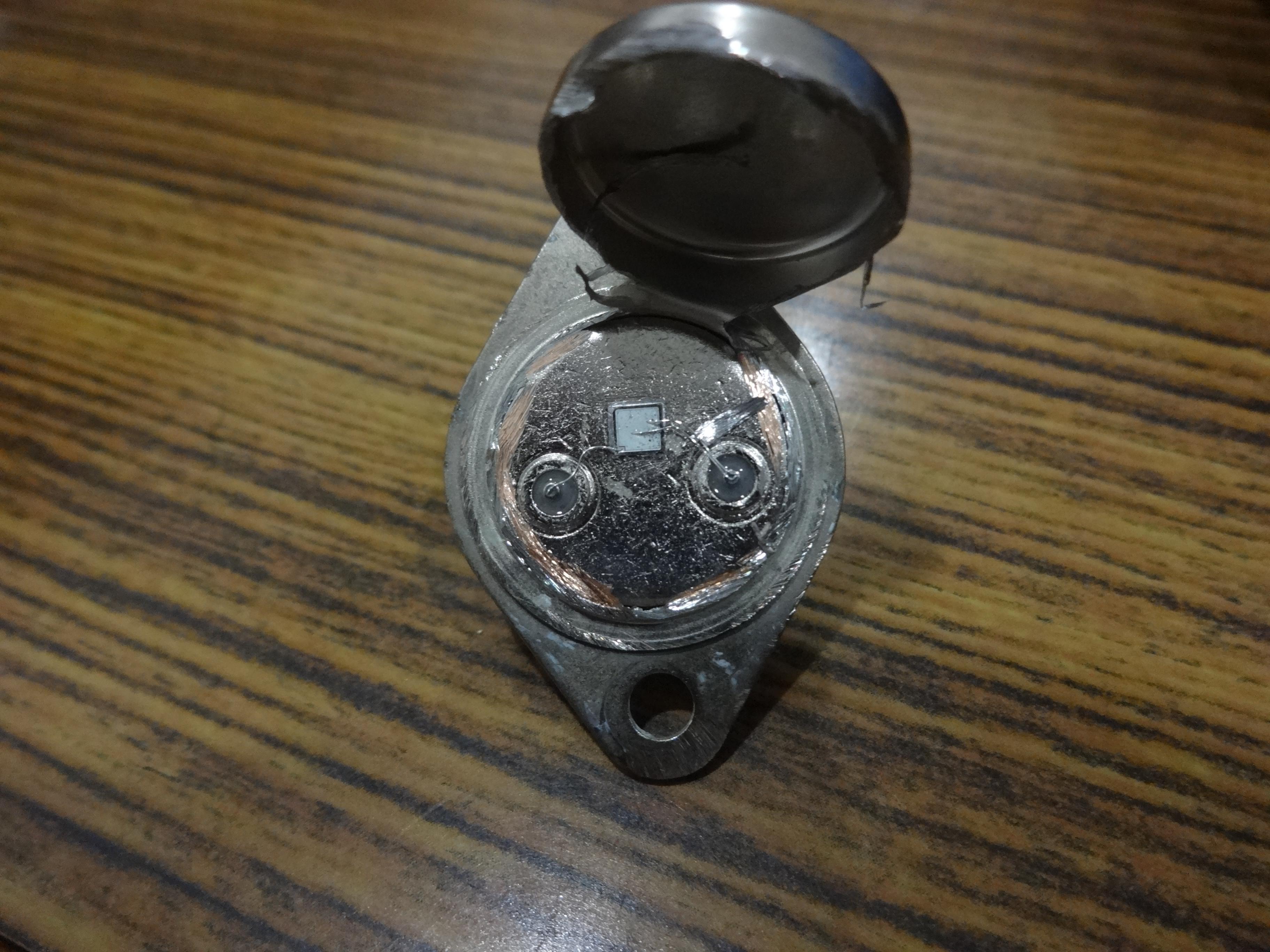

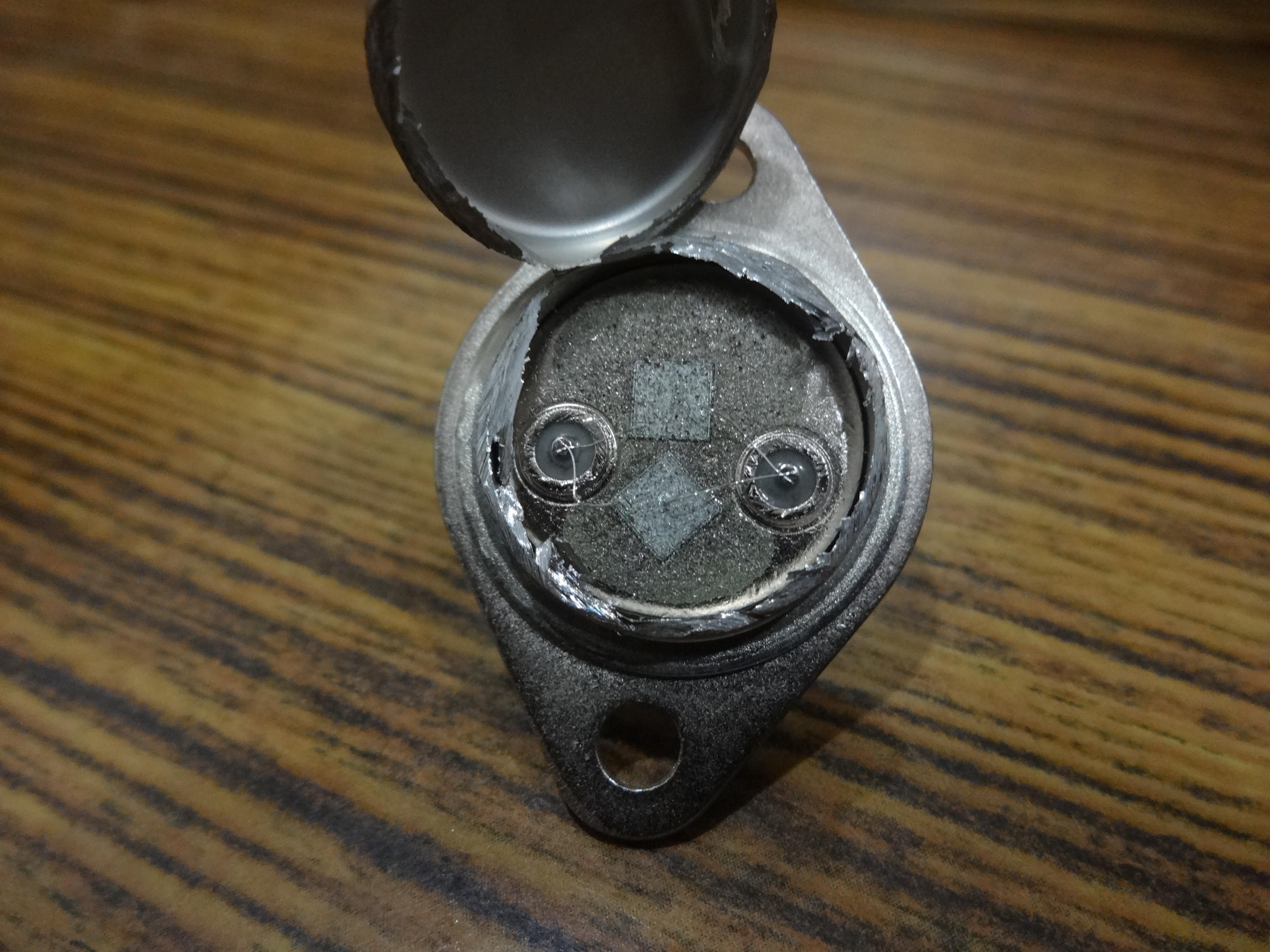

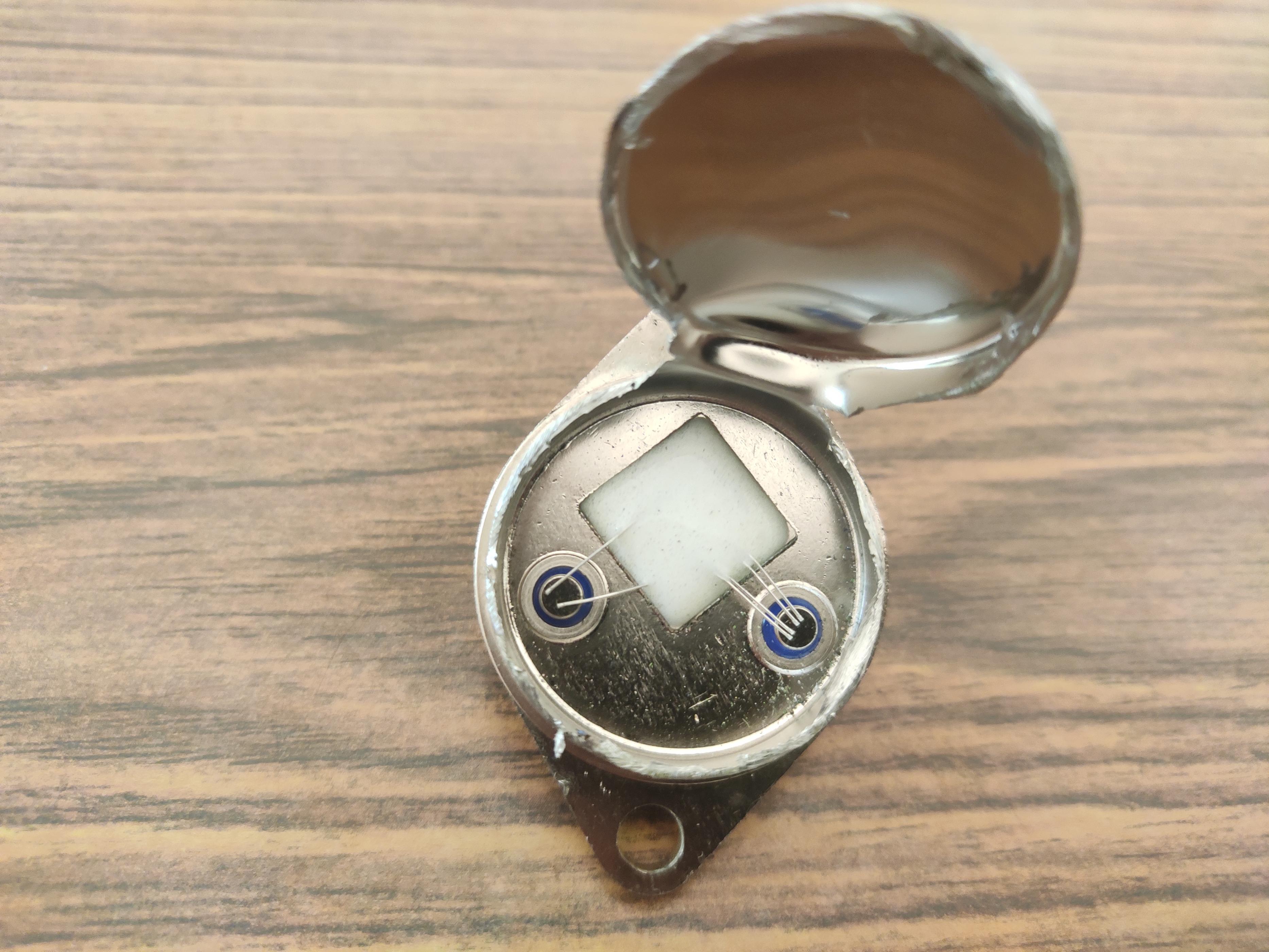

Today I cut opened some V fets. 2sk60,2sk82,2sk70,2sk76 and 2sk180
Tokin 2sk 180 die size is 13mmx13mm. Very Big one.
2sk60 is the smallest one . Only 2.5mmx2.5mm. grade /batch P56
Yamaha 2sk76 3mmx3mm
NEC 2sk70 4mmx4mm used thick bonding wire compared to others
Sony 2sk82 two 4mmx4mm die connected parallel. grade JE33
I thought 2sk82 is a double die version of 2sk60. but 2sk82 have two bigger sized die.

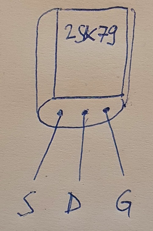

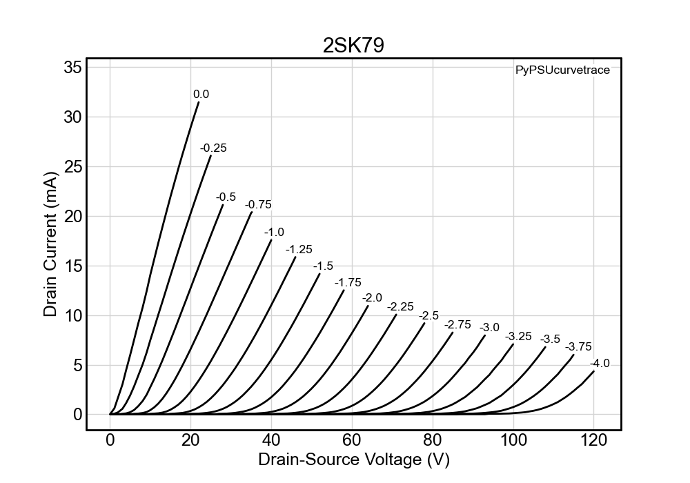

I was referred to this thread when I asked about the 2SK79, but I could not find anything about this part here (am I blind?). Anyway, here's a datasheet I found on the Amplimos website (with wrong/useless pin labels), my own (correct) pin label and my curve tracer data.
The very first post? The PDF contains J18, K60, K63 & K79. ;-)I was referred to this thread when I asked about the 2SK79, but I could not find anything about this part here (am I blind?).
