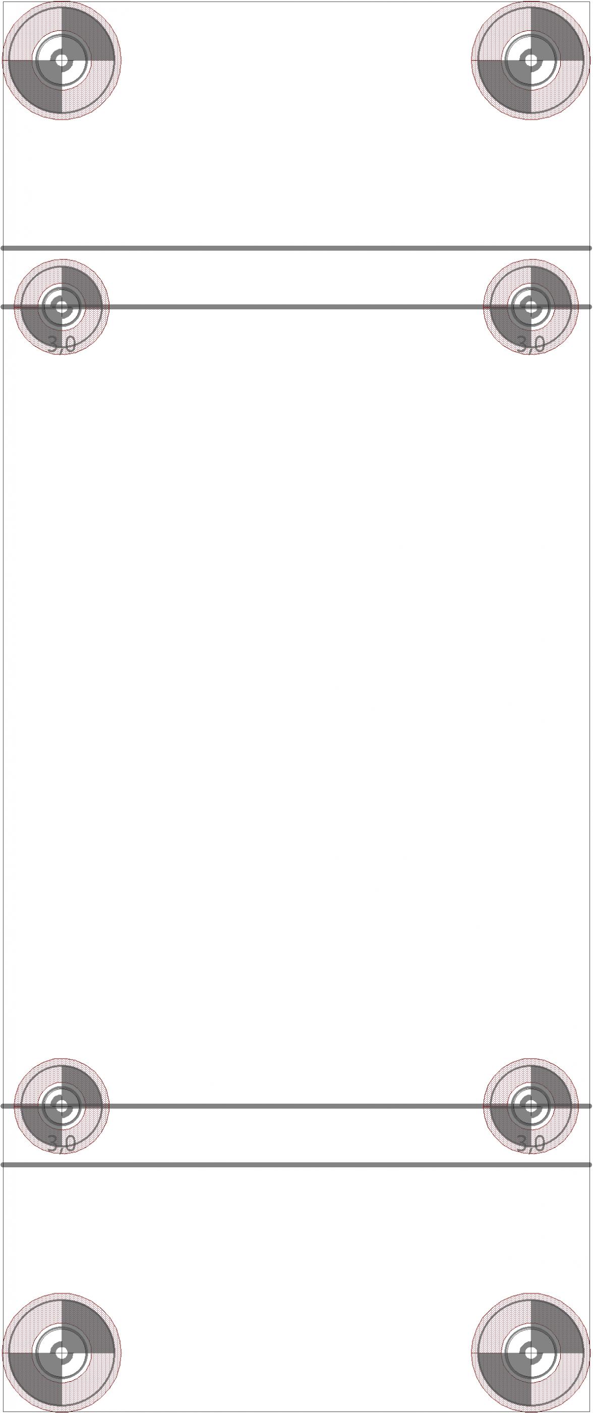

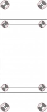

No gerbers but a template this time
This is a template for a board with a heat sink on the back. I use this template for a lot of my projects. I choose mostly SMD parts on the top and then mount the board with the parts down and the heatsink facing up
RAD-A5723/50-AL STONECOLD - Koellichaam: geextrudeerd | met ribben; natuurlijk; L: 50mm; W: 78mm | TME - Elektronische Componenten
black anodized version.
RAD-A5723/50 STONECOLD - Koellichaam: geextrudeerd | met ribben; zwart; L: 50mm; W: 78mm | TME - Elektronische Componenten

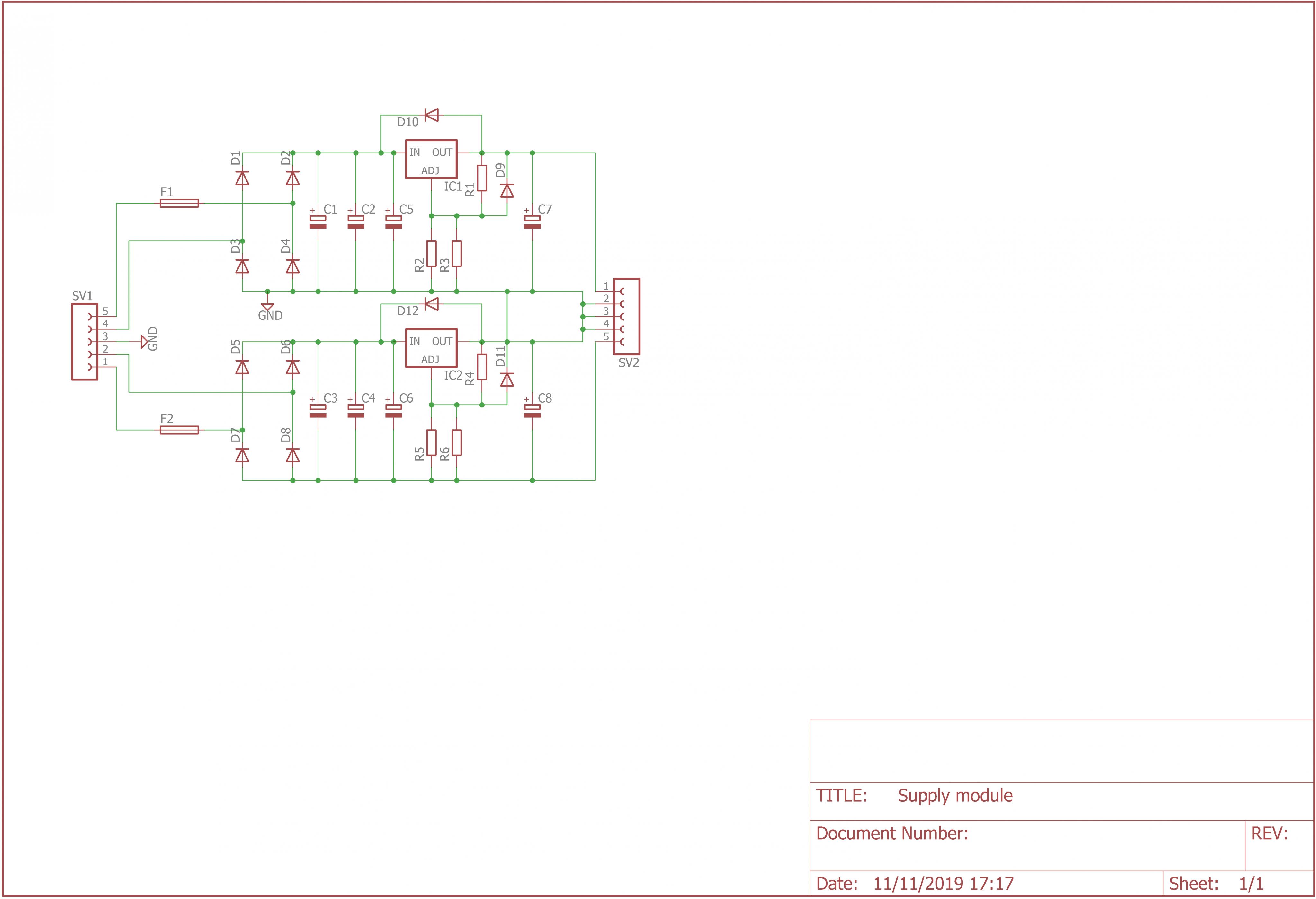

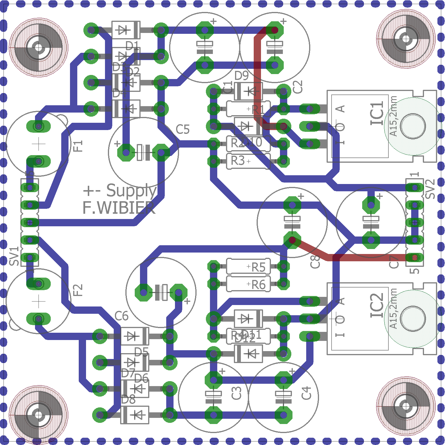

+-supply, LM317 based piggyback board
I was tired of breadboarding a complete +-15V supply every time i wanted to build something. So i made this board on a 2.54mm grid. You can just plug this board into whatever you are building. So you don't have to repeat anything.
Eagle files are also attached for anyone that wants to tweak the design.

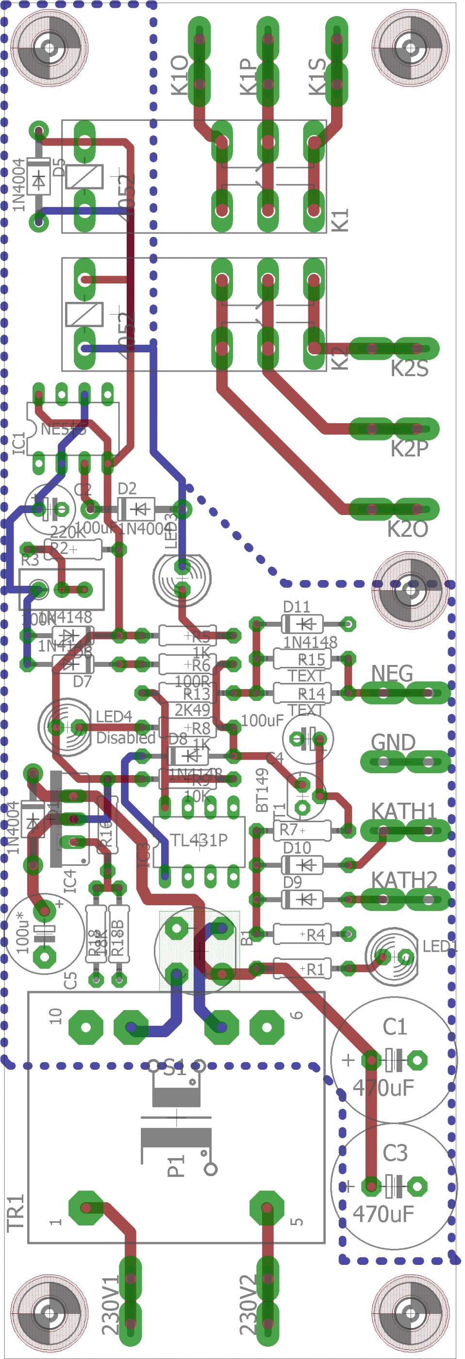

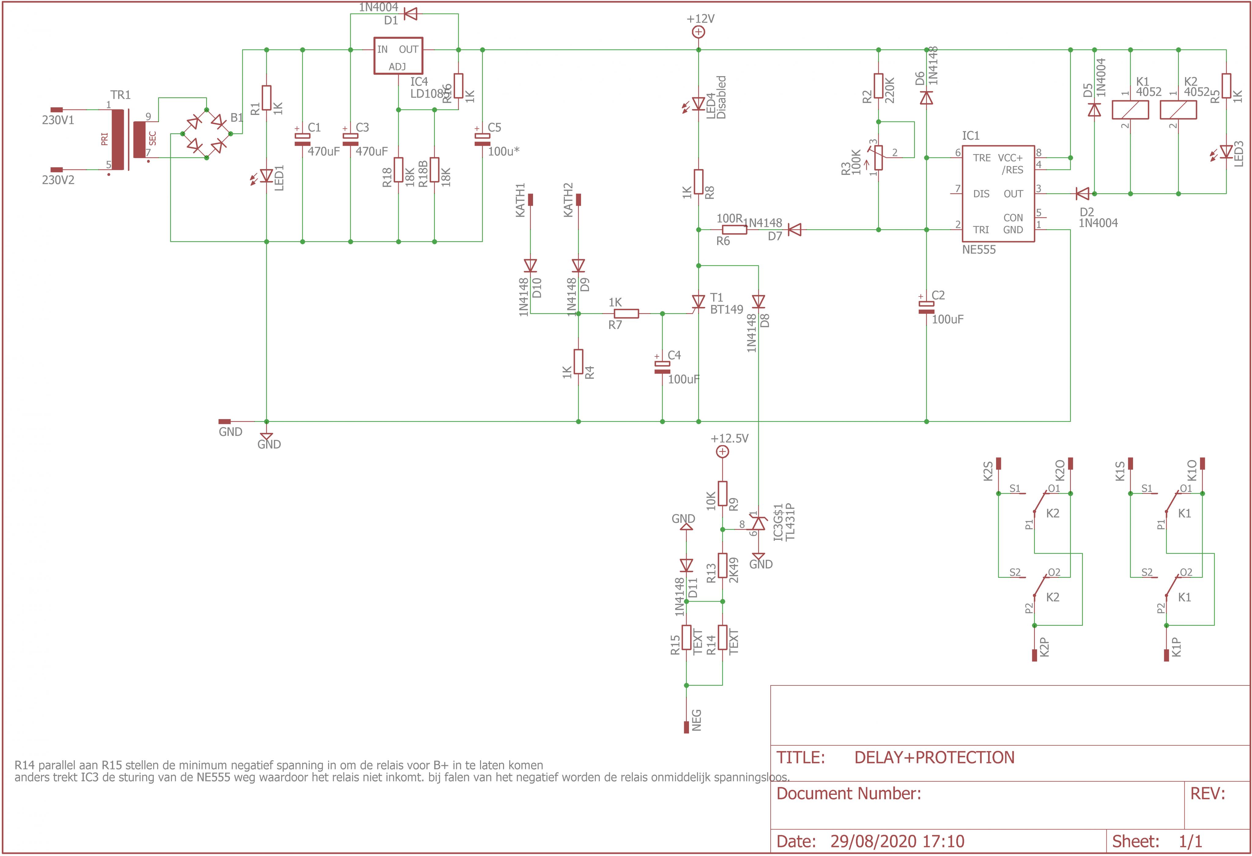

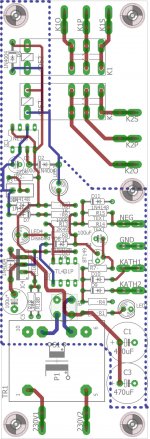

Time delays plus protection boards.
Pretty complicated boards.
Anyway there is a thyristor based over-current protection, and a TL431 based bias guard circuit that keeps the relays from switching on if there is no bias present.
Eagle files are attached for the ones that want to make alterations.
Cheers.
Cheers.

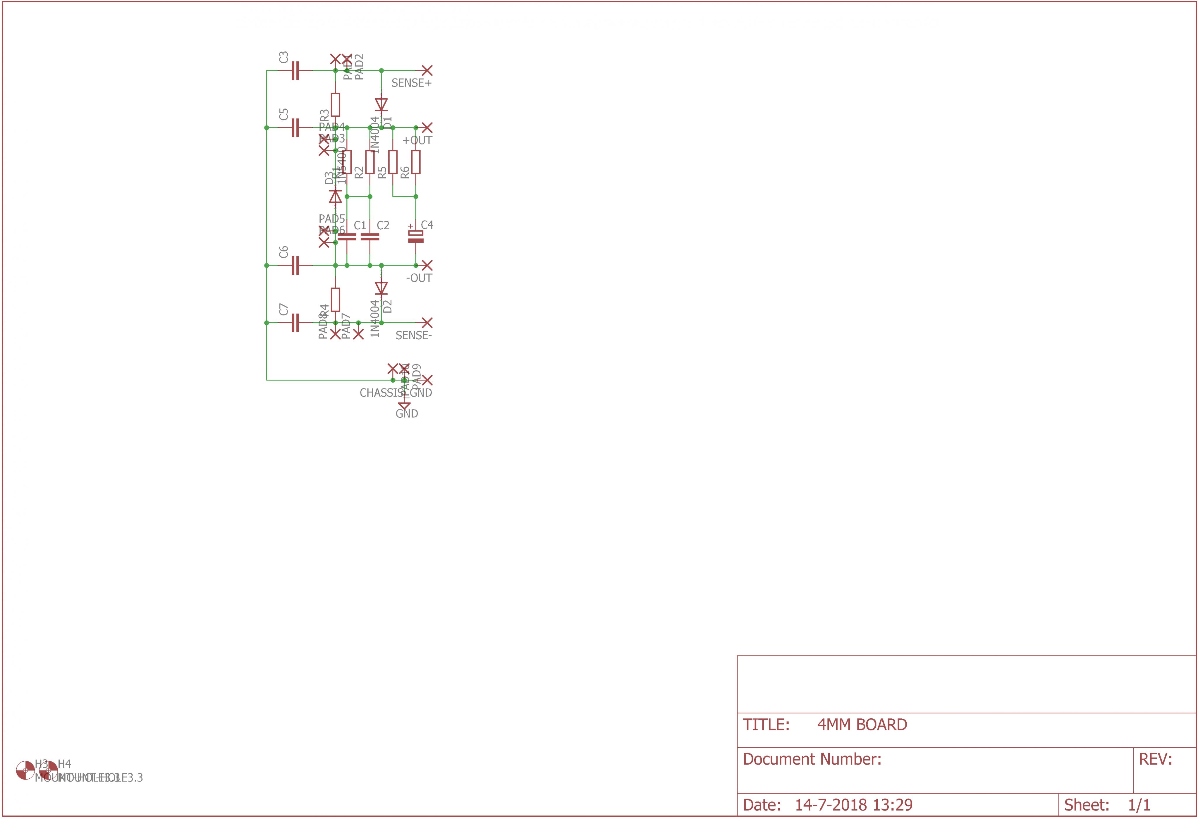

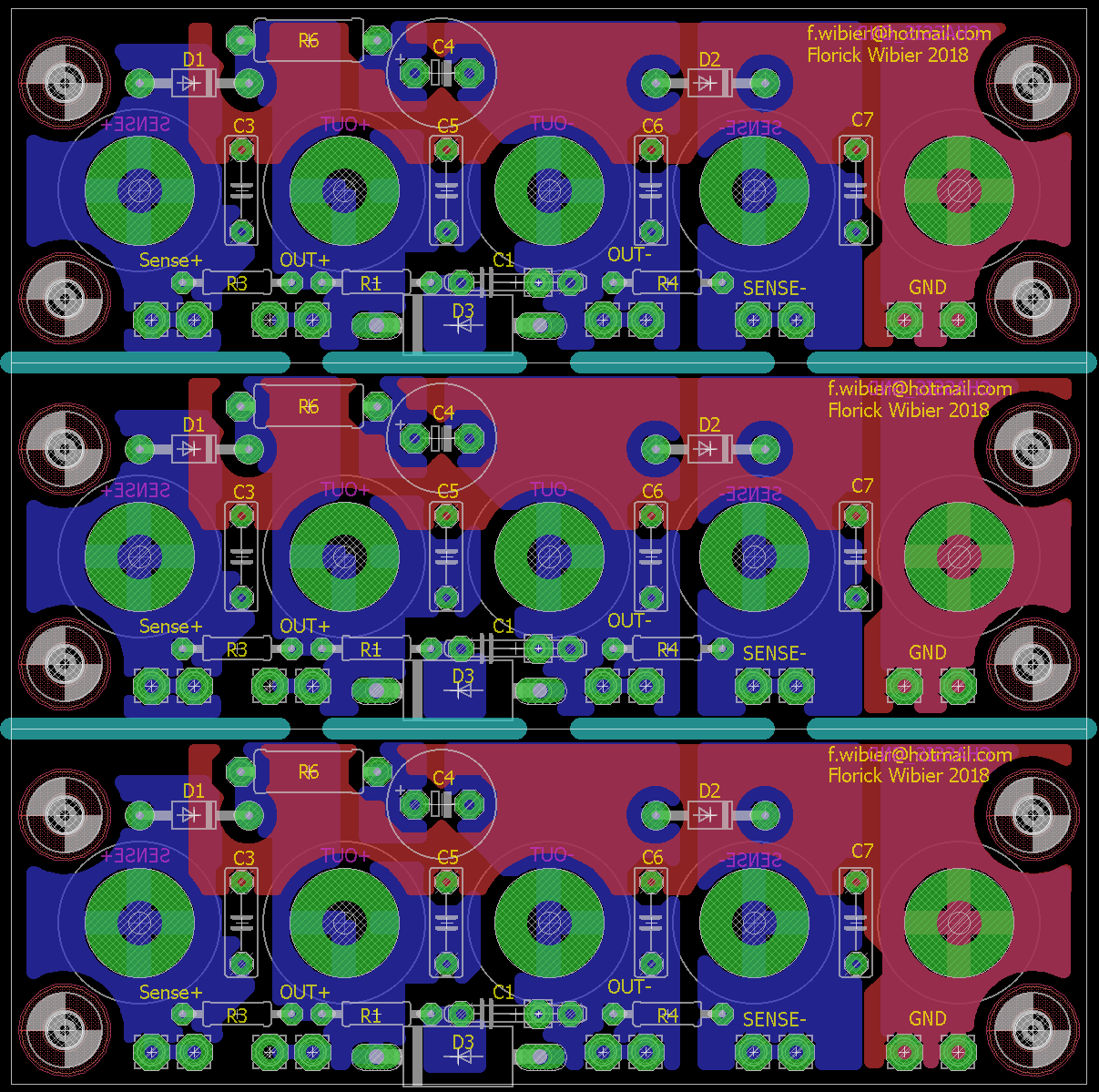

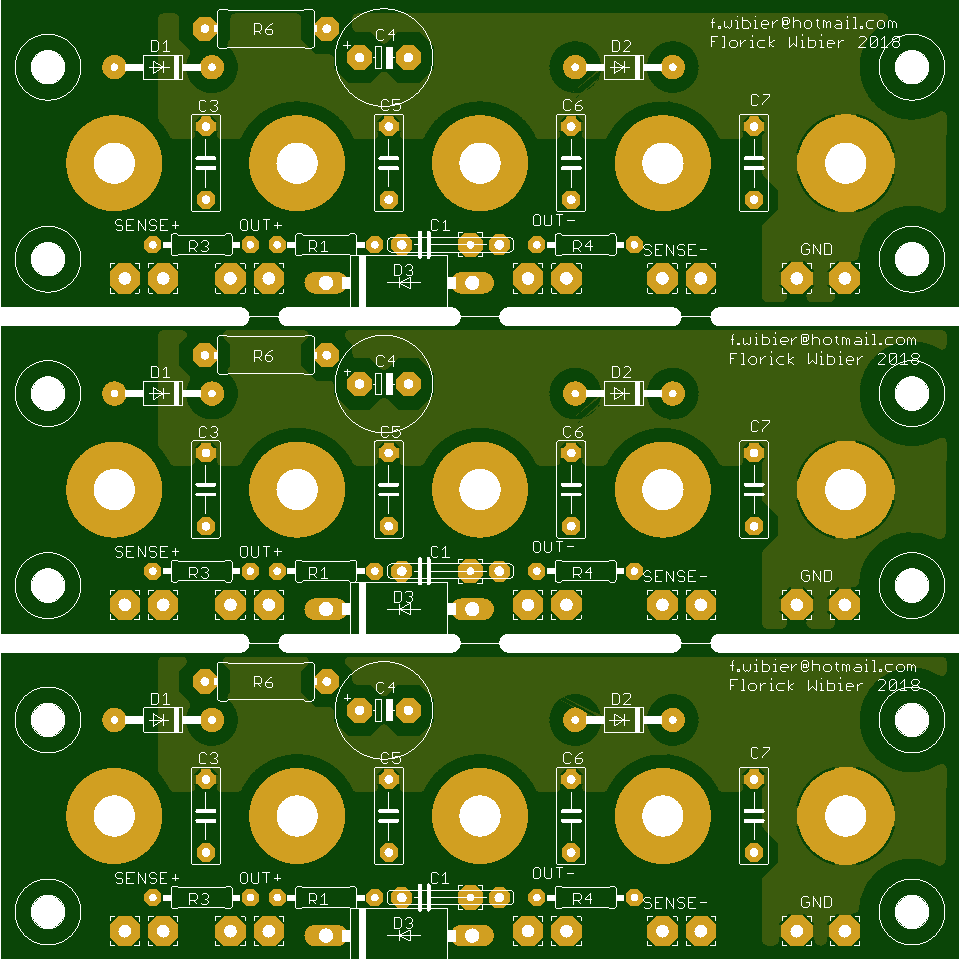

4mm jacks front panel board
This is a board for four 4mm jacks mounted on a front panel, I believe these are 3/4'' apart so a standard double banana connector fits.
Meant for supplies with or without sense connections.
there are also capactitors on the board for X2 safety capacitors to gnd.

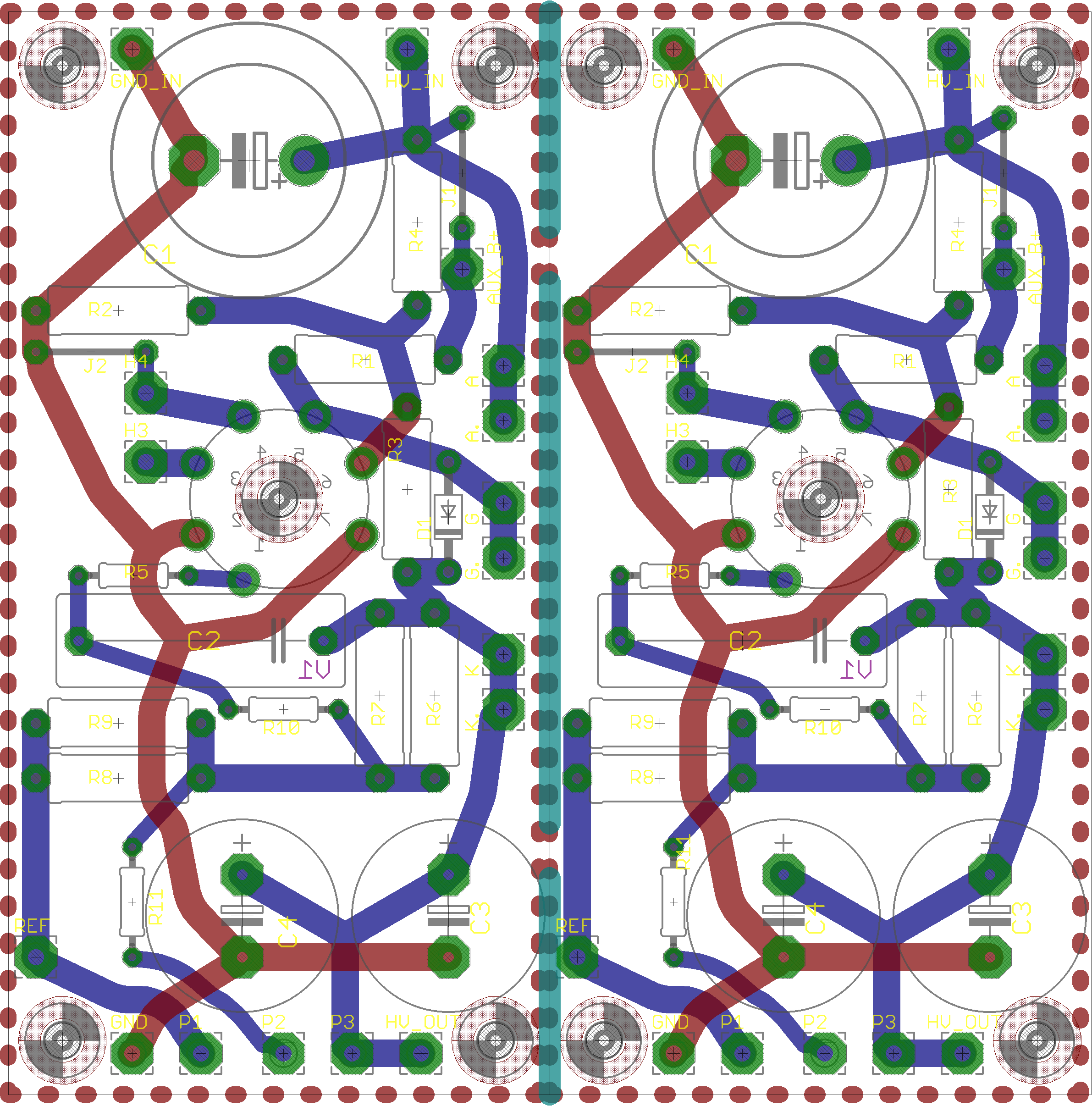

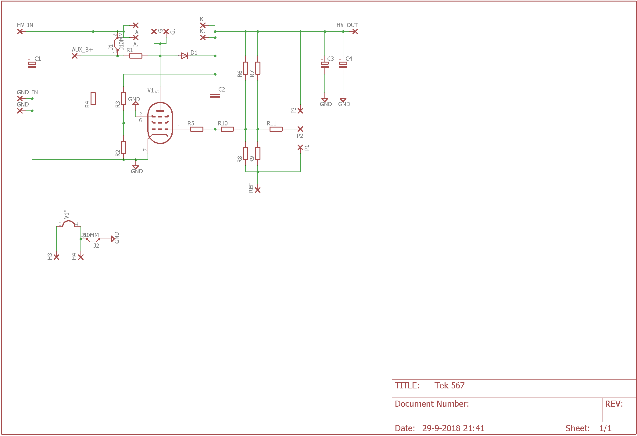

Voltage regulator positive TEK 567 based 6AU6
This is the 6AU6 error amplifier, as found in the positive output supplies of the tek567 oscilloscope.
6AU6 error amplifier, pretty straightforward.

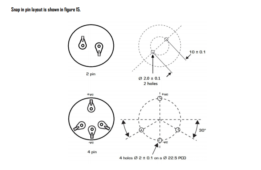

Hi v4lve lover,
this is what i mean: perhaps your eagle library have those already..
![4-pin-snap.jpg](https://is2.ecplaza.com/ecplaza2/products/4/49/493/5019251/4-pin-snap.jpg)
Hi V4lve,
sorry for late reply, this is what i have in mind....
rectifiers are off boards, and cap banks are in series, options to both 2 pin and 4 pin snap-in caps....with bleeder resistors, 5 watt size, and film bypass caps....you posted a similar one but all 8 caps are paralleled...led options to indicate power would be nice....
40 mm diameter cans max.....thanks in advance

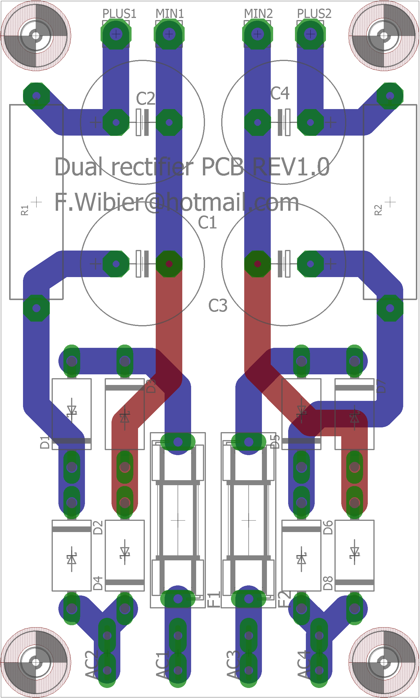

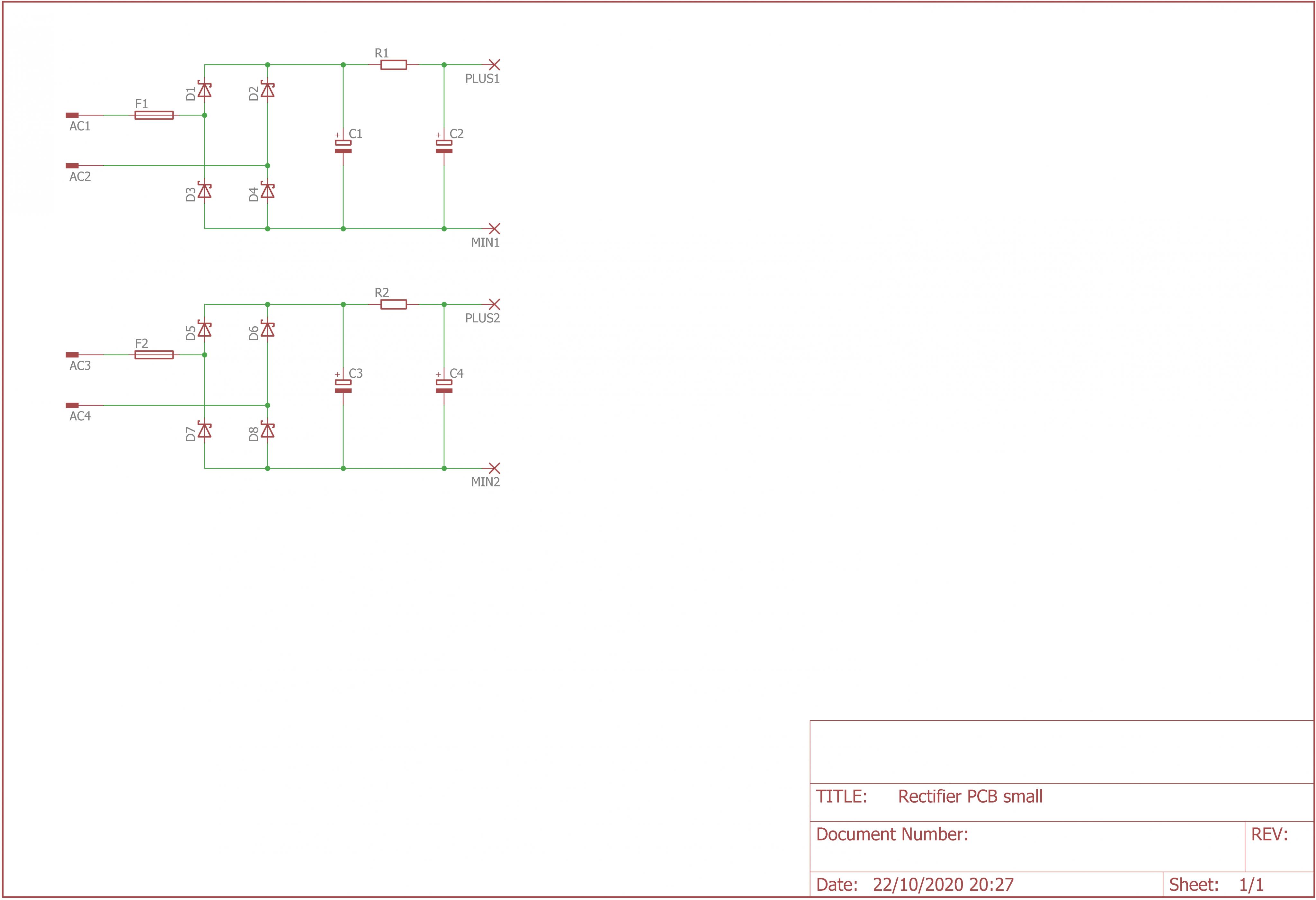

Dual power supply boards DC heaters+ regulator?
Thanks for the support.

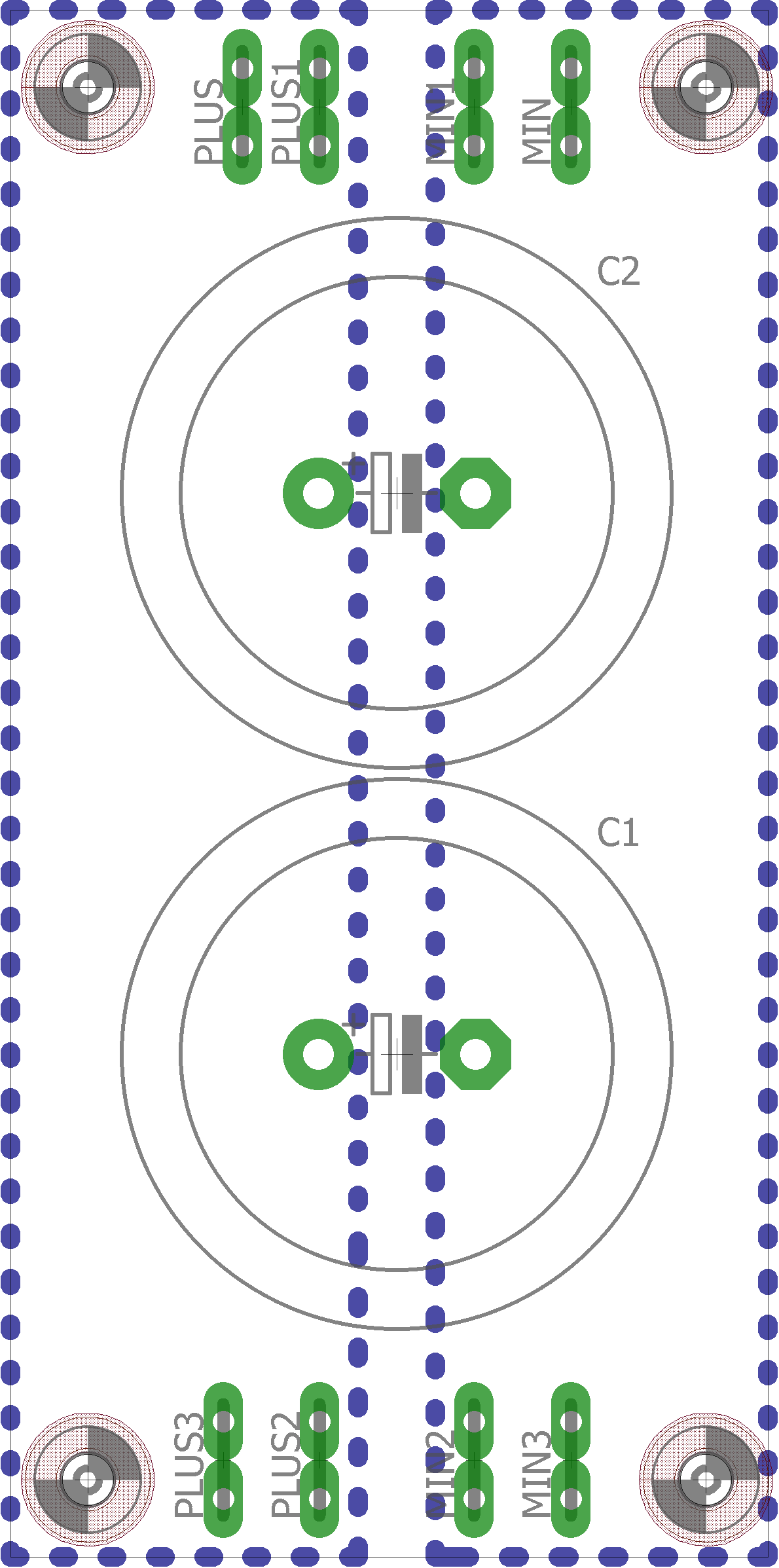

Heres another interesting board for double CRC for low voltage.
Suggested diodes for low voltage are SB540 skottkeys.

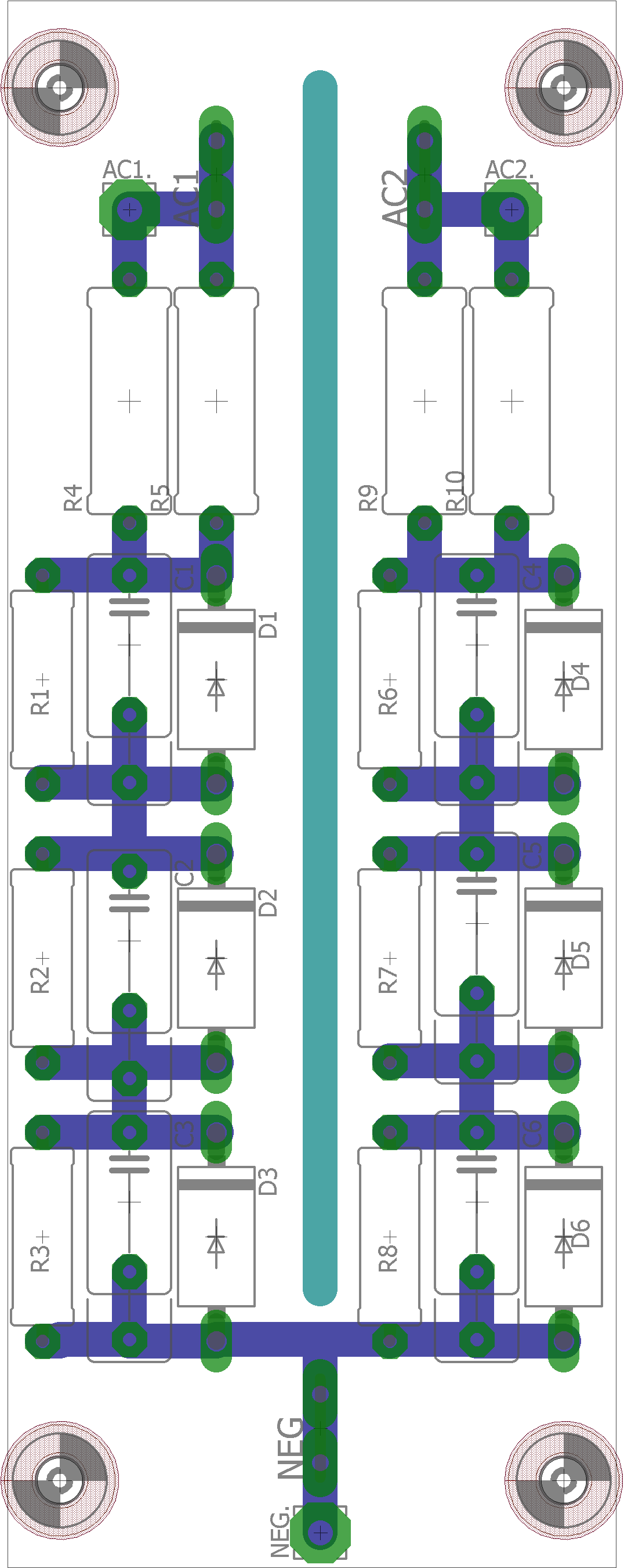

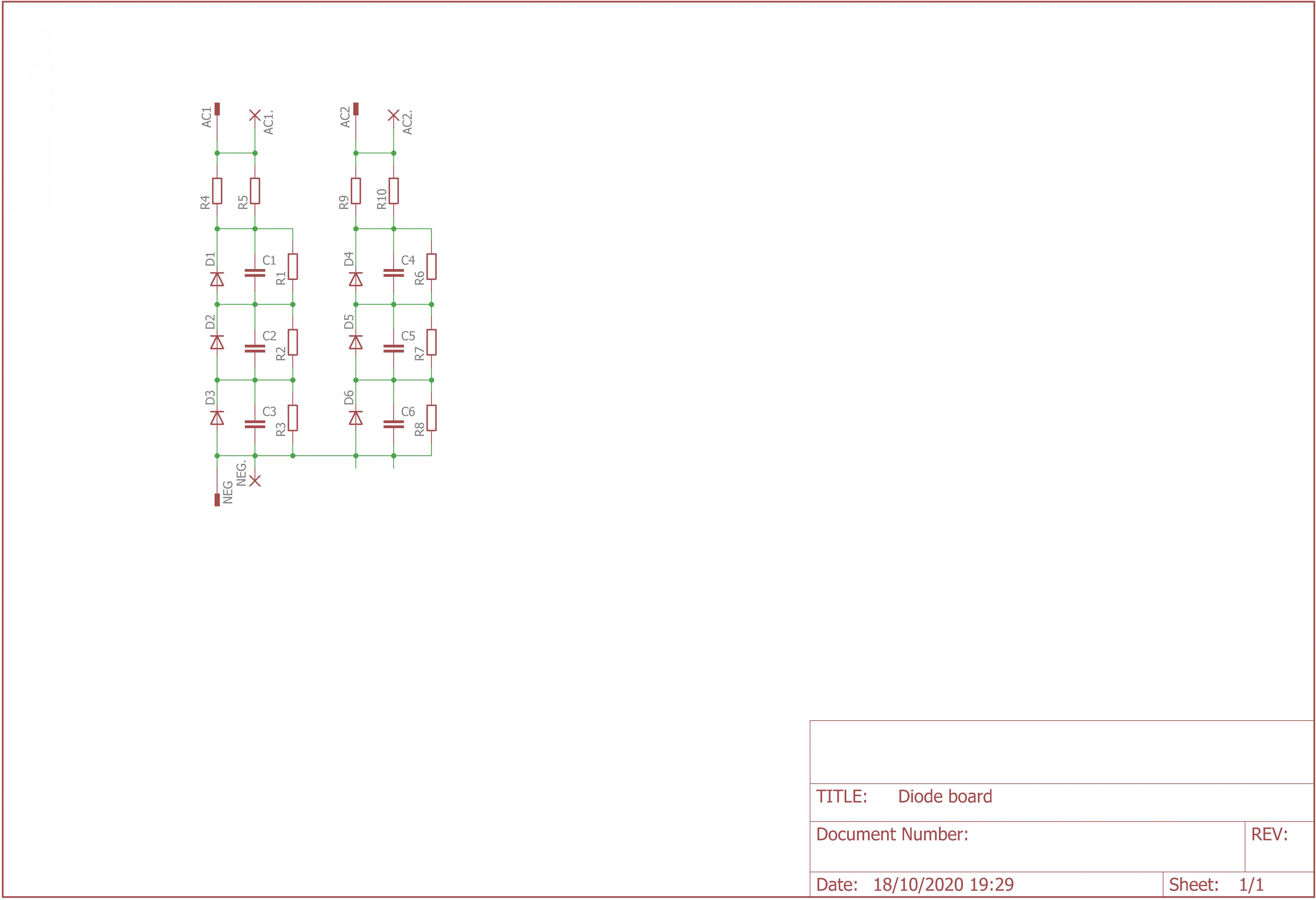

negative half of tube SS bridge rectifier configuration
These boards where meant for the negative part of a solid state tube hybrid bridge, for example EY500 X2 for the positive half rectification and one of these boards for the negative half.
