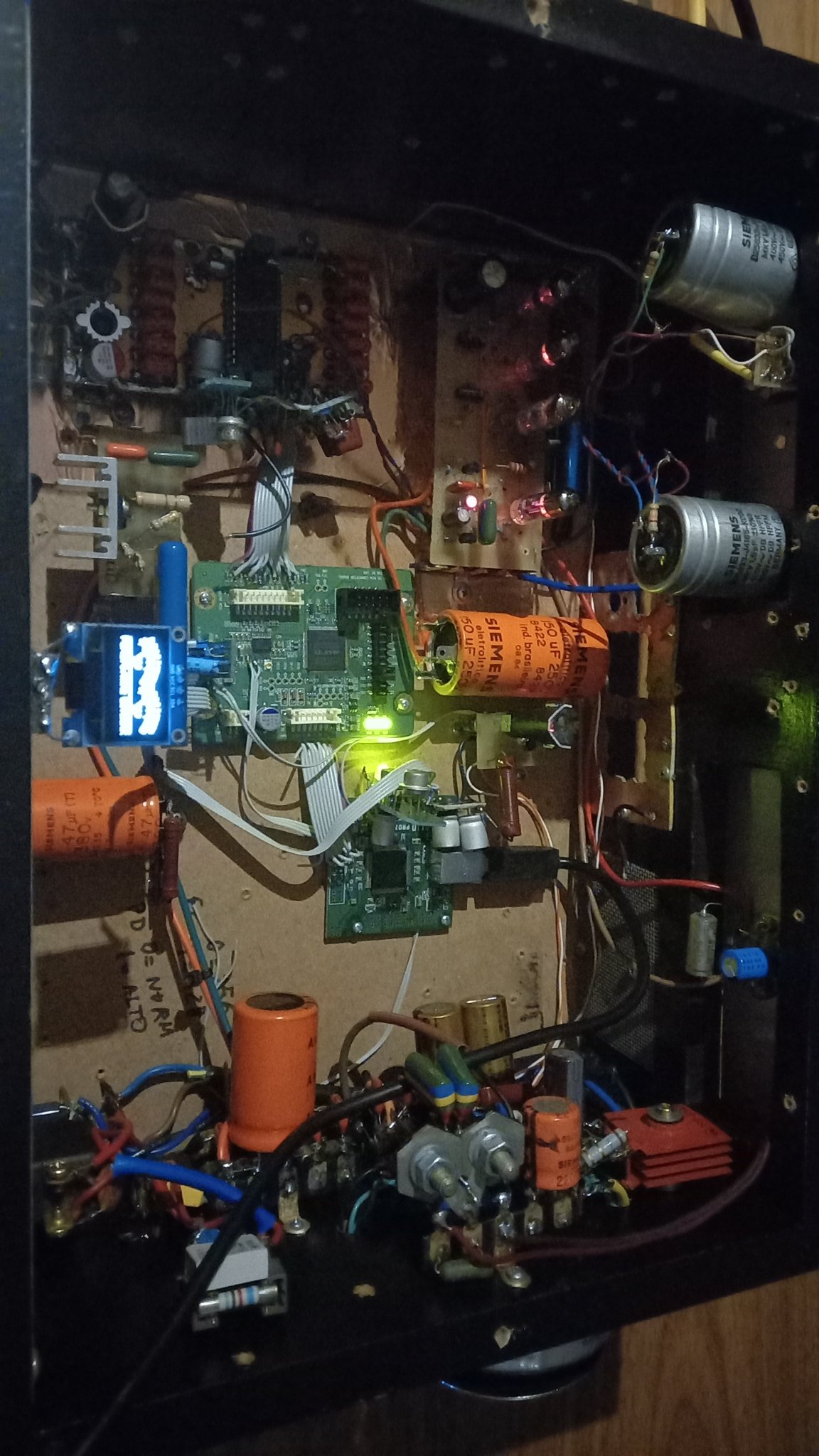

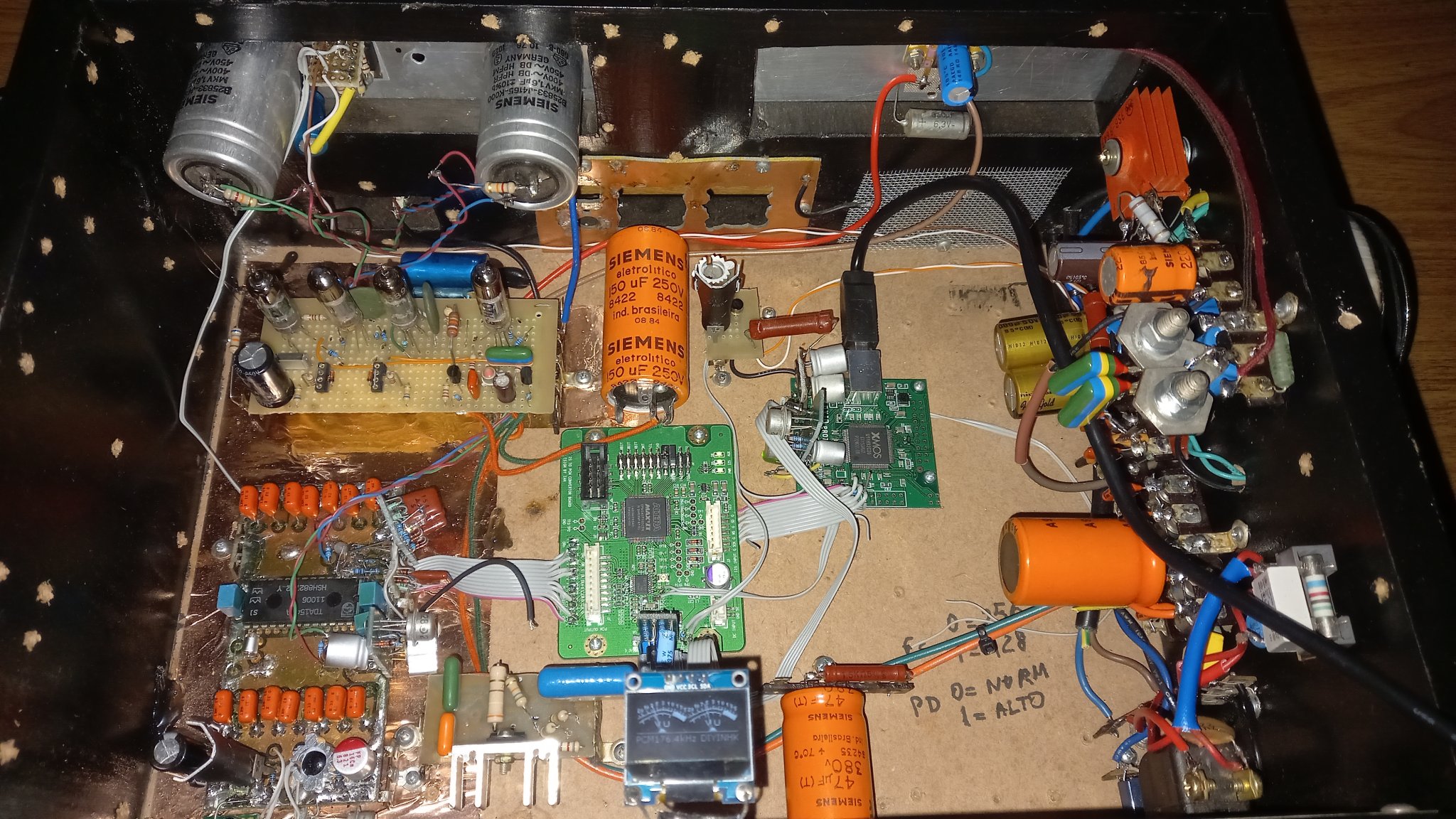

Some photos of it, below... is very messy, since I used some old parts and boards that I have, and put all toguether.
I know that the correct method to evaluate a PC digital filtering vs a on-board digital filtering is to bypass it and compare, but I don't want to mess with my PCM1704 DAC, since it have a terrible but very short air connections, with a solid ground plane and short local decouplings.
Even so, I'm haapy to hear that they have much more in common than differs; the DF1704 filtering more than suffice to me. Basically I'm listening to sum of parts differences, but get some idea. I bet that the digital filtering differences are lees than the DAC parts and topologies (the analog part differs a lot). Also is admiable how good a ancient DAC part can sounds with some attentions.
Far from scientific, but enough to me. Soon, will the time for the Valve DAC, but this I can test in a another system, the one mentioned using Stax 'phones.

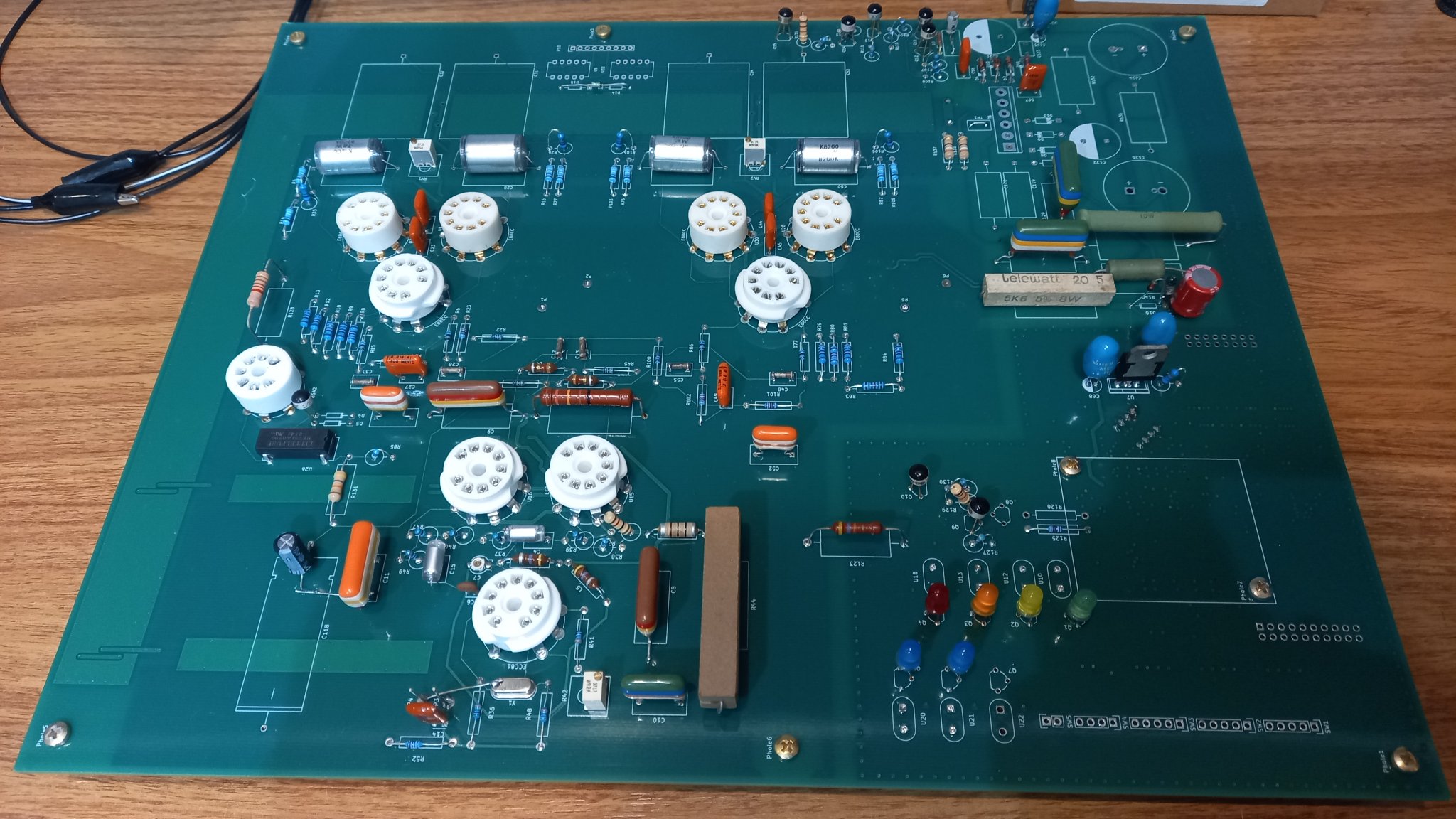

Below: some progress with the Valve DAC board:
I'm using some Tropical Fish caps, and some ancient silicon Brazilian Philco transistors for the peripheral functions.

You are the first to replace the high-voltage PNPs that normally drive the neon lamps with coloured LEDs (not the first to use LEDs instead of neon lamps). It should work well as long as the forward voltage is low enough (well below the 3.3 V high level of the FPGA IOs).

Yes, the blue LED's, I confess that I put it here without fully checking it... only remembered that I had some that worked well with near 3V (not sure if are these ones now...)

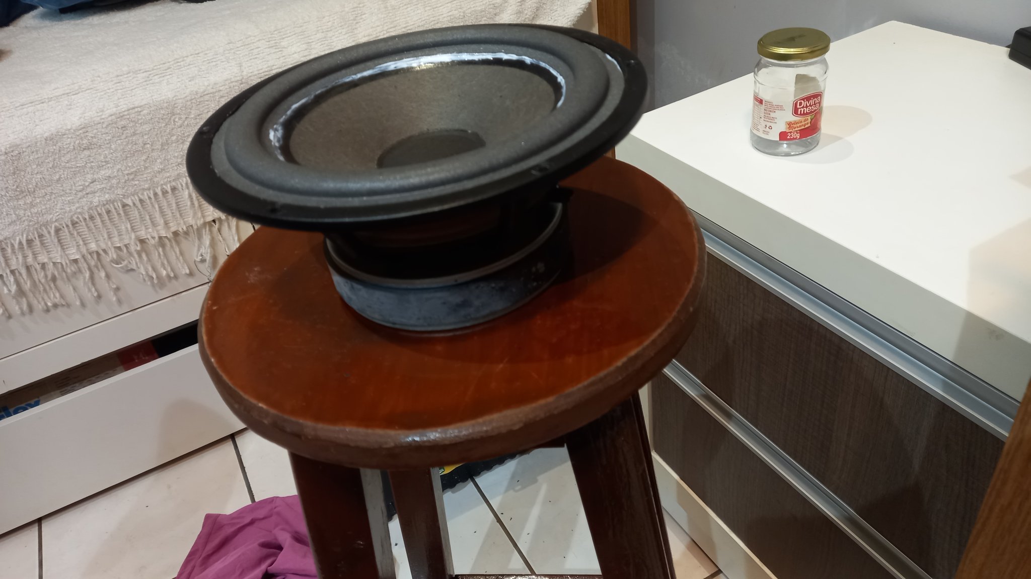

A little OT, for clarifying this post: About the JA-8008 suspension, for ones not familiar with this model, it have something gooey in the original suspension, for ultimate correct damping. I don't have this just now, but it seems to responded very well, and response in the TQWT have a crossover near 1.5kHz, so I can live without it for now.About hearing differences... recently I have various opportunities to listen my most recent DAC addition, the one with TDA1541A in NOS (for using digital filtering in the PC). Then I put it against my trusted DAC with DF1704+PCM1704, using a trafo for I/V, followed by an Aikido stage. The TDA1541 I ended using subminiature tubes for gain stage.

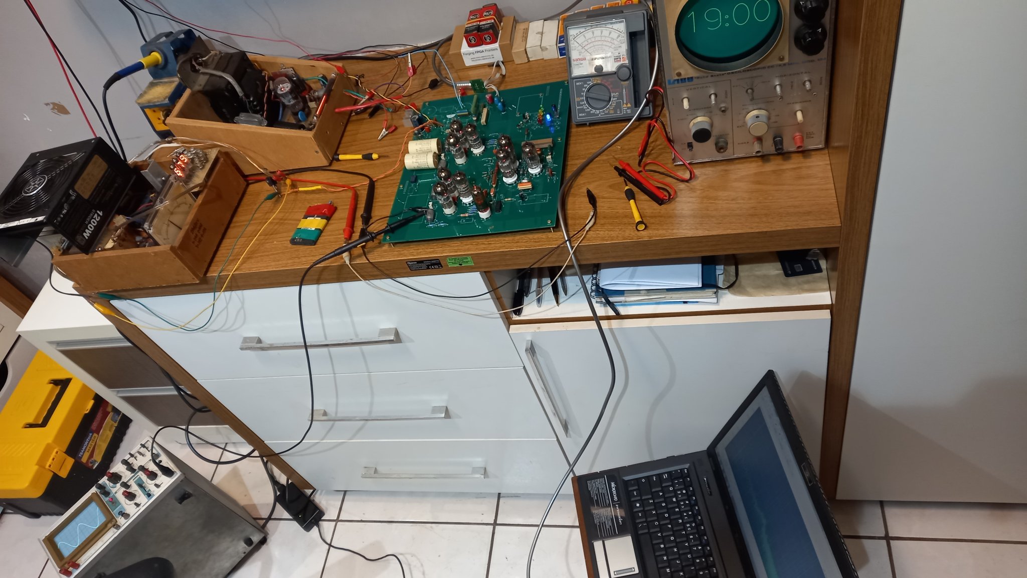

Is working!!!!!
Surprisingly (!), almost all things worked flawlessy from start but the crystal oscillator: this works only at certain trimmer's range, and with adjustment rather low (~330R in the cathodes). But I'm able to achieve the -500mV at the test point, with a little effort.
About the clipping indicator: it lighted only once for <1sec, when I'm watching it working with a very horrible recording clipping almost all time. Otherwise, it remained off.
The status LED's lights with my choice. Is normal? Or I don't understood it clearly (I think it lights only using the surprise mode)?
And, a good news, the blue LED's I'm put works with 3V3.
BTW: the heater's PSU are indicating 6.79V; I adjusted for compensating the small gauge cable test I used there.

I noticed that the waveform in the scope is good, even without the correct load. Of course, the response is not correct, due to reactance or first filter cap vs the resulting impedance.
But, about the noise: even comparing with the barely filtered out, without the filter bank, is LESS noisy than I first think. Since I'm used to measure el-cheapo China pen-drive solutions, and DVD players (years ago). Some DVD players try to filter the large noise from cheapo DACs with the sloppy 4558. Sometimes, the noise at the 4558 out is HIGHER than it's input. Hence, these things are noisy, some have a lot of HF noise.
Even DAC's like the raw ES9018 are not ultra silent, either (are better than el-cheapo solutions, but naturally, direct out will have the expected HF noise).
