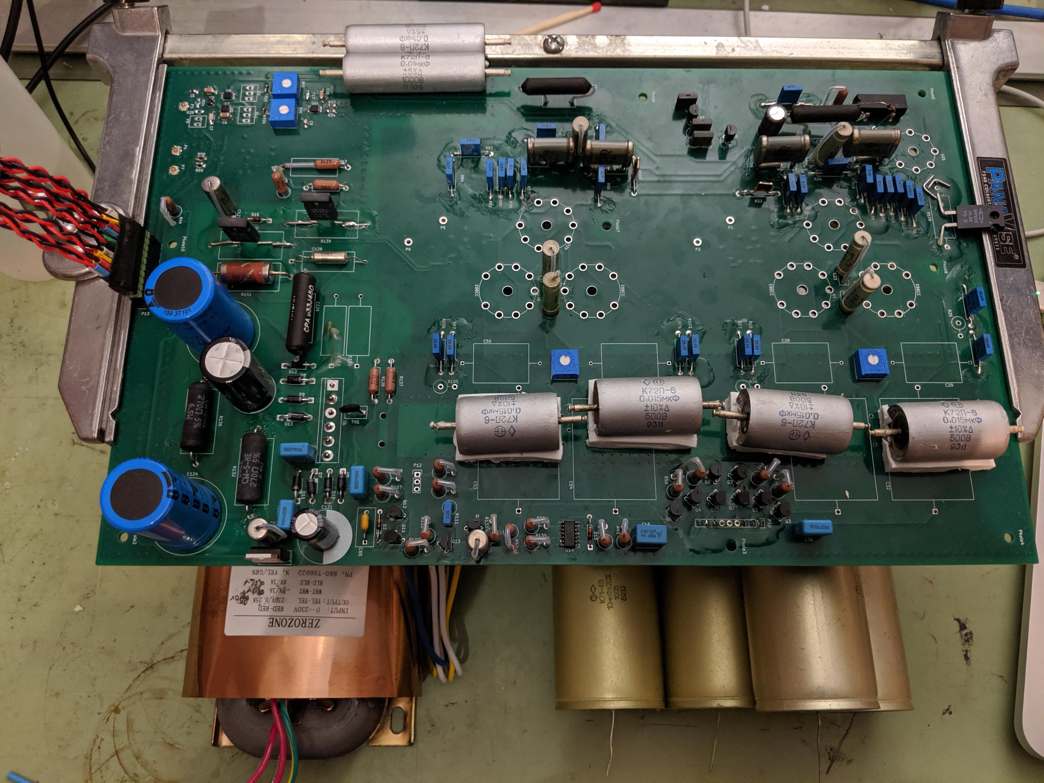

I finished a contract recently and had time to populate some of the board.
Sorry for the amount of flux. I have read your warning, Marcel and it will be cleaned from the board before testing.

Hey Marcel,
They will stay on top of the board... its the 10uf under the board that I'm struggling with. I'm never one to shy away from a challenge and those SMD's were... satisfying!

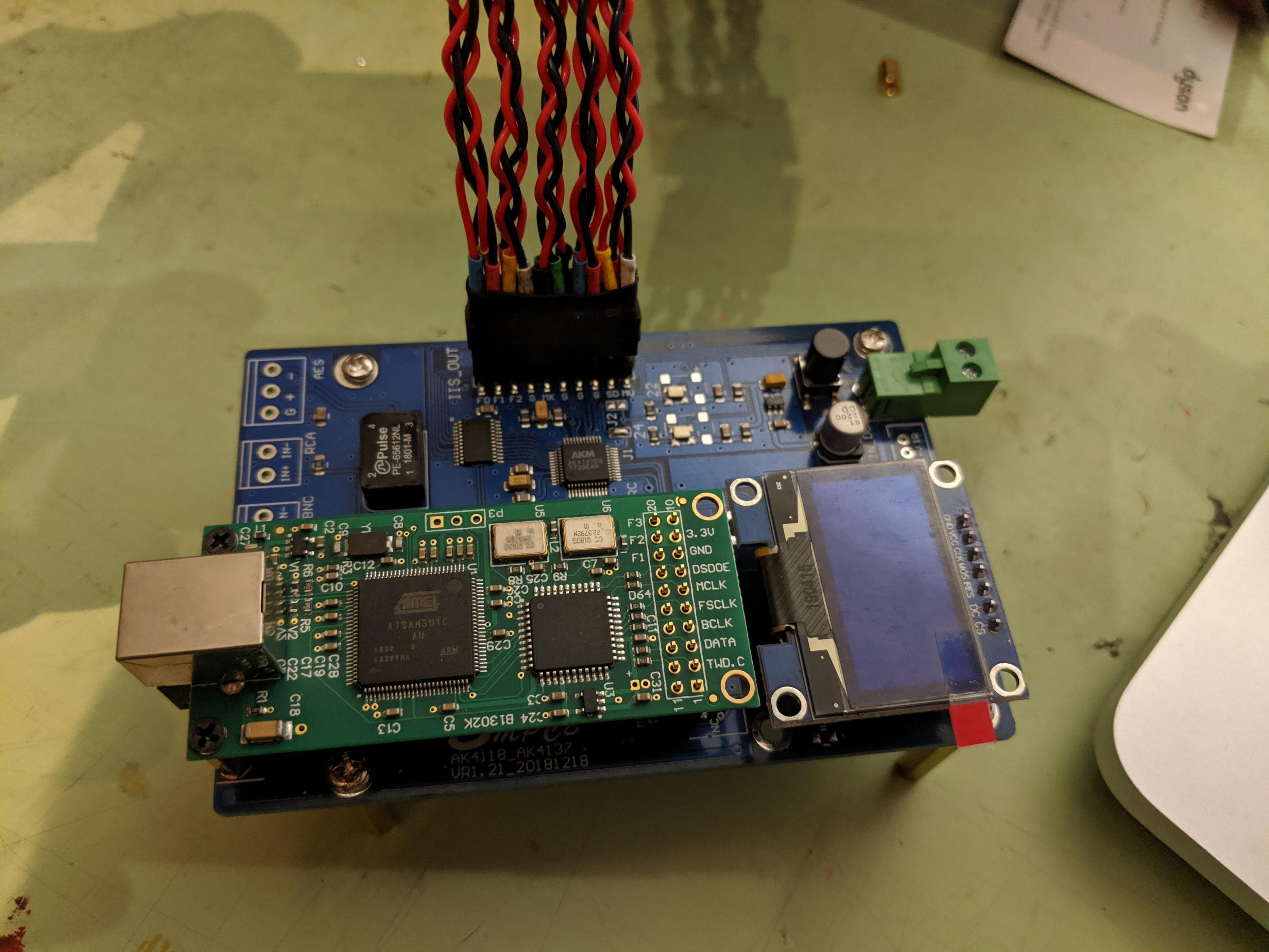

I am using an AK4137 board that i picked up in Korea to convert PCM to DSD. It recognises the input correctly but I don't have any way of testing if the DSD256 output is working yet. It's on my bucket list of things to do.
Ah, I didn't realize those were the output coupling capacitors. I thought my capacitors were big, but they are nothing compared to these!

It looks like it will be a challenge to mount those Russian 15 nF filter capacitors...
There is smaller available: FT-1...
