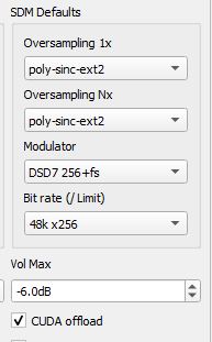

You use HQPlayer, right? Are you on version 4 or 3? I'm still at 3, I mostly use xtr and polysinc ext2. XTR seems to add a bit more "bite", sometimes that's necessary. I'm curious what you'll end up with.

I have HQP3 and an eval copy of HQP4 - I like 4 and will have to purchase a licence soon. At the moment I've settled on the settings below but will explore more. I don't use the HQP volume control at the moment as my HPA takes care of that.
