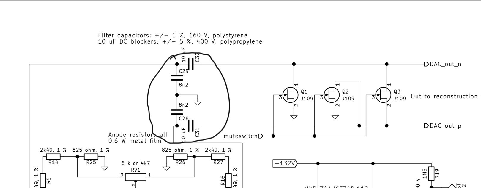

I was seeing problems that aren't there. I just looked up the 3A5 datasheet ( http://www.r-type.org/pdfs/3a5.pdf ) and apparently the CD enhancer II circuit is designed for a 0 V input common-mode voltage. Apart from adding those 180 ohm resistors to ground, you don't need to do anything special to interface the valve DAC main board with the CD enhancer II circuit.
(For the record, using termination resistors to a positive supply at the DAC output would have been impossible anyway because of the way the mute circuit is designed.)
Ahh cool. Do I still need the reconstruction filer to precede it?

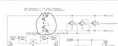

Raj1, you will need the two filter capacitors on the main board, but you can probably do without the rest of the reconstruction filter. That is, I understand from the website that you linked to that the CD enhancer II itself is meant to be used as a reconstruction filter for sigma-delta DACs.

Yes, but I'm wondering if the output level of the Valve DAC (before the reconstruction stage) is higher than the DAC chips the circuit was originally designed for?
Neglecting transformer losses, if any, the peak output voltage is about 2.5 mA times the parallel connection of three things: the anode resistors of the upper E88CCs, together about 11.2 kohm, the termination resistor, and whatever load you get from the amplifier that's connected to the output. With an 806 ohm termination resistor and a 10 kohm amplifier input resistance, that's about 1.75 V peak or 1.24 V RMS.
Apparently the CD enhancer II is meant for lower levels, that's why I recommended using two times 180 ohm = 360 ohm termination.
