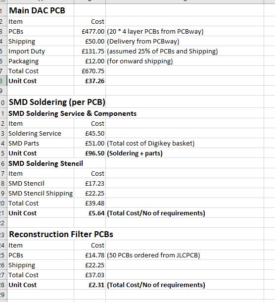

Now that I've placed the first orders I have some firm costs and I've also made some assumptions to hopefully get somewhere close to the final costs. I've attached an excerpt from my spreadsheet showing my workings on the costs. For the Reconstruction Filters and SMD Soldering, short of some unforeseen surprises I thing the costings are complete. For the main PCB I have made some 'negative' assumptions to try and give a picture of the potential final costs, such as factoring in having to pay import duty and the cost of delivery from PCBway.
Anyway, take a look and please ask any questions you may have.

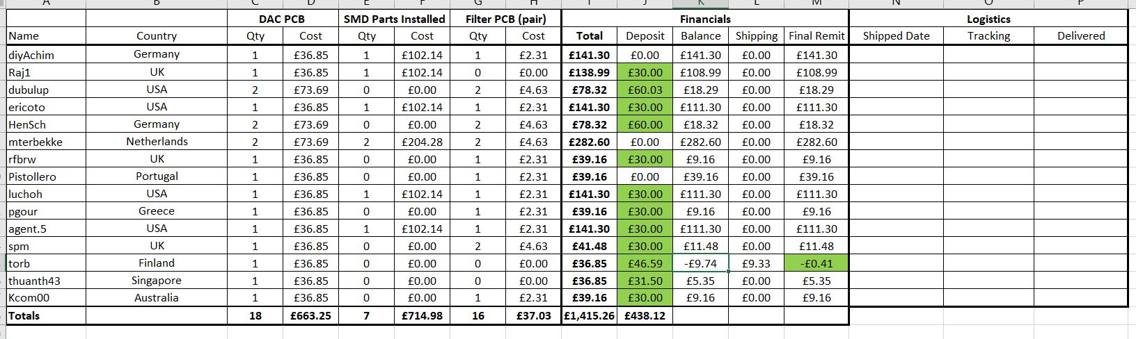

Having received some more deposits overnight, this morning I have placed the order for the main DAC PCBs. Shipping was a little less than I had estimated (£44 vs £50) so the unit cost of the PCBs has dropped by a small amount.
The production and shipping schedule suggests that I will receive the PCBs around mid-September. I will send my spare PCB on to torb in the next day or two (and replace it when the 20 arrive) so we'll hopefully have another build underway before too long.
We just have to wait now. I think the only other item I have outstanding is to check and publish the BOM/Dgikey Basket for the through-hole components I used for my build - I will try to get that done over the weekend. Anything else you chaps need?

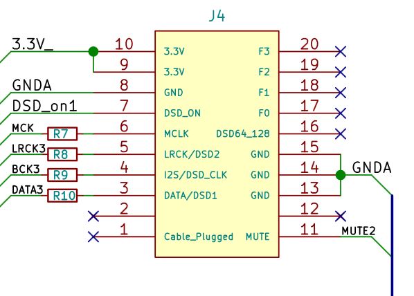

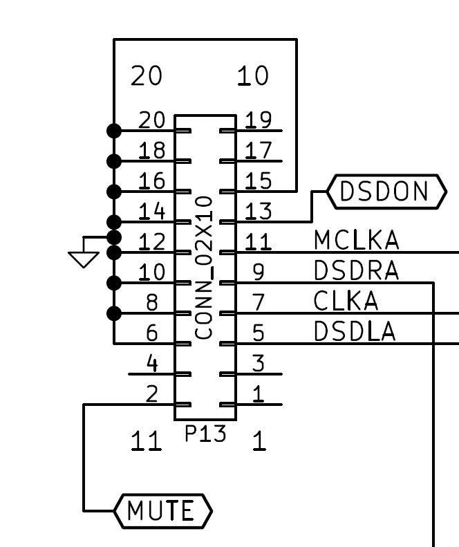

I've attached screengrabs from the schematics (yellow=reclocker, white=Valve DAC). It's slightly confusing because the header numbering is different on the two but if you renumber one or the other it'll all fall into place.
I installed my BBB/reclocker combo under the Valve DAC board, positioned so that the Valve DAC plugs straight onto the reclocker header (you just need to experiment to get the relative heights of the standoffs right). I have a mechanical drawing with the drill holes for both the Valve DAC and BBB stand-off drill holes correctly positioned if that would help?

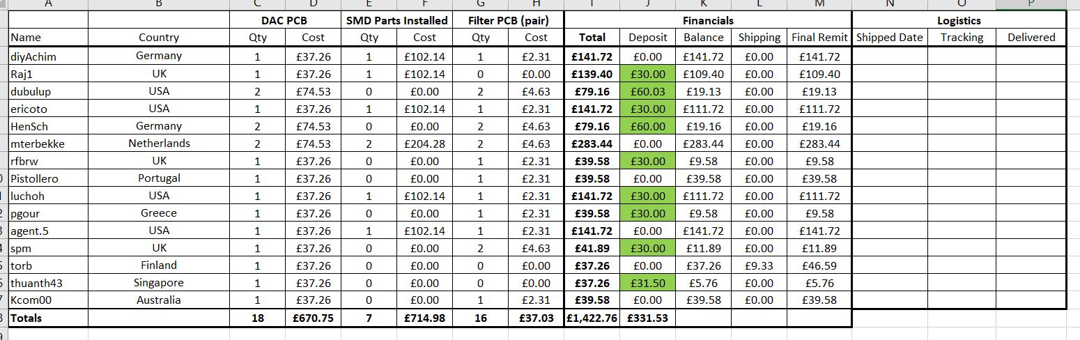

I've received deposits from everyone (except for one subscriber who made me aware that he's away until early September) so all good. Thanks everyone.

It looks like I messed up with the DSD64_128 and FS0...FS3 pins. They are grounded now, which doesn't matter when you use the reclocker, but matters when you connect an Amanero Combo384. A workaround is to remove these pins from the header.
According to https://www.amanero.com/drivers/combo384-D.pdf , DSD64_128 is open drain, so grounding it does no harm. That still leaves FS0...FS3.
Maybe I used this datasheet by mistake, which has them all NC: https://www.amanero.com/drivers/combo384-D3.pdf
