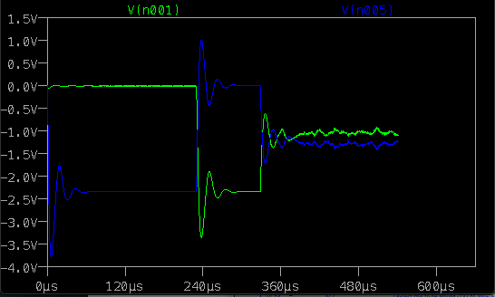

So here's a working version - still needs more work but the digital piece is operating.
In the attached zip are as set of sym and subs - all neatly in their vac- separate files to not mess up your LTSpice installation. Simply add to your libraries. Also the asc files for the valavedac using e88cc and the 74 testing asc. It should work on a standard original LTSpice install with the provided files.
The behaviour:
* at about 130uS you'll see the first bit toggle
* at about 300uS the digital flops starts working
The 74 implementation looks for -132 and -137V so the flip is caused by the initial voltage drop below those points. Once operating it runs toggling away.
I've still not entire checked it all but I thought I'd upload for those following.

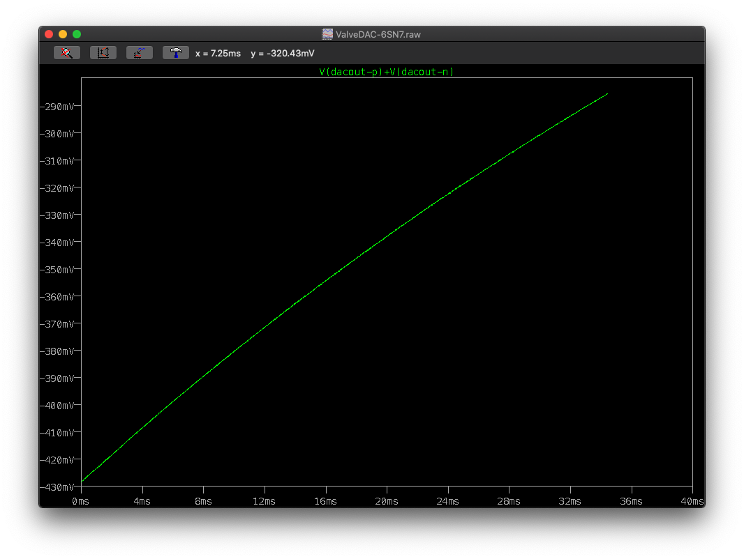

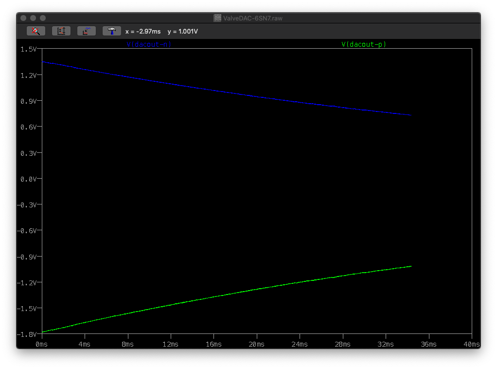

A full 6SN7 ValveDAC running with DC Servos - I'll leave this running for a bit and see what optimisations can be done. I've attached the V2 zip with updated tube library (including 6SN7 and 6AS7) and the updated valvedac asc file.
Not bad on the initial attempt - I marked a location with the cursor, seems to be about 62mV out at the moment. I suspect this will change with some more current running. As the .save statement is commented out, the system is recording all the voltages, current etc - the run data file is up to 9GB atm! If you change the .save option to a directive then the runs will only store the specified data - an output p and n run is a lot smaller (order of a megabyte). One last point - if you remove all the traces (don't worry the data is still recorded and can be interrogated later) the run will go about 3x faster.

V3 update - this has some logic fixes, better voltage and current settings, a better behaved model. Zip attached with updates.
I'm starting to get the point of needing a second or so 1Khz sine wave in DSD512, convert it to a data file and run the signal generator of it. I think I have the outputs around the wrong way but it's working way better than it was yesterday!

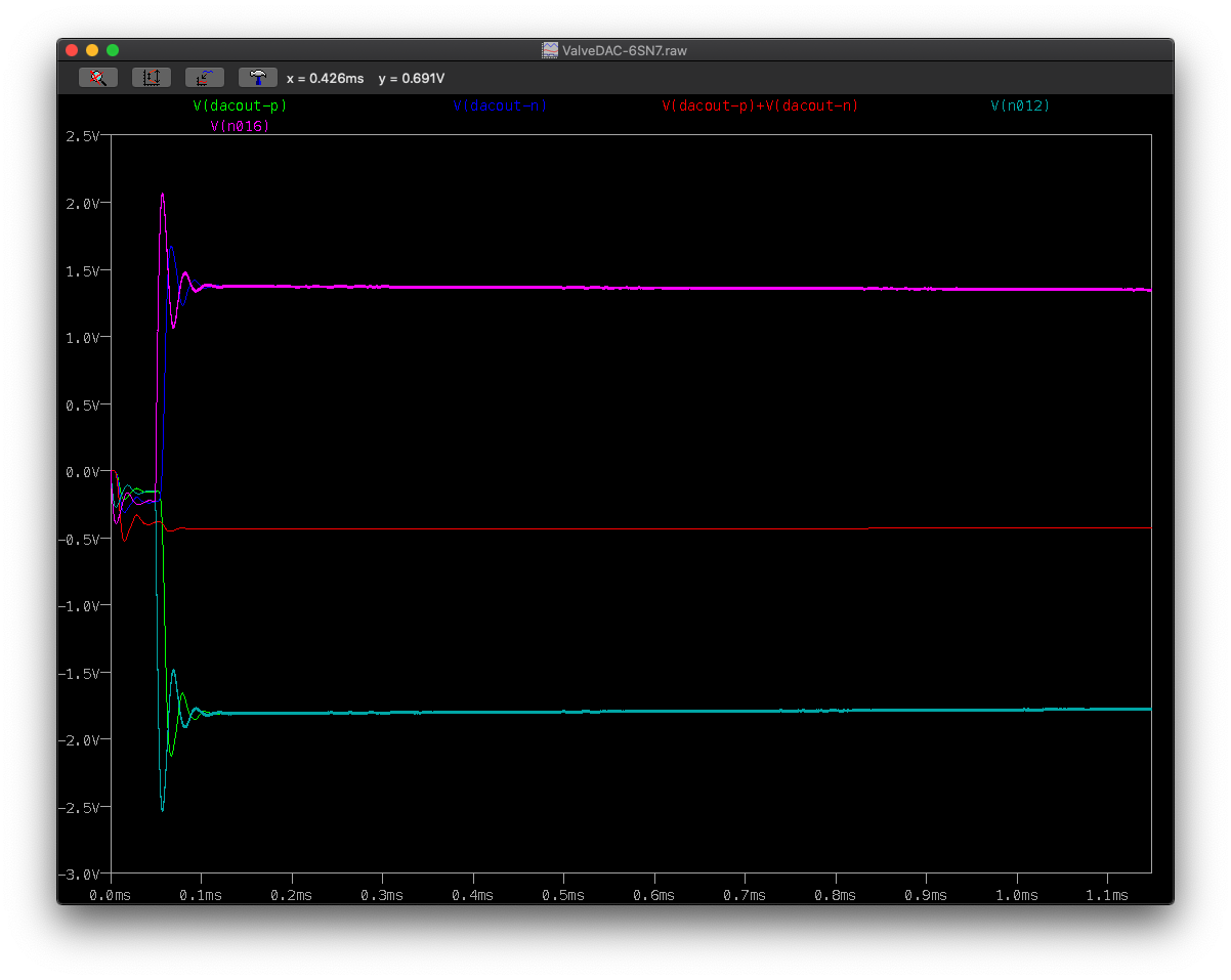

This is without the DC servos running showing pre-and-post filter:
![Screenshot 2020-12-06 at 18.59.13.png Screenshot 2020-12-06 at 18.59.13.png](https://www.diyaudio.com/community/data/attachments/828/828077-76ec6988d54f1f9c016ea7b1b2b7d336.jpg)
