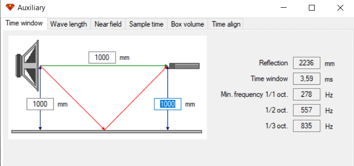

Ah, i was triggered by the 13cm. Floor reflections is for sure present in that measurement. Hmmm, why not so present in the felt version, interesting. Will try to set up the vituixcad setup like you did.I think its not edge diffraction, delay is 1,13m so 113cm, tenfold distance to edge. It is path length difference so in addition to path length from DUT to mic. This is in range of path length difference for a floor/ceiling bounce with speaker roughly mid way of the room height in typical european home and microphone 1m away from speaker. Basically some object ~1m to side, up or down, of the DUT while measuring.
Attached is demonstration of 1.2m path length difference from floor. Did you have pillows/mattress on the floor between mic and dut, and DUT and mic about 1 meter above it? might be it an dperhaps shortening window when you convert IR to FR could get rid of the reflection.

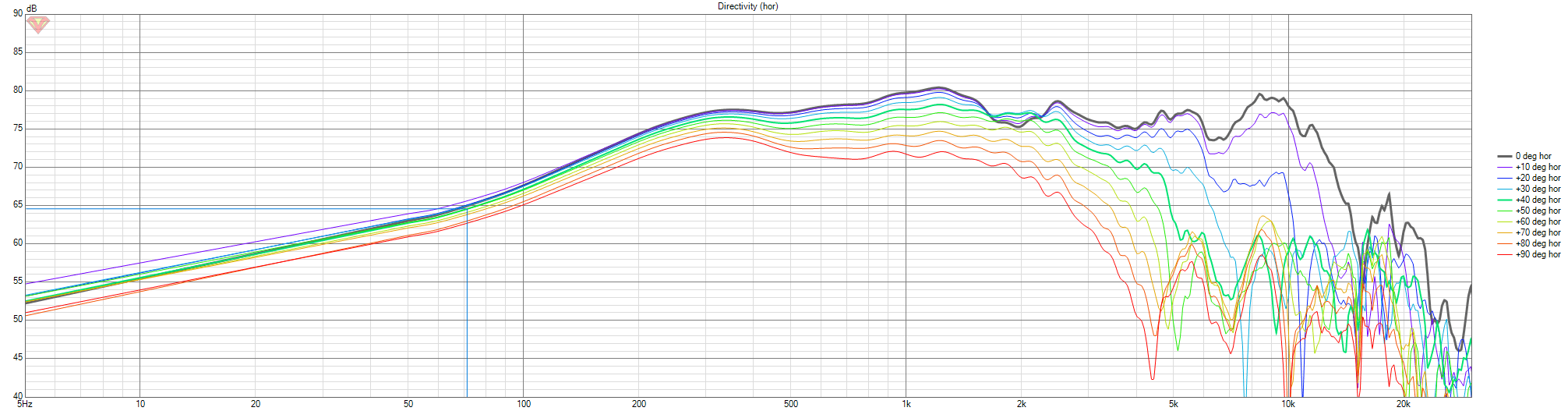

Follow-up: I did a fresh start and used the same ref-time for both measurements. Set up in VituixCAD also listening distance to 1000mm (measure-dist), and highlighted the 40' off-axis response (nice feature of VituixCad, i change the selected measurments of driver, and the highlighted response remains).
FELT:
NOFELT:

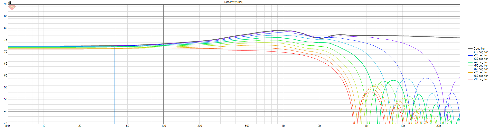

Ideal-Mid-105mm-90Difhor-nornd:

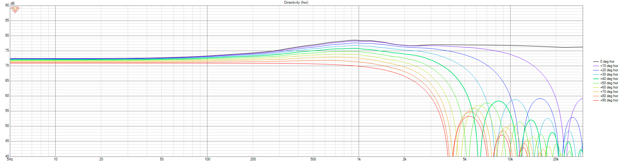

Ideal-Mid-105mm-90Difhor-40mmrnd:
The directivity increases with felt, so also the amount of floor-reflection reduces a bit
Specifically the response in the first 40 degrees hor is much better, reduced diffraction effect i assume for the moment.
At higher of-axis angles of course the floor reflection is relatively stronger present in measurements.
The dip at around 1700 Hz most likely a interference from the 2cm felt creating a "open ended cylinder" and resonance calc for such cylinder get a ref-freq of ~1700 Hz. The peak at 2500 Hz is presumably a negative effect of the protective grille.
So all in all the difference with Felt (absorption sheet) on the baffle is not trivial, but more testing needed to get the most out of it.

The numbers might add up but to me it just looks like the basic baffle diffraction response due the placement of the driver on the baffle. A similar thing is seen in the idealized response just not as deep. The felt modifies it but does not cause it. What the felt does do is clean up the on / off axis differences around the baffle diffraction signature, something that creating a smoother baffle transition also does.The dip at around 1700 Hz most likely a interference from the 2cm felt creating a "open ended cylinder" and resonance calc for such cylinder get a ref-freq of ~1700 Hz. The peak at 2500 Hz is presumably a negative effect of the protective grille.
Could well be, need to test. Btw if i change the cylinder length to 0.9-1cm (suspension + grille) it coincides with the dip of the no-felt. Or the felt effect is that of a longer distance to edge, together with some radius, thus lowering the frequency of the dip. Test goals definedThe numbers might add up but to me it just looks like the basic baffle diffraction response due the placement of the driver on the baffle. A similar thing is seen in the idealized response just not as deep. The felt modifies it but does not cause it. What the felt does do is clean up the on / off axis differences around the baffle diffraction signature, something that creating a smoother baffle transition also does.
