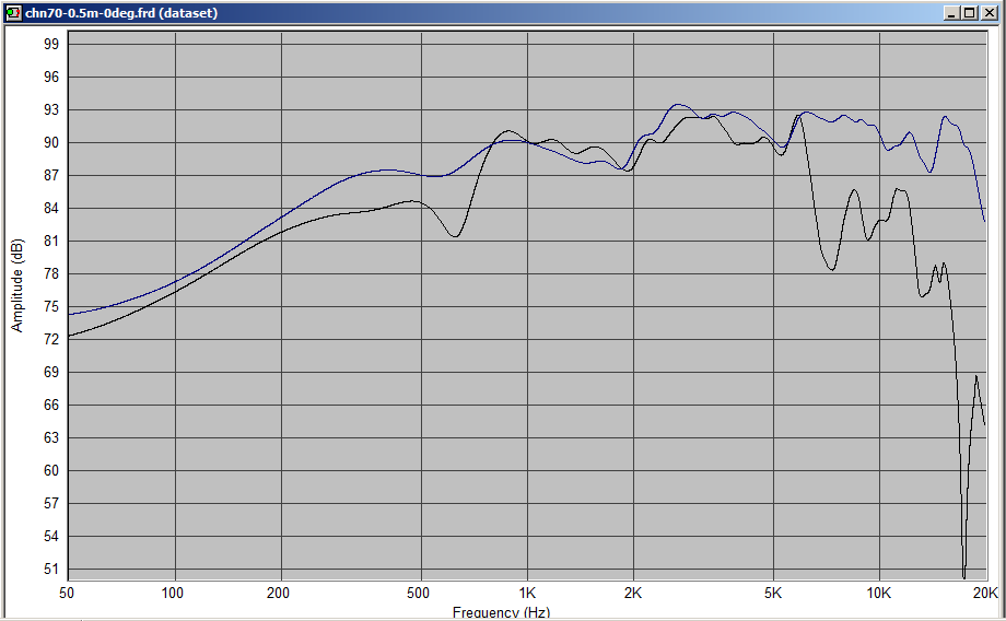

I'm going to put up a chart which has X's CHN70 measurement compared against his Vifa Measurement. I've scaled arbitrarily in the Y axis to get them to line up the way I wanted to do it.
The thing that struck me was how similar they were between about 800 Hz and 5.5Khz. I suspect that the baffle/cabinet are having quite an effect in this range. Yes there are differences, but the major deviations from flat seem to be fairly consistent.
I would ask the question, how much of this is the drivers, and how much is the cabinet/baffle/other unknown factors?
I wasn't going to put up any comparisons, or draw conclusions. But I do think that this needs to be pointed out.
Do I think that X's measurements can be compared to the manufacturers datasheets? NO.
Do I think that X's measurements are of no use? NO.
Do I think that there is room for improvement? YES.
Do I think that the ******* match needs to end? ABSOLUTELY!!
That goes for BOTH of you!
Tony.

To add to what Tony has put (and thank you!), it'd be really good to know that these are all representative devices. (We're seeing a well made and appropriately caveat'd measurement, for sure, but of one device)
Given the focus on the CHN70, it'd be really nice if some other folks could corroborate or refute what's been measured. That would hopefully moderate the back and forth.
Admittedly, that's an expensive proposition. (I'm certainly appreciative the effort thus far)

Thanks for the measurement Freddi. It confirms the salient features at issue.
I'll have to run one more sweep then substitute a 4fe32 to see if the ripple is a function of the horizontal centered driver cutout (or white Styrofoam baffle vibration-?). My camera got lost during a power outage so can't show the shoddy setup.

From what Mark said about the design of this speaker the FR measures are in general pretty consistent with the design goals. CHN70 was designed specifically for the Japanese market and the deviation from flat-response is as requested by the end-users.
That this driver made it to North America is down to Madisound wanting to take advantage of the price point.

If you have a look over in X's subjective thread, you will see that in his setup the chn-70 was very flat between about 800 hz and 5.5Khz, IMO probably the flattest in the bunch. It deviates substantially from flat outside this range.
This in my opinion makes it unsuitable as full range driver (except maybe for a particular audience as Dave points out above). I do think though that it has potential to make an excellent midrange if crossover over quite high.

Even from the plot you posted it appears that the TC9FD is flatter over 800Hz and 5.5kHz. Also, when using this as a mid, the responses below and above the XO points should be smooth for an octave below and above the XO point.
