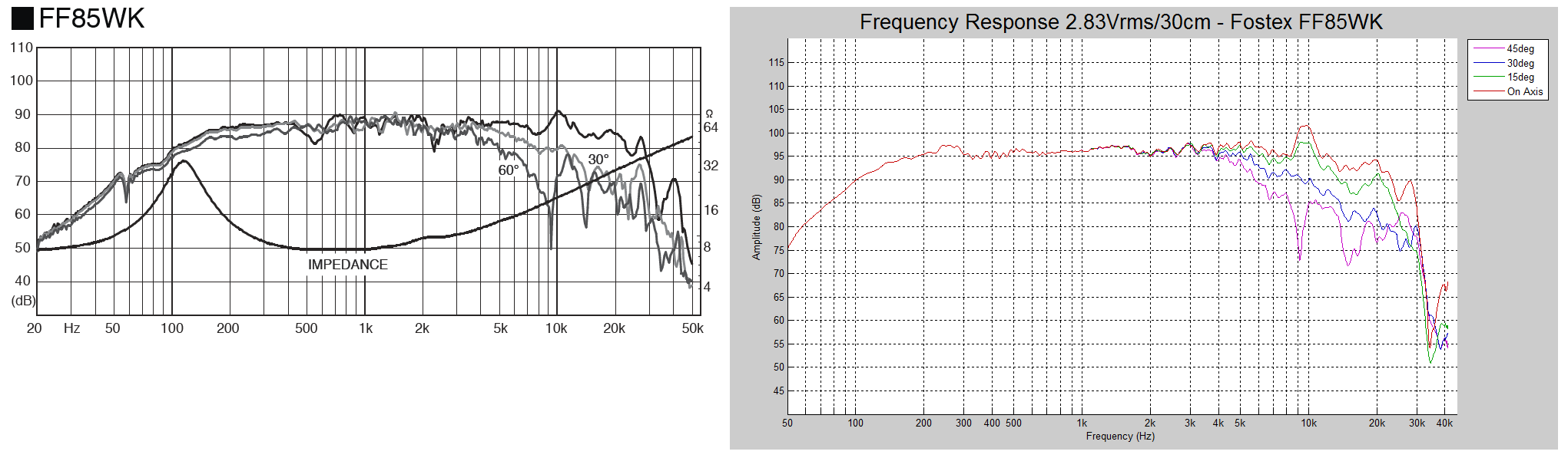

Thanks. HD is -40db 2nd and more for 3-5. Seems fine to me. I didn't hear any distortion problems except in the bass frequencies where I wouldn't use any of these 3" full Rangers, personally.
Nice site. Why merge the NF and FF so high? And why not make the FF more like 1m? Seems unusual to do it that way. Maybe even inaccurate.
Hi Ryan regarding inaccurate see below compare to Fostex datasheet, think TTM's data look pretty :cool:.

I think it may be that the FF series don't have copper shorting rings on the motor. The plastic frame on the TC9, TG9, P830986, P830983, SB65 don't seem to give them a problem with lower HD. I think the paper cone without any damping coating on them may be causing excessive vibrations which lead to increased HD. Agree that any effort put into damping a stamped steel basket should help reduce vibrations.
If there were a resonance problem with the frame it would present itself only through a narrow band of frequencies. If there were an airflow problem with the frame it would only present itself at low frequencies.
The reason for the higher level of NLD seen in the FF85WK across the entire frequency range will be because the motor isn't as well designed as competing units. It's not something that can fixed by a trivial modification, it pretty much requires that the entire motor be re-engineered. It's still not a terrible speaker by any means and the distortion is still much lower than many other popular cheaper drivers. I can see why people would give it subjectively high praise, because the frequency response is already close to flat. That said, there are other drivers that represent better value for money if you are prepared to apply some EQ to them. For instance, I don't like how the TC9/TG9 sounds without EQ, but i can recognise that with some work it is has more potential than an FF85WK.

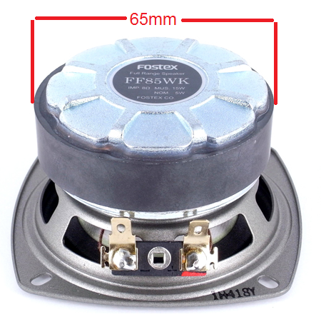

Its just so small and by that could be very rigid and stable even its stamped stell basket, with a :) can we say terminal spades this driver have so huge a area compared the driver that if anything vibrates and needs damping it must be them, EQ for the rest or what.
