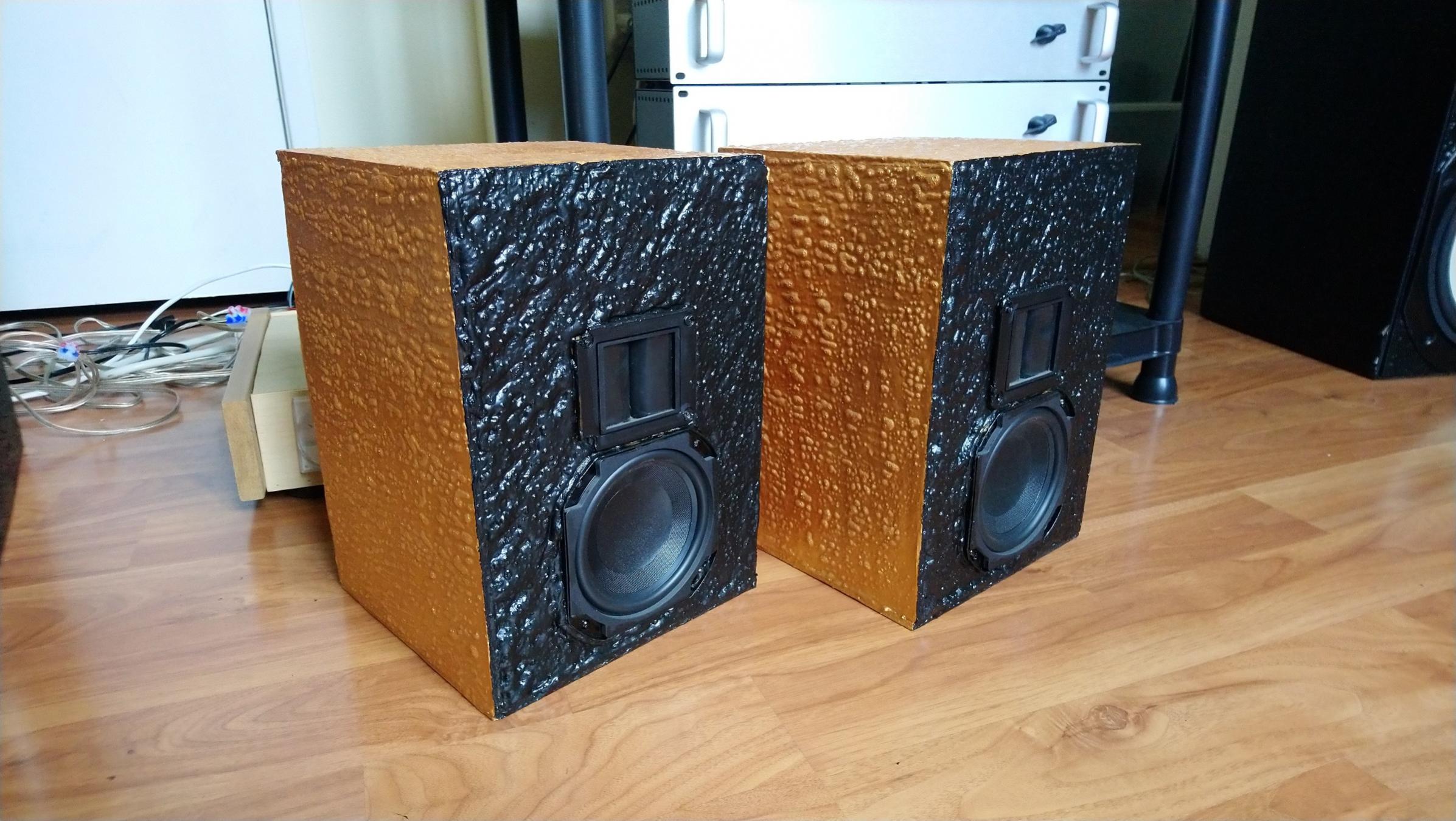

I have been painting those vifa + amt speakers, they are starting to look good and they deserve it
they sound neutral and balanced, just measurements indicate, pleasure to listen to all day

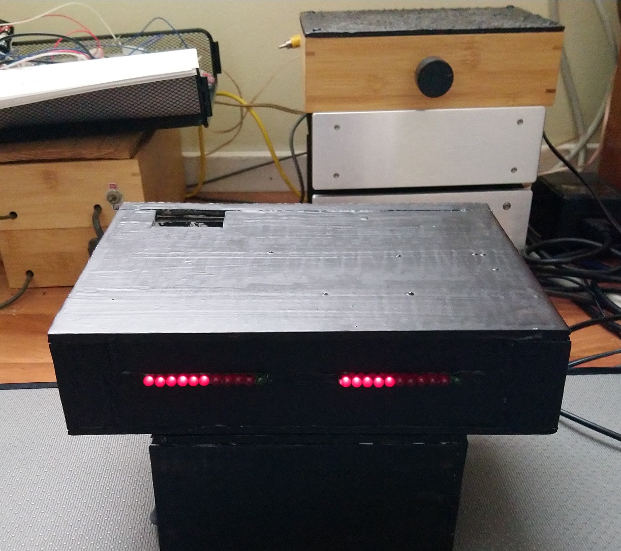

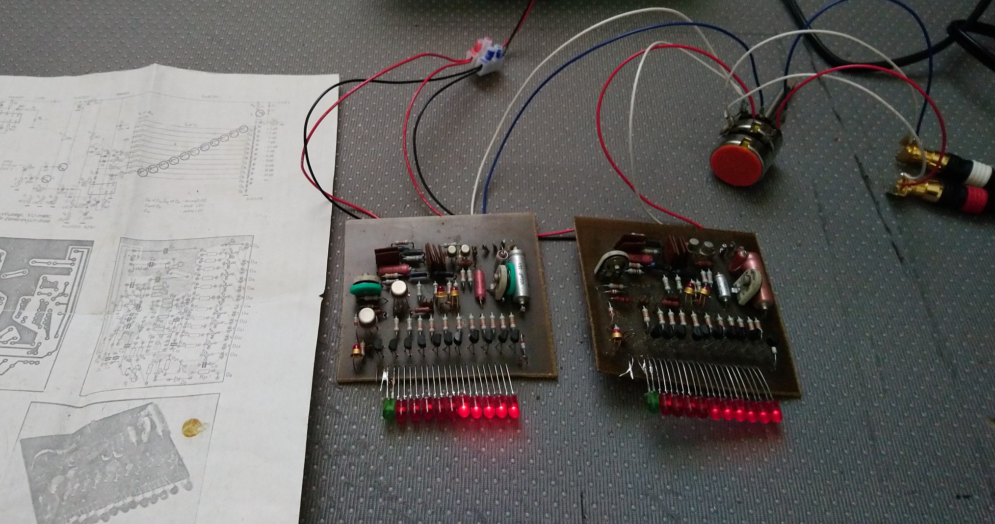

then i repaired an old LED based VU meter, an old circuit, but fun to watch, one channel was not working, so it was about time to have it fixed
i ended up replacing one opamp and two transistors, i am working on getting it into foam board boxes, just like the power supply for it
i will post pics tomorrow

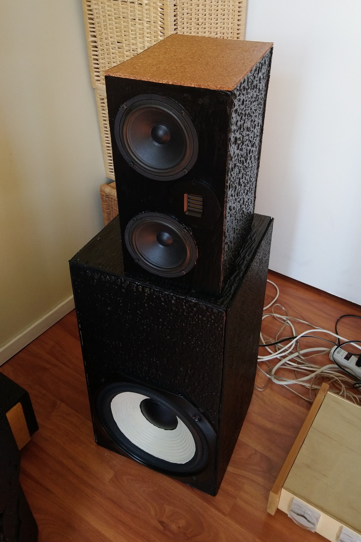

Started to place H2 into the box, even I am not sure where to use it in the end
That 3-way active crossover is already in use and sounds pretty transparent, so I will use it with various speakers which have no passive crossover yet, or are open in the back to adopt

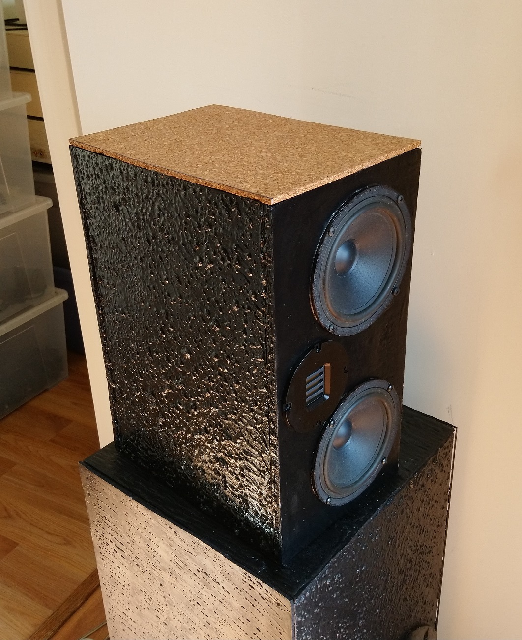

Thanks for the link. Do you know anything about the crossover used?
Btw, i have quite a few linaeum tweeters left. I like how they sound, soft and delicate. I once tried short array of linaeum tweeters with my main speakers, to match the short array of midbasses, but it was beaming too much, i ended up takind it apart.
I do use one linaeum tweeter with faitalpro midrange in small bookshelf. Nice sound.
But the p13wh vifa are special, as they require no crossover. I am pleased how they turned out.
