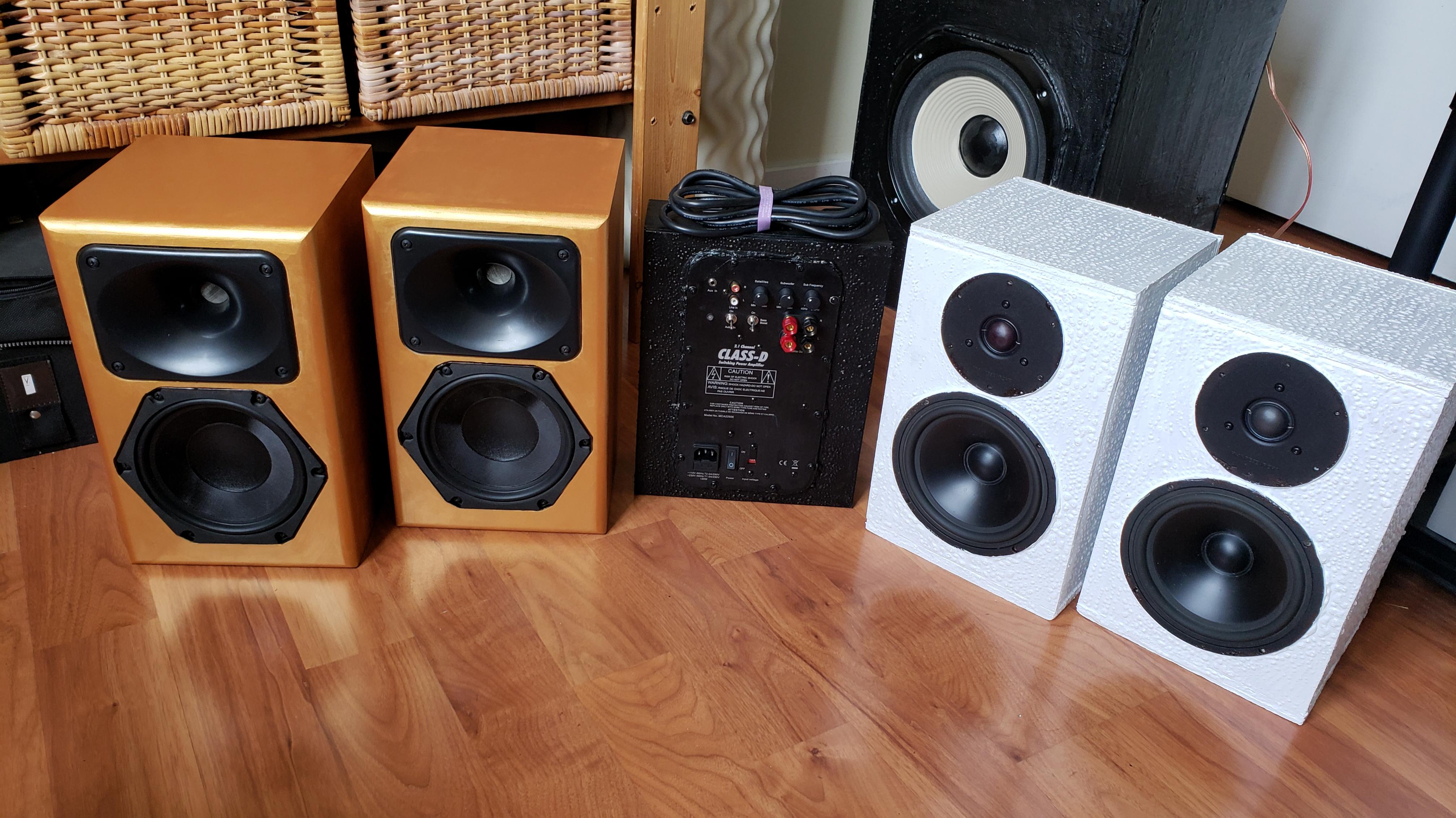

More projects...i got some spare stuff through swap from another diy member, some unfinished, some loose stuff.
I finished those soundgroup bookshelfs, they sound good, but a little laid back to my taste. They will make nice gift.
Loose vifa mid and hivi tweet are now foamboard bookshels, these sound better, flat, more to my taste.
2.1 dayton amp put in box, just add sub and it will be nice dorm system. I have not evaluated its sound yet, it works.

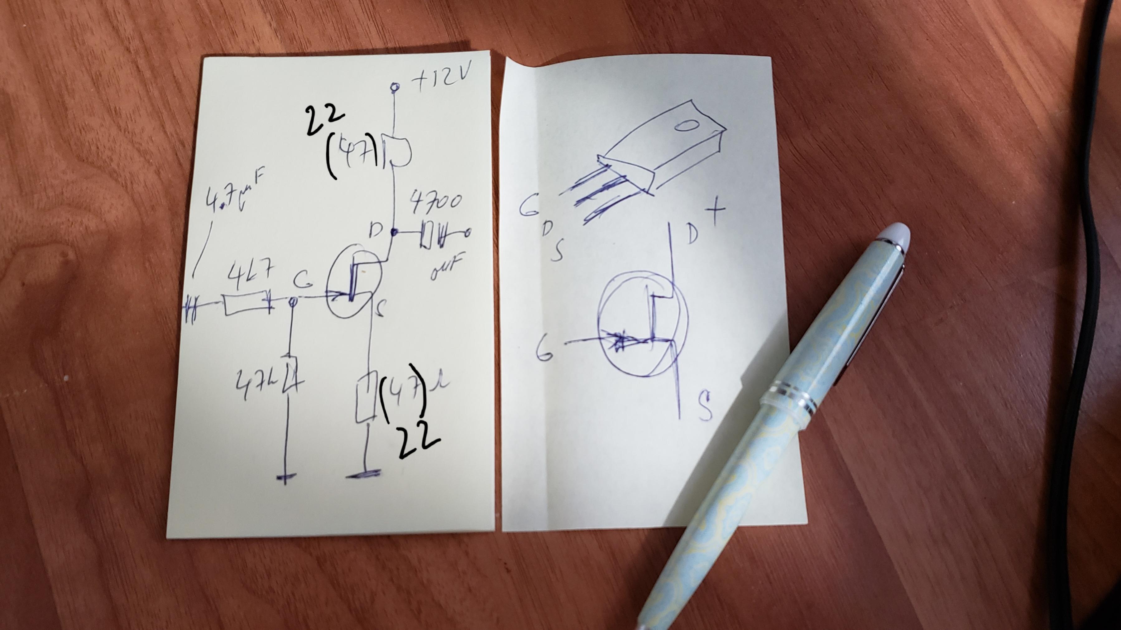

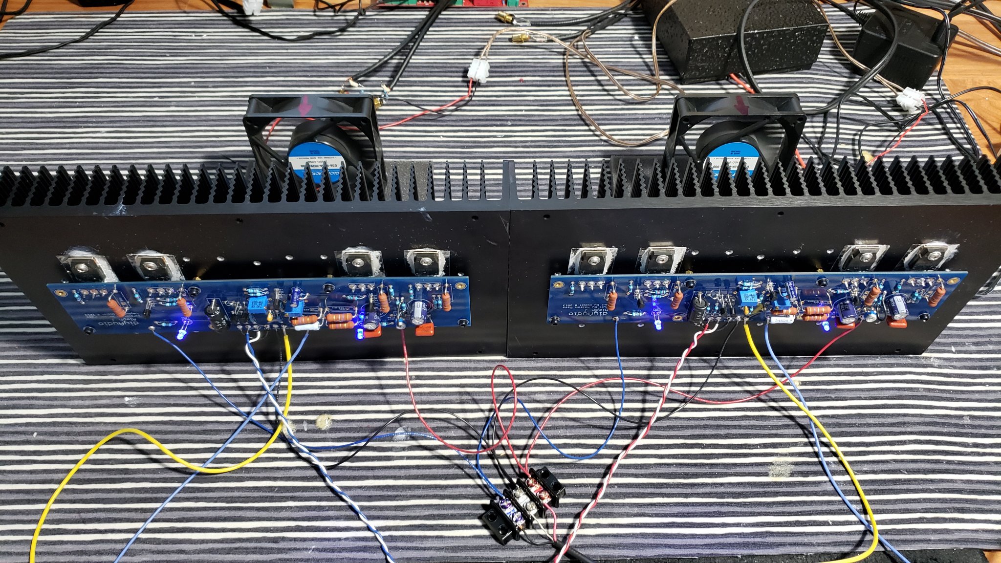

If you are not affraid of a little heat, and want more power and lower distortion, keep the upper resistor at 22ohm, but lower the bottom one to 2-4 ohms. At 2 ohms it draws more than 0.5A and while the transitor is not that hot, upper 22ohm will dissipate some heat.
At 3 ohm lower resistor its manageable. 4 ohm is comfortable zome. It still has pure second harmonic, nothing else, it sounds great, can even power small bookshelf easily.

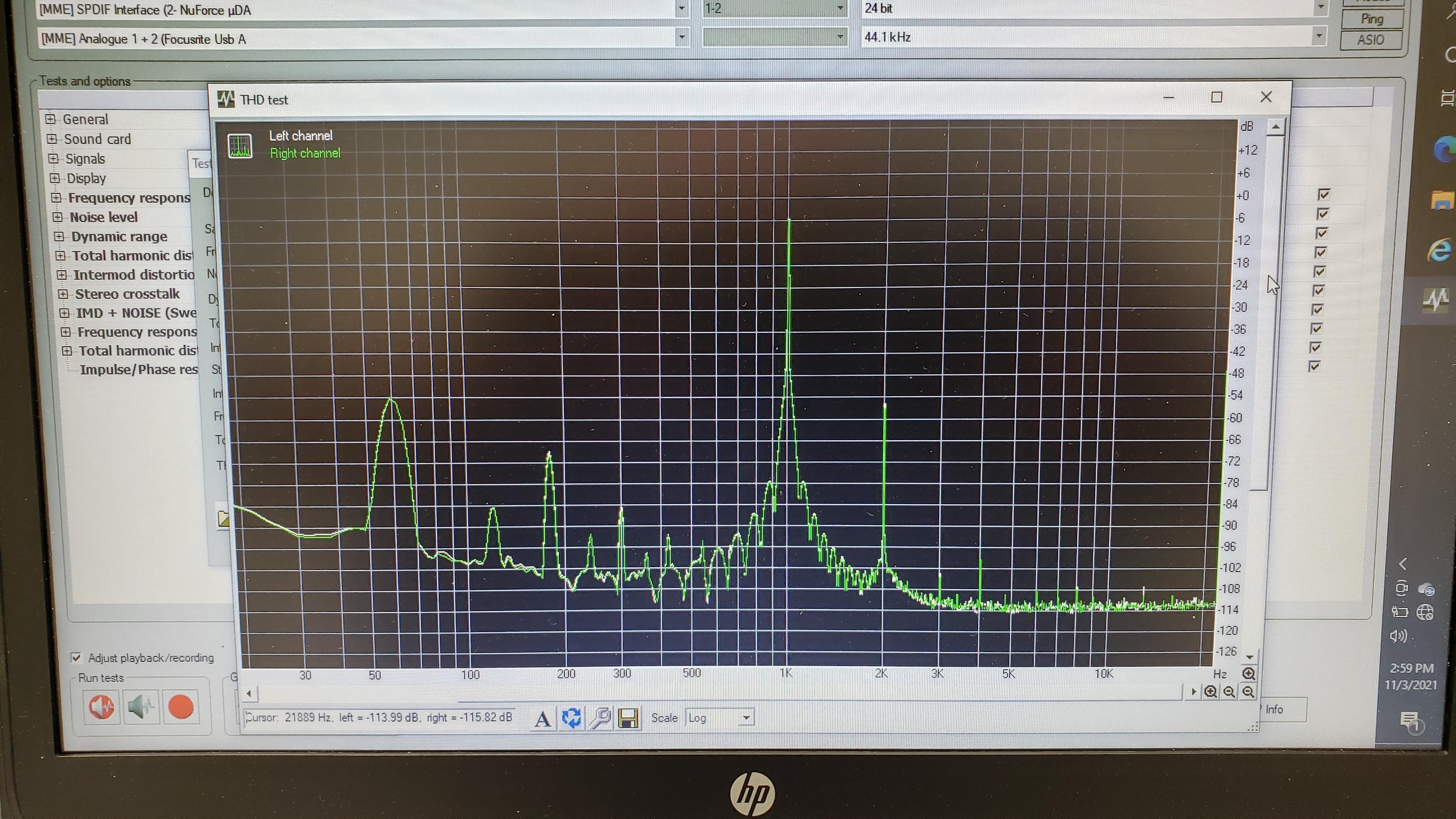

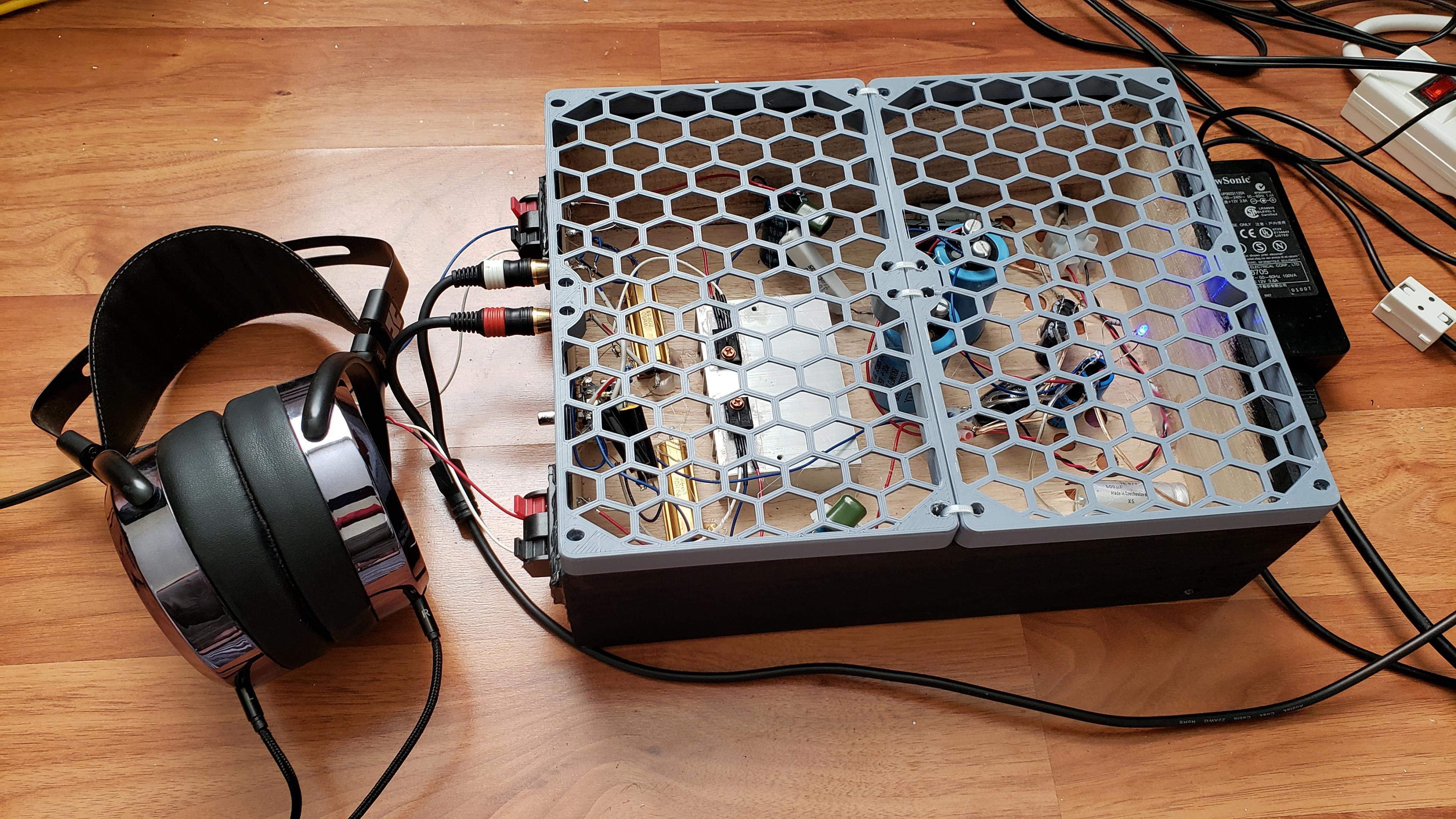

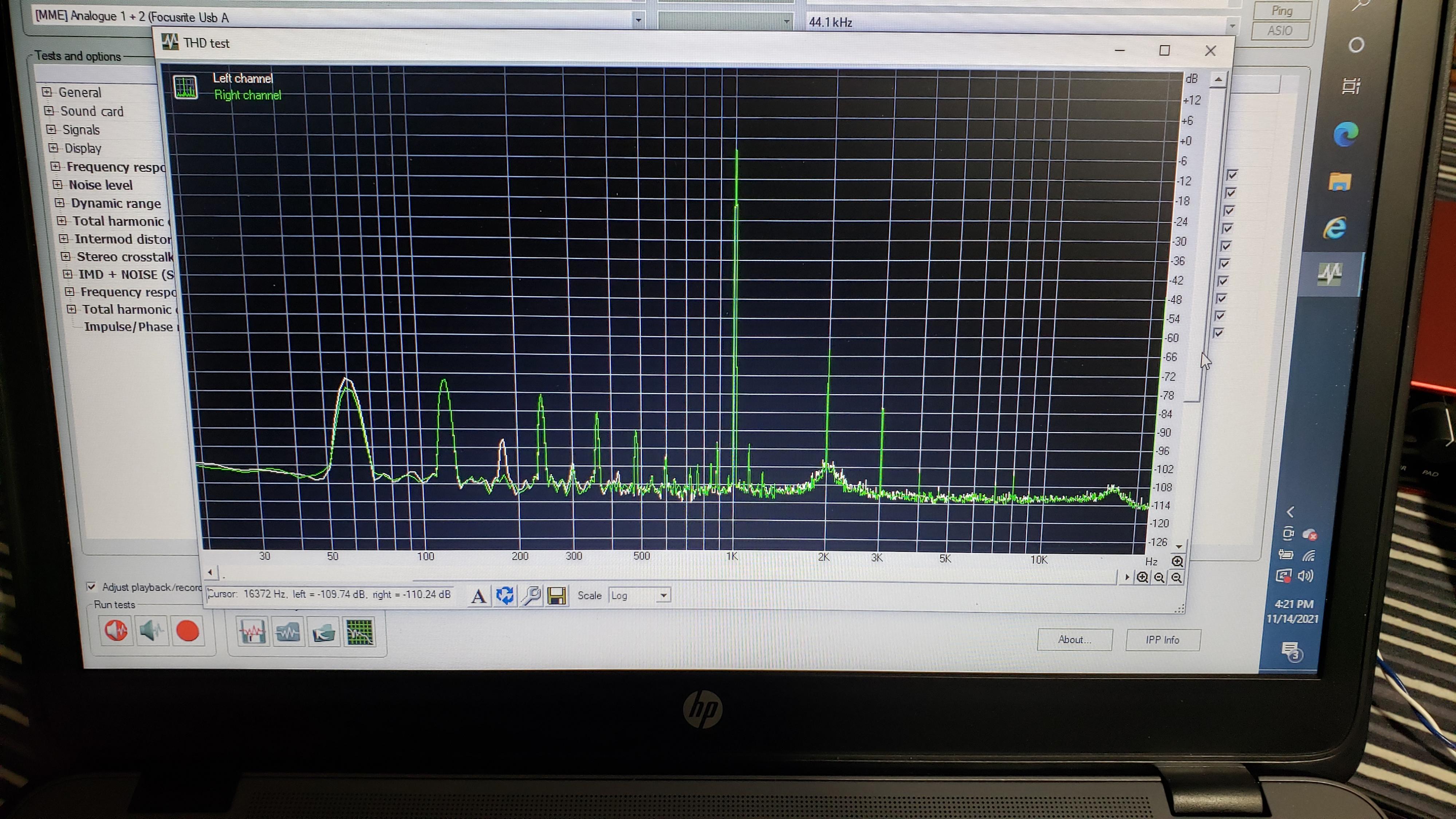

Here is another lu1014 power jfet based amp/headphone amp. Its Juma's circuit. This is true amp, great design, nice sound. Definitely must try.

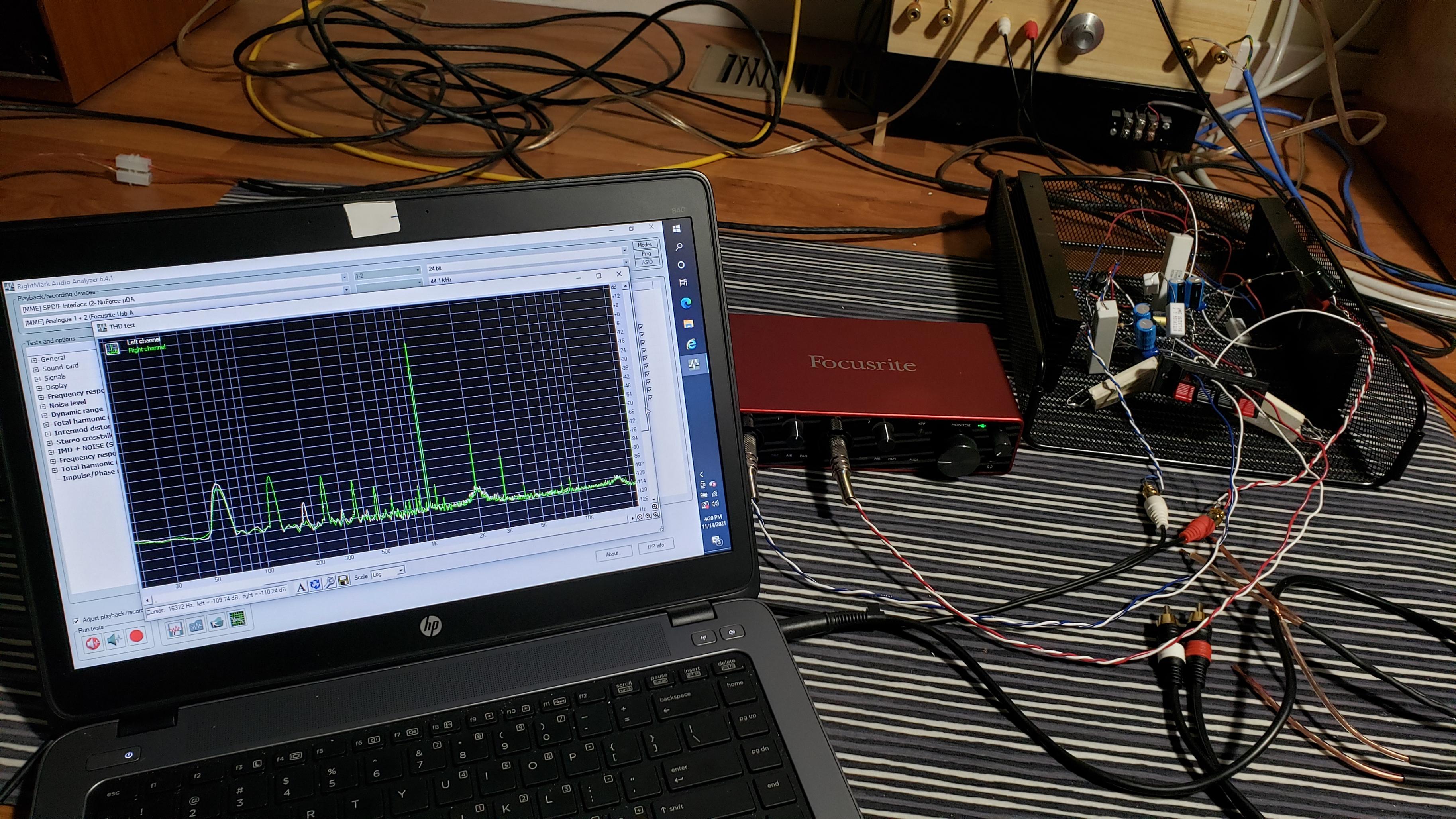

I started to explore the circuit with 8 ohm resistors, just to find out how it works. Then started lowering the bottom resistor to 2-3 ohm, for manageable heat dissipation.
Distortion is much lower than previous simple circuit. This one is not only sporting better current source with upper lu1014, but even some sort of feedback. I do not pretend to understand it completely, ask Juma.

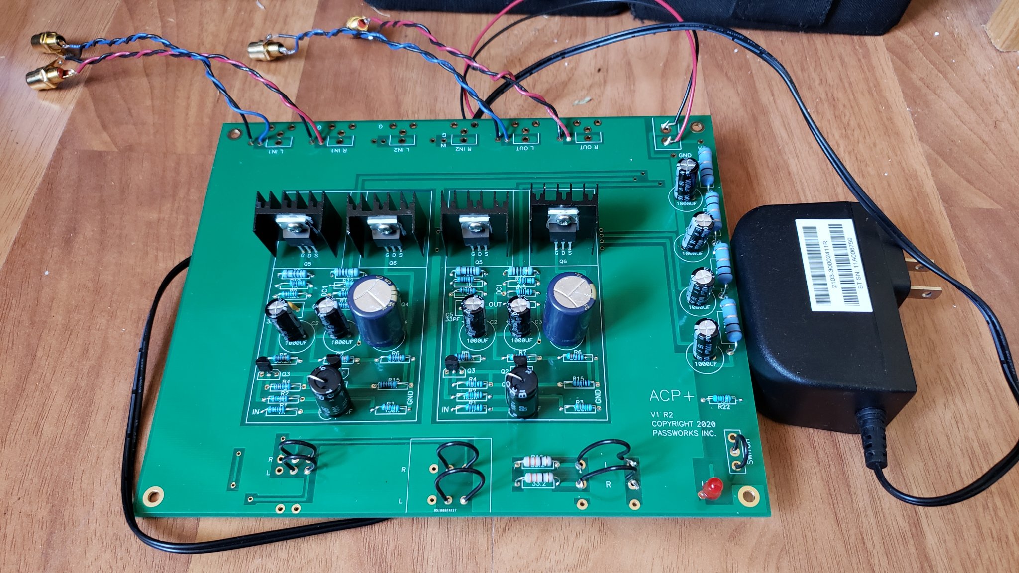

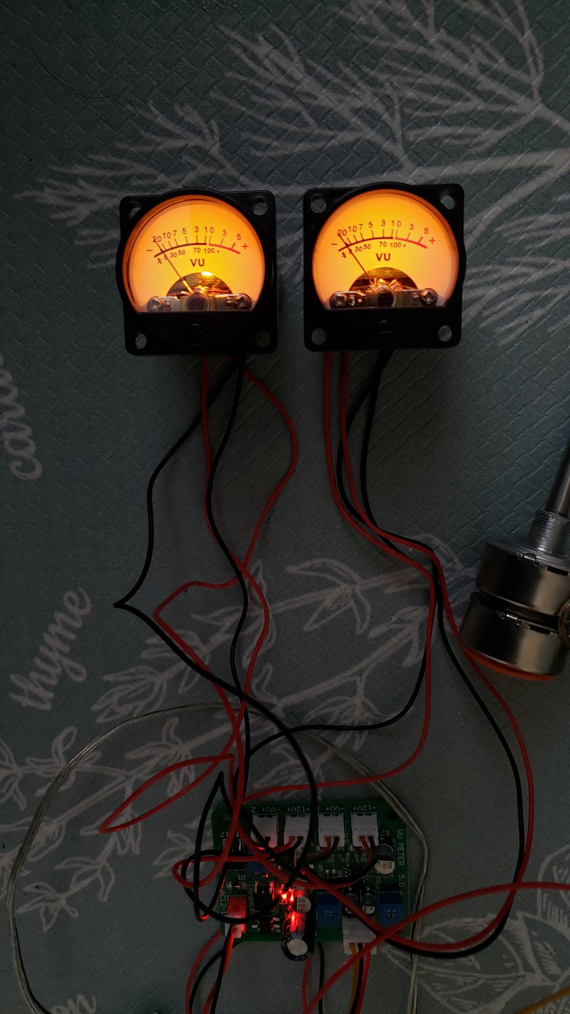

Since both, ACP+ and Whammy are such a great sounding headphone amps and can be used as preamp, I built one more of each. Likely one goes to a friend of mine.
Both work from start, just need boxes. (Hardest part for me)

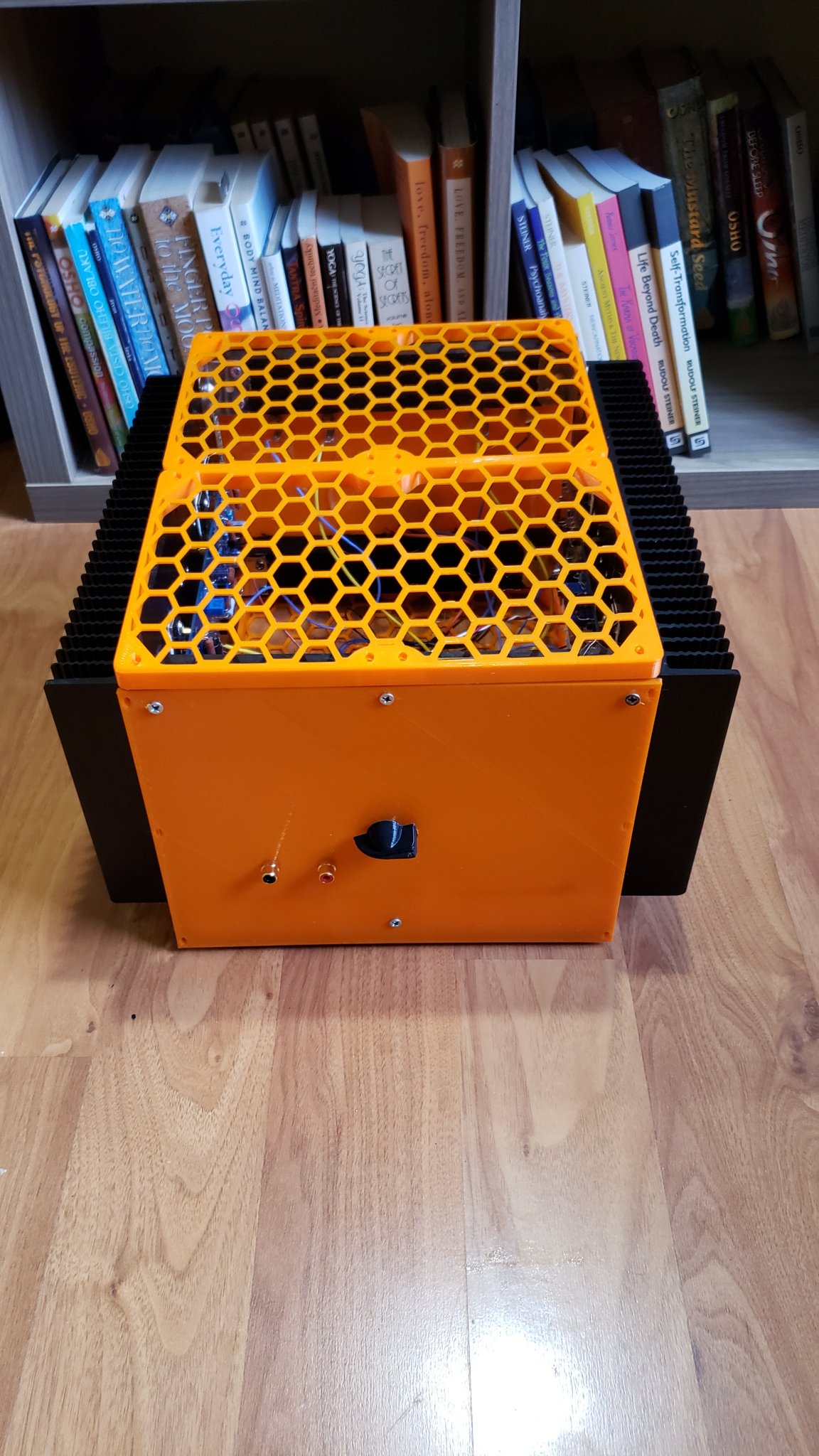

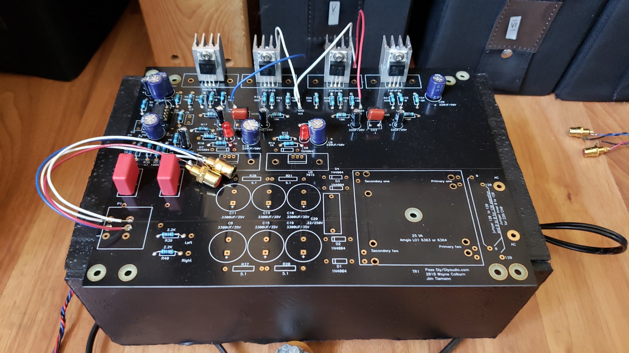

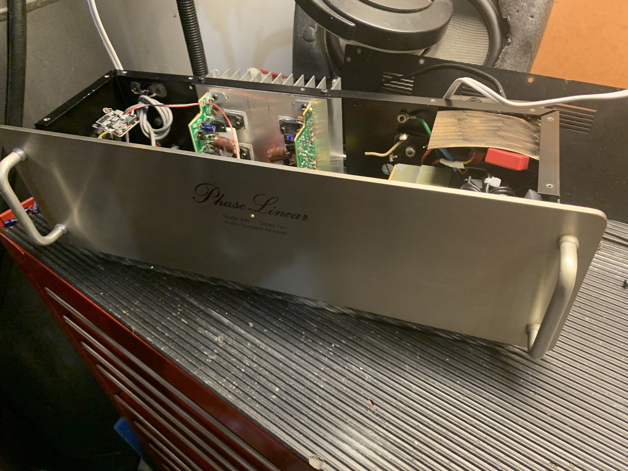

A recent project here was the resurrection of an old Phase Linear 200 amp that was in perfect cosmetic condition. Being a turd of an amp, it had sat on a shelf for years, was free to me.
Another free receiver had its digital processing fail, an Onkyo TX-SV919. The amplifier was still in great shape, and being an early THX specced product, I thought it was worth saving, appeared to have some matched parts, higher quality caps. The main chassis and front channels of the Onkyo went to a shop space where I work, and the rear/surround channels were removed as a module.
That module fit right into the Phase Linear 200 carcass, and using the original transformer ahead of another yielded the 44v for the amp module. Another drop from the last transformer was utilized to make a dedicated 5v supply for a Bluetooth receiver.
A CLC filter between the transformers helps with line noise.
A pair of Infinity Primus 150 speakers with blown tweeters sounded pretty good with the newly assembled rig.
After digging through a box of jbl surround speakers that had small drivers along with tweeters, it was discovered that the tweeters were the same dimensions, yet were 6.7 ohm versus the 3.2 ohm of the blown Infinity ones. After a bit of adjustment (remove series R ahead of HF crossover, new poly caps, add r to drivers) of the crossover, the Primus 150s are sounding great for use in a main area together with the retro Franken-amp.
