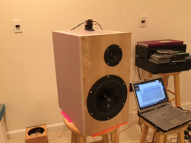

The speaker was my reference 2-way FAST with passive transient perfect cross-over and ScanSpeak 10F/8424 mid-tweeter and Dayton RS225-8 woofers in a sealed 24 liter box. The speaker is described here:
http://www.diyaudio.com/forums/full...-rs225-8-fast-ref-monitor-68.html#post4743530
Here is measured impedance of this speaker:
![554260d1465632129-subjective-blind-abx-test-enabled-ff85wk-round-6-10f-rs225-passive-xo.png](https://www.diyaudio.com/forums/attachments/full-range/554260d1465632129-subjective-blind-abx-test-enabled-ff85wk-round-6-10f-rs225-passive-xo.png)

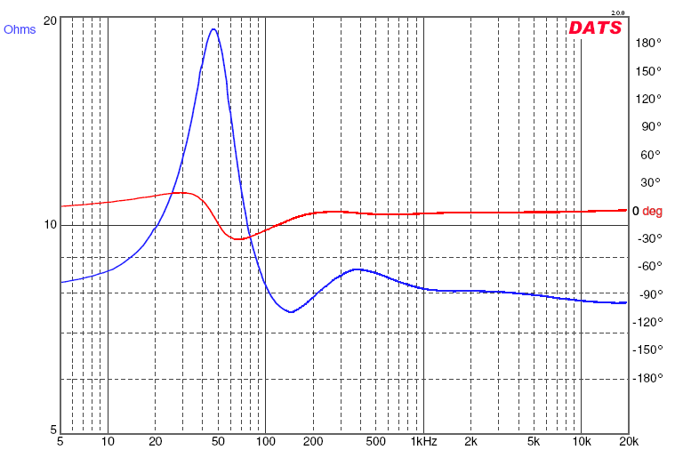

![564191d1470801376-virtual-audition-very-simple-quasi-mosfet-amp-10f-rs225-passive-xo-impedance.png](https://www.diyaudio.com/forums/attachments/solid-state/564191d1470801376-virtual-audition-very-simple-quasi-mosfet-amp-10f-rs225-passive-xo-impedance.png)

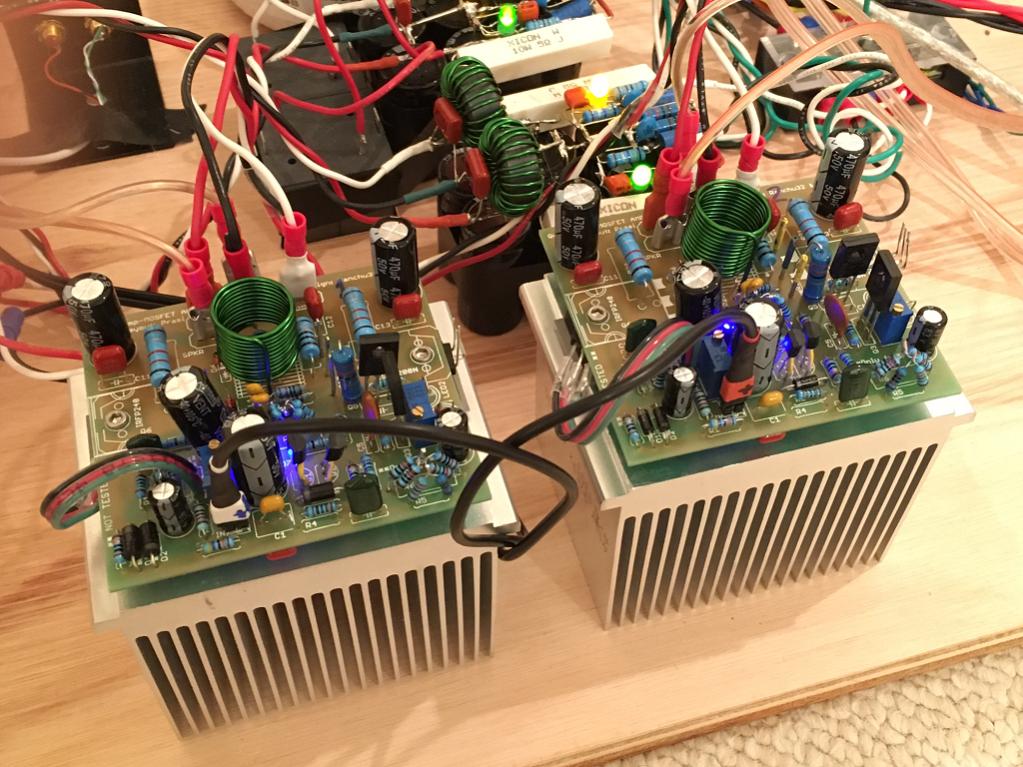

Here is my simple Quasi amp build:
![563440d1470465047-very-simple-quasi-complimentary-mosfet-amplifier-quasi-stereo-final.jpg](https://www.diyaudio.com/forums/attachments/solid-state/563440d1470465047-very-simple-quasi-complimentary-mosfet-amplifier-quasi-stereo-final.jpg)

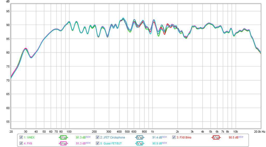

Here is the combined frequency response measured from all amps (mic and speaker untouched):
![563999d1470722625-virtual-audition-very-simple-quasi-mosfet-amp-amp-comparison-all-freq-response.png](https://www.diyaudio.com/forums/attachments/solid-state/563999d1470722625-virtual-audition-very-simple-quasi-mosfet-amp-amp-comparison-all-freq-response.png)

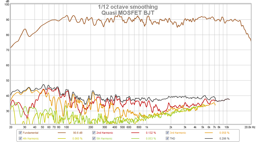

This is what the measured harmonic distortion spectrum looks like from the speaker with the Quasi amp - in general, it's lower than the speaker's HD so really doesn't intrude - but higher order distortion components vary somewhat between amps:
![564000d1470722625-virtual-audition-very-simple-quasi-mosfet-amp-amp-comparison-all-freq-response-hd-quasi.png](https://www.diyaudio.com/forums/attachments/solid-state/564000d1470722625-virtual-audition-very-simple-quasi-mosfet-amp-amp-comparison-all-freq-response-hd-quasi.png)

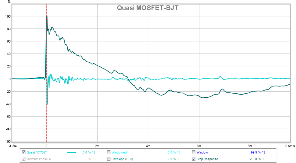

Here is the measured impulse and step response for the Quasi amp:
![564001d1470722625-virtual-audition-very-simple-quasi-mosfet-amp-amp-comparison-all-freq-response-ir-quasi.png](https://www.diyaudio.com/forums/attachments/solid-state/564001d1470722625-virtual-audition-very-simple-quasi-mosfet-amp-amp-comparison-all-freq-response-ir-quasi.png)

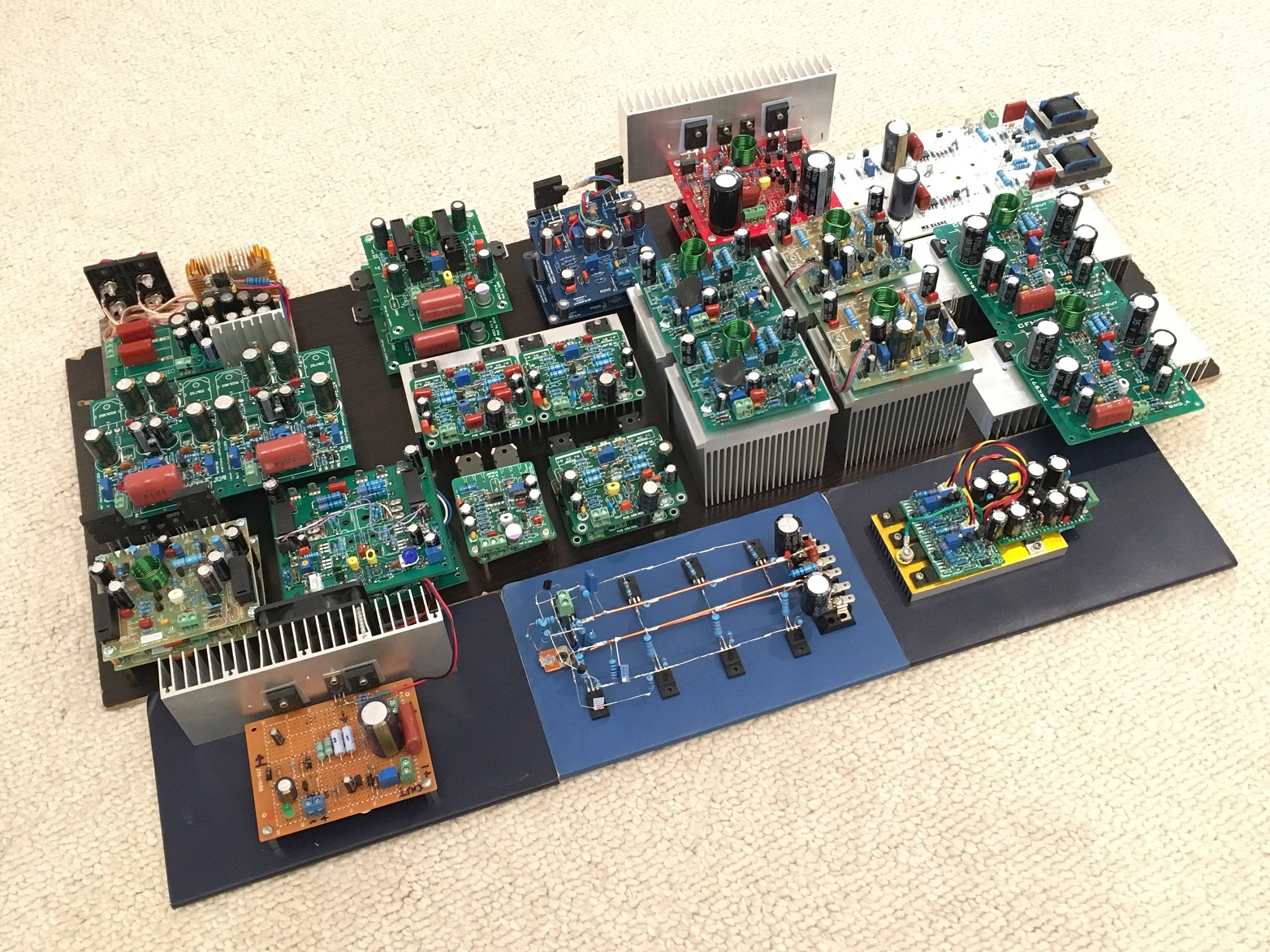

![580661d1479476675-virtual-audition-very-simple-quasi-mosfet-amp-ss-amps-2016-review2.jpg](https://www.diyaudio.com/forums/attachments/solid-state/580661d1479476675-virtual-audition-very-simple-quasi-mosfet-amp-ss-amps-2016-review2.jpg)

Speaker impedance plot ?
I will run a DATS sweep of it later tonight and report back.

It'st interesting how even though the frequency response plots all pretty much line right up within less than 0.5dB, there are audible differences in the areas you mention above. The dynamics and distortion are quite easily discernible. Detail is somewhat compromised with a mid/tweet FAST design as it cannot compete with a dedicated soft dome tweeter or ribbon/AMT for detail that is contained above 18kHz.
I will post source reference tracks when I get back home.
