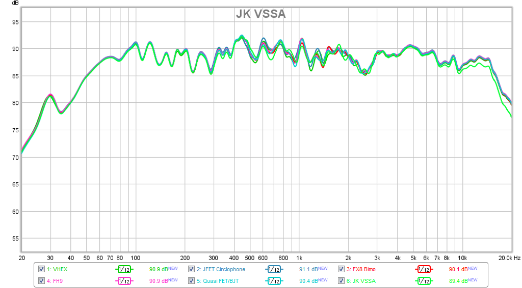

JK VSSA Sound Clips
This is for the Jason K VSSA amp. So now we have another current feedback amp.
Here is the measured frequency response in comparison to all the amps, and this is the only one that strays from the same basic curve that all the others have. It has fall-off at the high frequencies faster. I am not sure why this is as it uses similar lateral FETs that the FX8 Bimo uses (although they look like pulled Hitachi's rather than new Renesas). Note that the mic and speaker have not been touched since this experiment started so it's definitely caused by the amp:

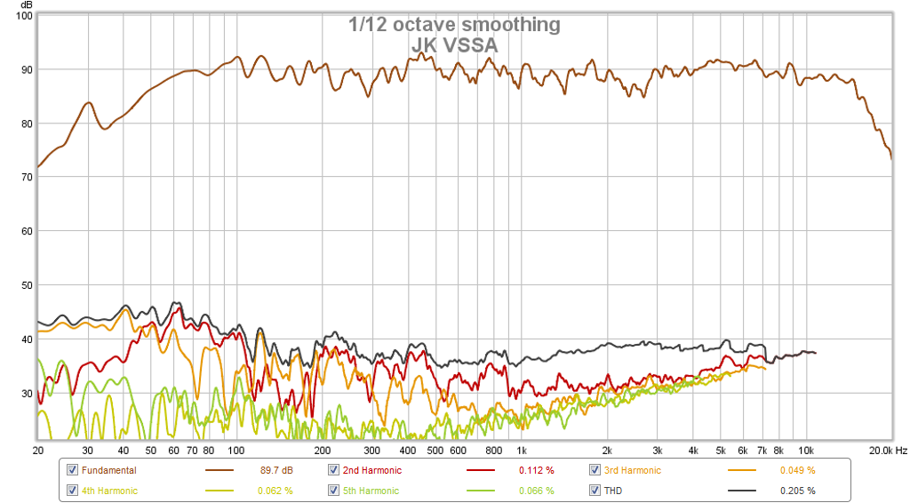

Here is the measured harmonic distortion:

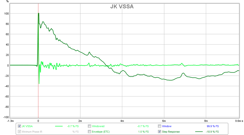

Here is the Impulse and Step Response:
![564176d1470797369-virtual-audition-very-simple-quasi-mosfet-amp-amp-comparison-all-freq-response-vssa.png](https://www.diyaudio.com/forums/attachments/solid-state/564176d1470797369-virtual-audition-very-simple-quasi-mosfet-amp-amp-comparison-all-freq-response-vssa.png)
![564177d1470797369-virtual-audition-very-simple-quasi-mosfet-amp-amp-comparison-all-freq-response-hd-jkvssa.png](https://www.diyaudio.com/forums/attachments/solid-state/564177d1470797369-virtual-audition-very-simple-quasi-mosfet-amp-amp-comparison-all-freq-response-hd-jkvssa.png)
![564178d1470797369-virtual-audition-very-simple-quasi-mosfet-amp-amp-comparison-all-freq-response-ir-vssa.png](https://www.diyaudio.com/forums/attachments/solid-state/564178d1470797369-virtual-audition-very-simple-quasi-mosfet-amp-amp-comparison-all-freq-response-ir-vssa.png)
