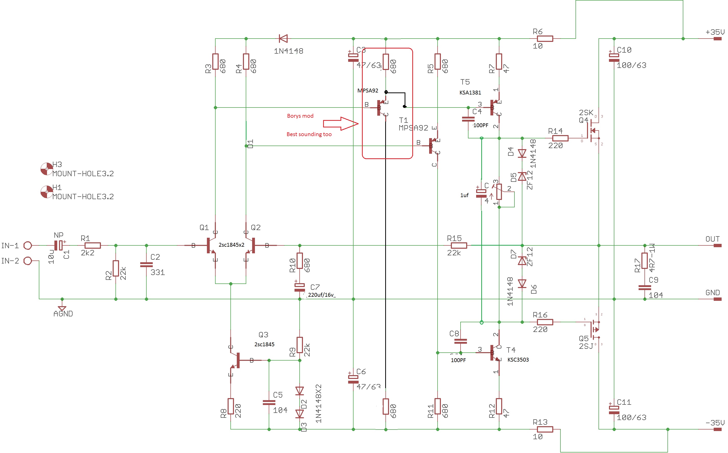

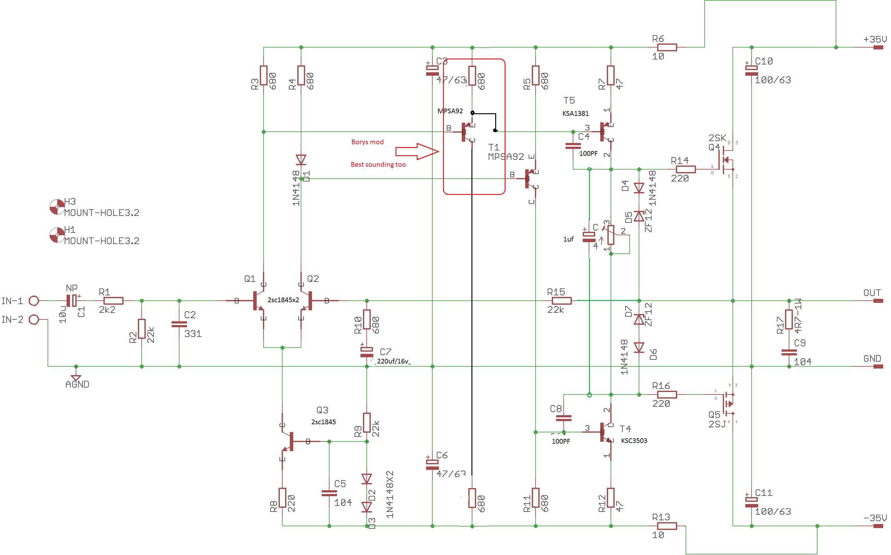

FX8-Borys mod is best sounding too. Can you make it for pcb layout?
Thanks in advance.
Boyet

"My feeling is that the bass of hexFET has more impact"
you can measure it?
Thiago
It shows up as maybe (but not always visible in frequency response) +0.5dB boost over 40Hz to 100Hz range - but the effect is really more of a transient effect of higher slew rate or attack. Listen to sound clips from post 3 and 4 and hear for your self. Recorded under same condition with only difference being amps.

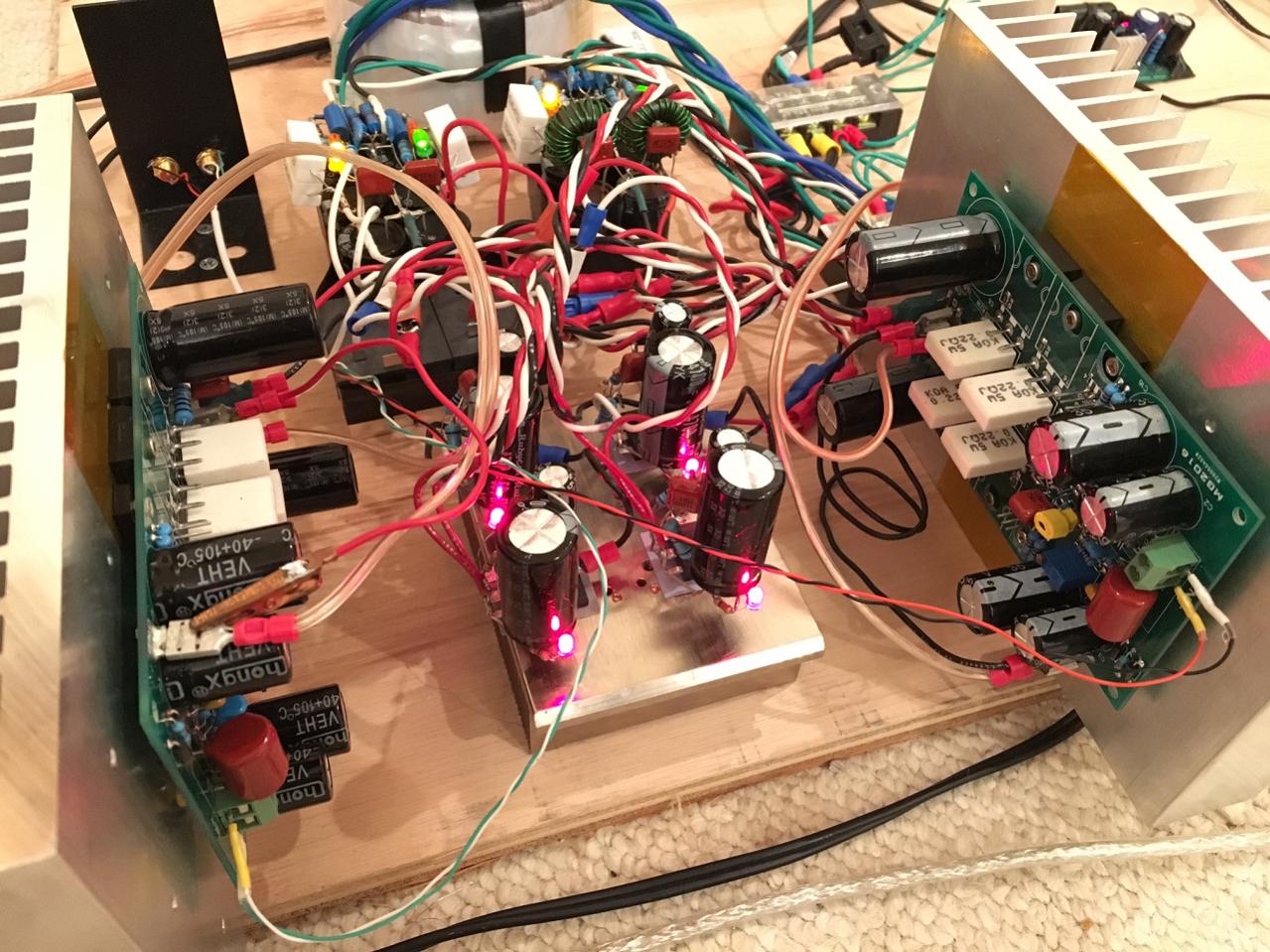

CFH9 Amp
I just finished building and testing the CFH9 amp. I fitted it with Juma's cap multiplier and running off 300VA toroidal trafo with 39v rails after the cap multiplier. Operating at 460mA overall quiescent bias.

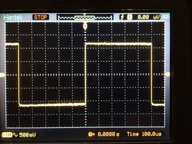

This amp has pretty clean square waves too:

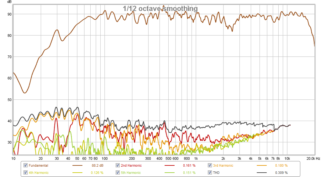

Frequency response and measured HD at speaker is very low:
579780d1479035010-virtual-audition-very-simple-quasi-mosfet-amp-cfh9-amp-meas-speaker-hd.png

All this started just last March and has been a blast learning from all of the experts here. A big thanks to Prasi, Sonal Kunal, Idefixes, Dacz, Kees52, and Jkeutermann for providing me with such great Gerbers that made this possible. Also, a huge thanks to the great designers of the circuits that I built with Apex Audio and Nelson Pass as probably the leading sources of inspiration that got me to start building amps.
Not shown below are CFH9 (currently in the hot seat), VHEX+ (in a case), F5HA with IRF610/9610 (in case), and ACA deadbug (at office). My journey was (as best as I can remember) as follows: Dx, ACA P2P, Inv JFET Circlophone BJT OPS, DOS TDA7297 w shunt reg, FX8 50mm - Sonal layout, FX8 Bimo - Prasi layout, VHEX+, FH9, FH9HV, VSSA JK thru-hole, Inv JFET Circlophone MOSFET OPS, Ranchu/Aksa Quasi - Prasi layout, Apex AX11 - Prasi layout, M2 - Teabag layout, Kees52 allFET Circlotron, CFH7 - Idefixes layout, Ranchu/Aksa Quasi - Dacz layout, Juma F5 2SK2013/2SJ313 - P2P, F5HA - P2P, CFH9 - Idefixes layout, F5HA - Prasi layout, F5HA 2SK2013/2SJ313 w Juma shunt reg - Prasi layout.
580661d1479476675-virtual-audition-very-simple-quasi-mosfet-amp-ss-amps-2016-review2.jpg
