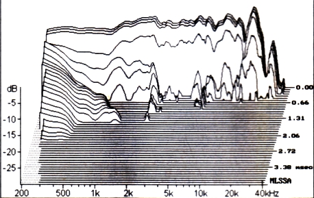

Some photos... Hope other location's B80 are not like this....
What is the basket made of?

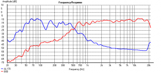

i've just build a testcase with the B80 open baffle and a TB W6-1721.
The TB has a sealed enclosure of 17L and i've build a 2nd order linkwitz riley XO @300hz.
well to be honest it's a great driver but it's all in what you're lookin' for...
if you want a huge soundstage you'll be better of with a visaton SL713 but the B80 has way more detail in higher frequencies..

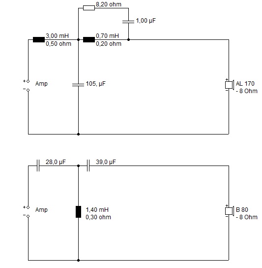

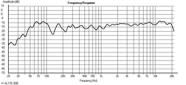

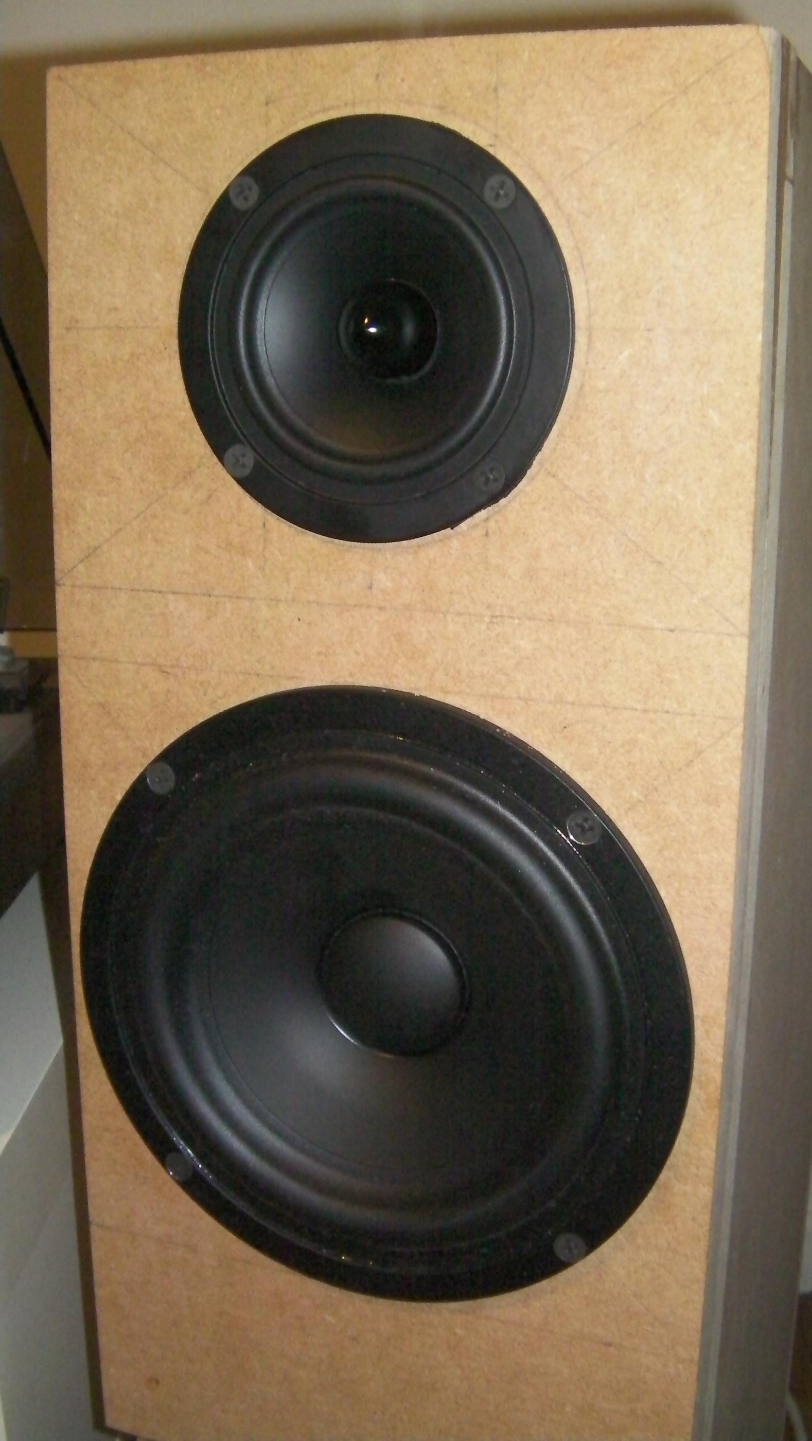

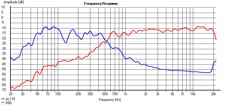

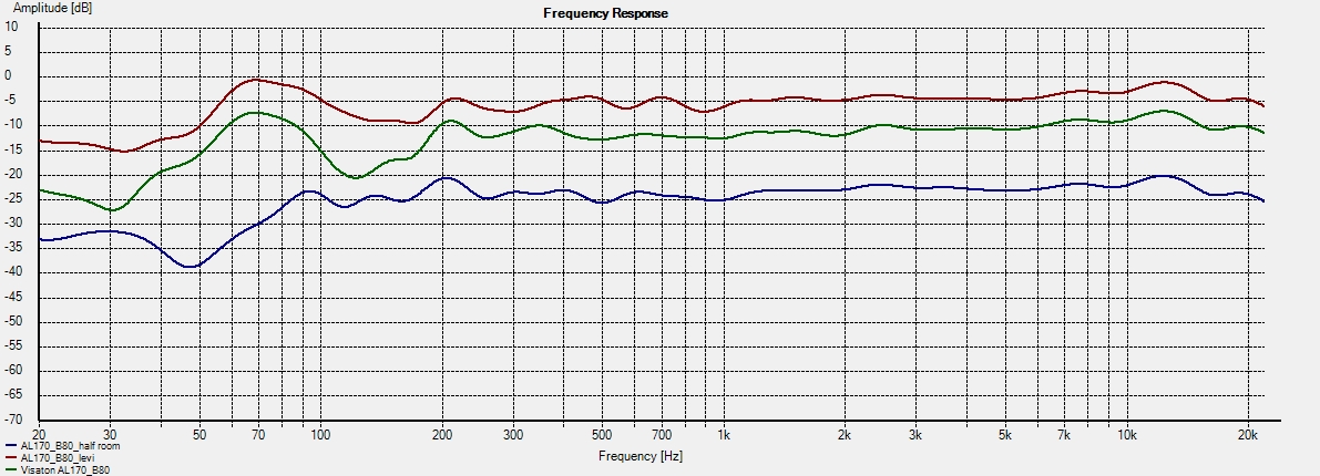

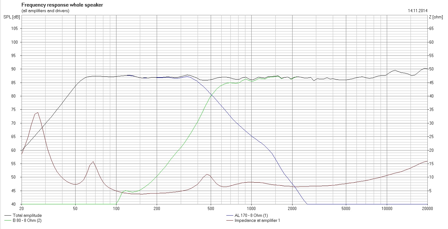

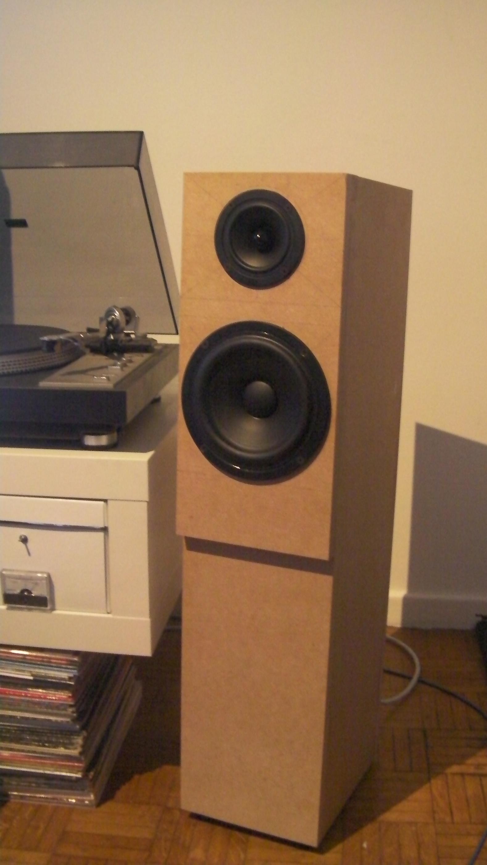

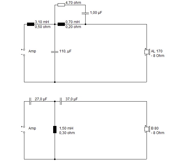

Here are some measurements ..
Xover is not appropriate, first coil on the bass was 3.3mH and need to be about 3..
Also boxes had approximate volumes, 30L BR for AL170 and 5L closed for B80..but B80 box had inadequate front panel, need to be at least 24cm wide..
When completed appropriate box and xover I think it will be even better..

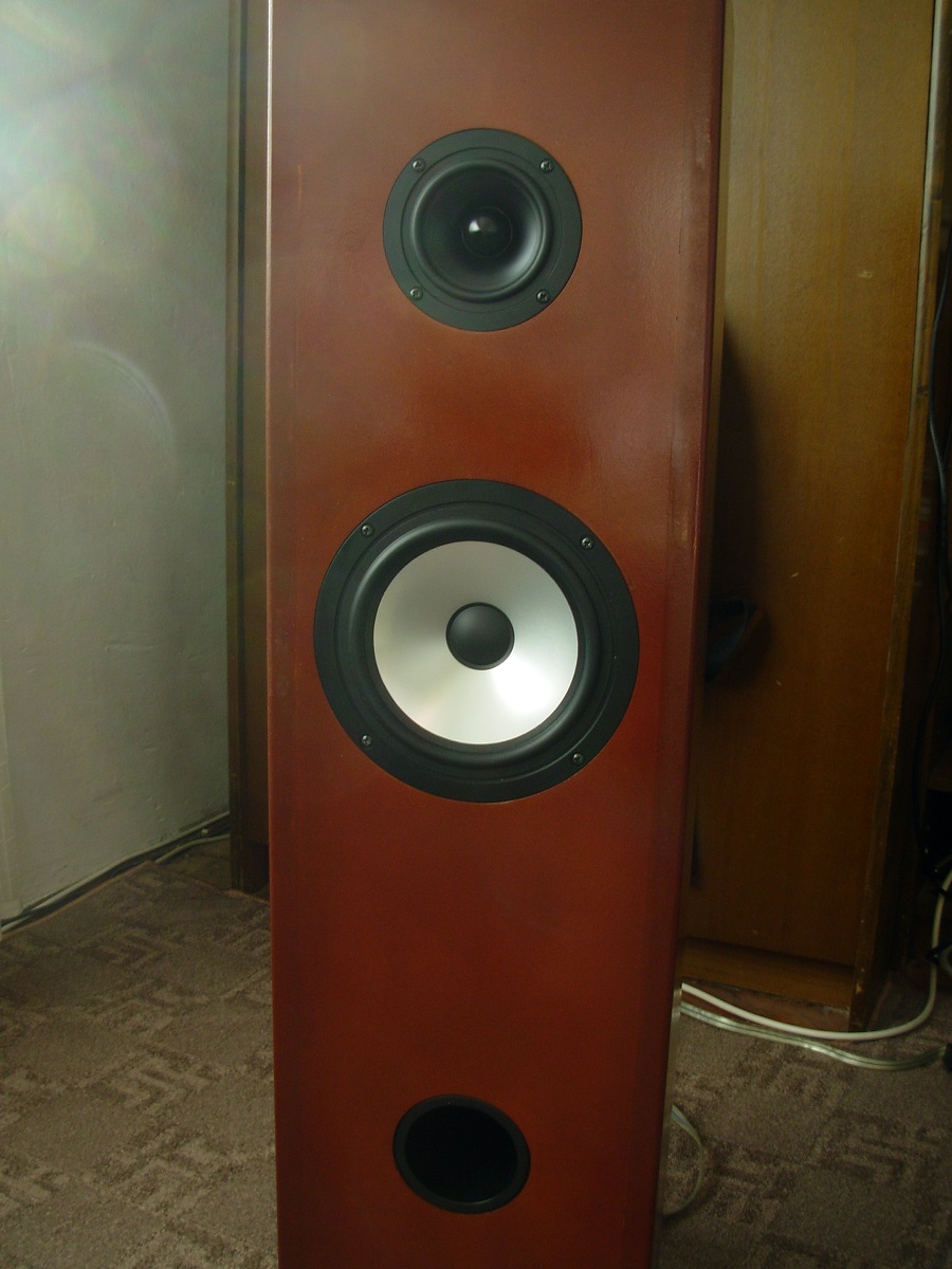

I was right..When completed appropriate box and xover I think it will be even better..

I was right..

500Hz, AL170-30L BR, B80-5L closed.. 100x24x30 box..Can you tell us some more info?
Xo freq, vol, more measurements etc

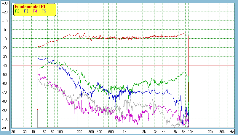

Do you have waterfall diagram and THD measurements for TC9FD..This driver looks nice but not sure if the specs are any better than Vifa TC9FD - which I am sure is made in China but sounds fantastic..

edit. I found some measurements for Vifa .. greater distortion compared to Visaton, but not bad for the price..

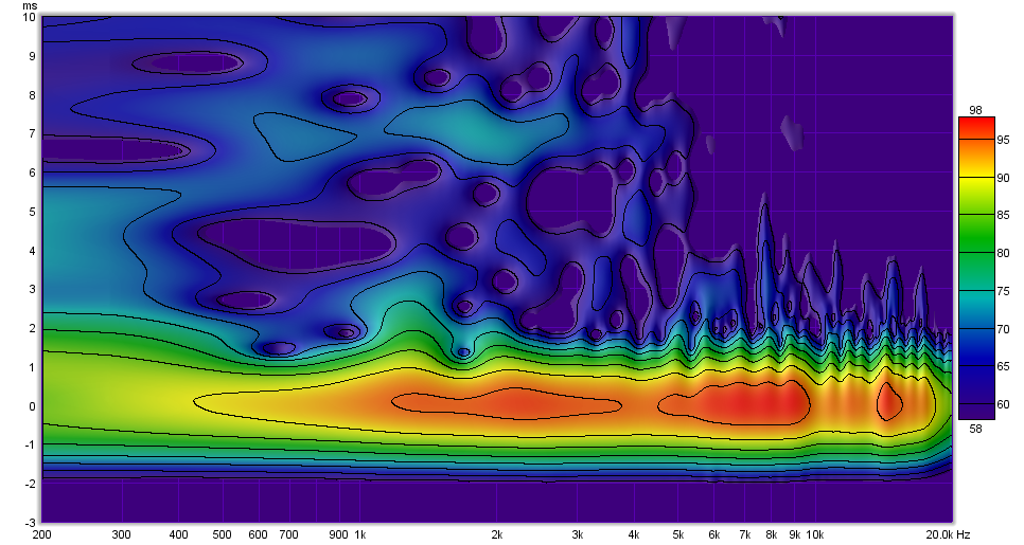

I don't have waterfall but here is time spectrogram (10 ms window gating) for TC9FD in the Nautaloss (sealed spiral TL). Seems like it decays pretty quickly.
![460807d1421931165-visaton-b80-nautaloss-spectrogram-10ms-gate.png](https://www.diyaudio.com/forums/attachments/full-range/460807d1421931165-visaton-b80-nautaloss-spectrogram-10ms-gate.png)
