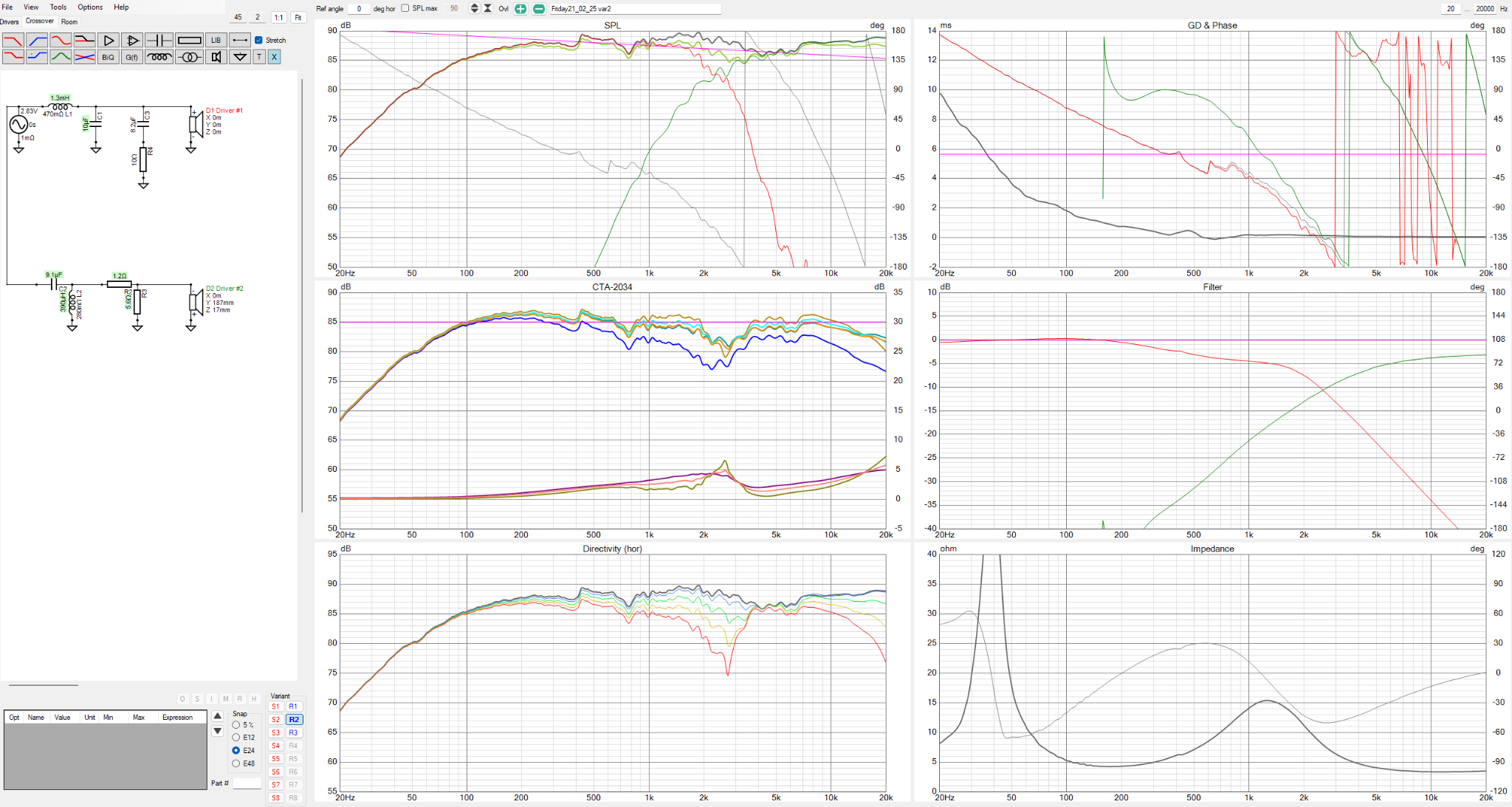

Would it be possible for anyone skilled with Vituixcad to eyeball my work for errors. I am a newbie. I started trying to design a crossover to replace drivers in nice old cabinets. As a consequence, my cabinet dimensions, including driver hole sizes are fixed. I have done 7 different designs and entered each into LibrePCB and have completed board layout, but have not had any PCB built so far. Being a beginner, it sure would be nice to have a set of eyes on my work before building the PCB.
I enjoy the work and don't want anyone to do it for me, but I've exhausted what I know to check. If anyone would care to say, something like "are you sure you used the right configuration of ...", or "there appears to be an issue on graph x ..." it would be of enormous help. I attached the most basic graphs and schematic of my most likely to succeed version - there's more for the asking.
The drivers I expect to use: Dayton SIG180-04 (woofer) and Tymphany XT25BG60-04 (tweeter)
Since I feel I owe this sight some payback, I created a library of resistors, capacitors, inductors, and a few miscellaneous items - enough to allow others a pretty fast way to produce a PCB in LibrePCB. Unlike Vituixcad, my background favors this latter undertaking. I'm happy to share this library and could use a pointer of how to do it on diyAudio.
Hopefully I've not offended anyone with this post.
Thanks,
Dave

If I am not mistaken you did not include the effect of baffle (baffle step and all other diffraction effects), or did you?
I also suggest you build a non-pcb version of your crossover to check whether you like the sound and only then (If you do like IT) make a PCB.
Info on the front baffle and the driver separations centre to centre with distance to the cabinet edges would allow a quick simulation for diffraction or baffle step.

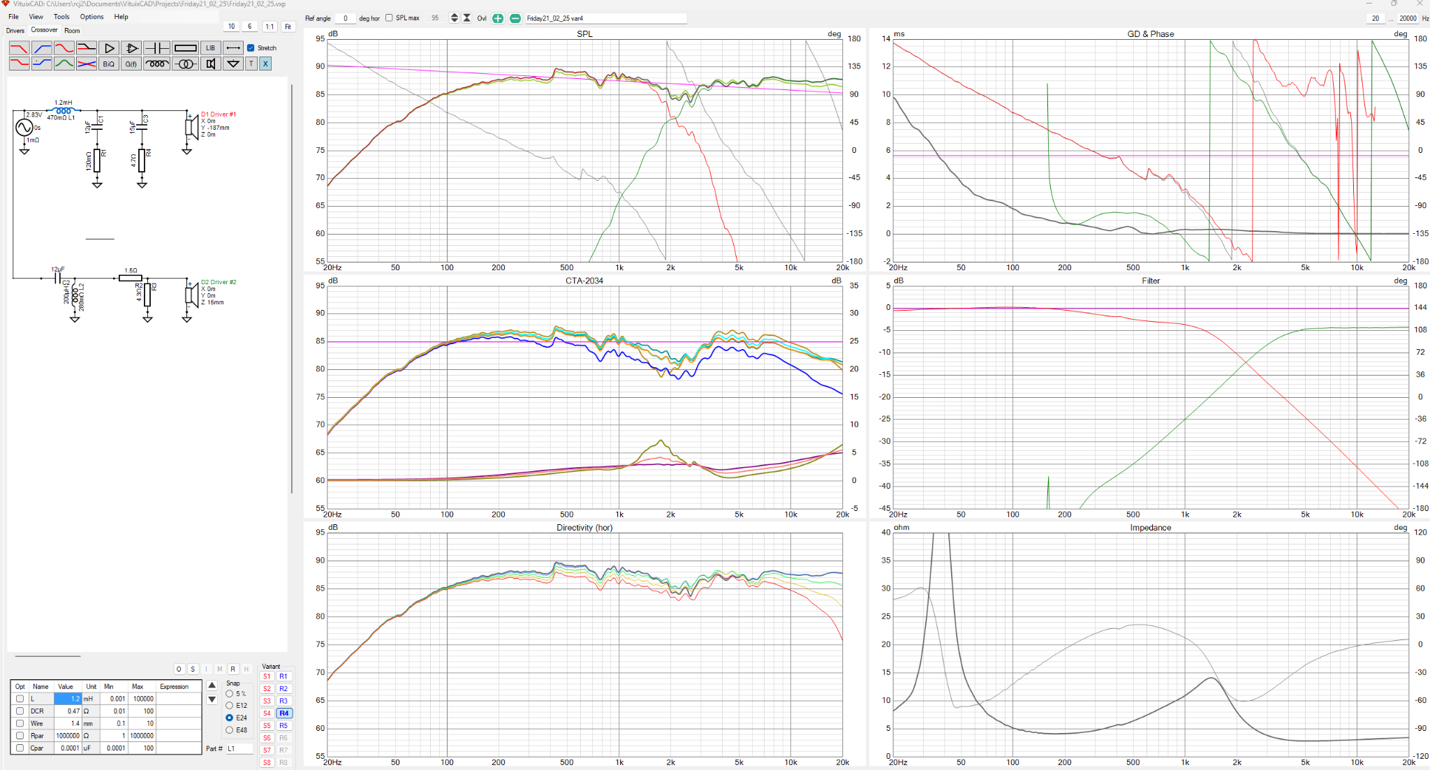

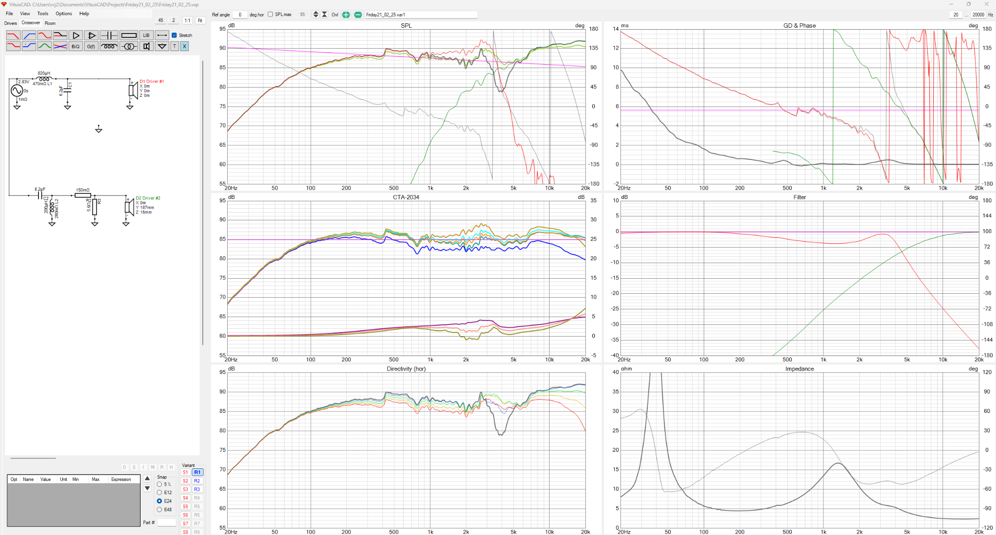

I haven't had much time with this so kindly take with a piece of caution. The most worrying things is the bump at 2-3Khz in the first shot.
The second is an attempt to do something about it, not having the drivers here is tricky to know what you can do and cannot do with them especially a new metal cone driver. Also there is an element of guesstimate on the way the tweeter and its baffle interact.
As this is a simulation playing with the tweeter z does change things, and again I am not yet convinced I should have made its mount part of a more complex shape.

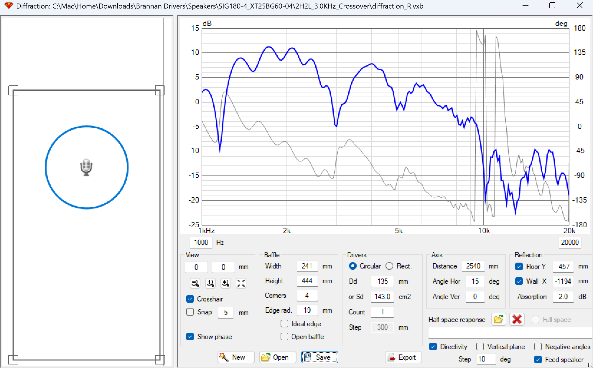

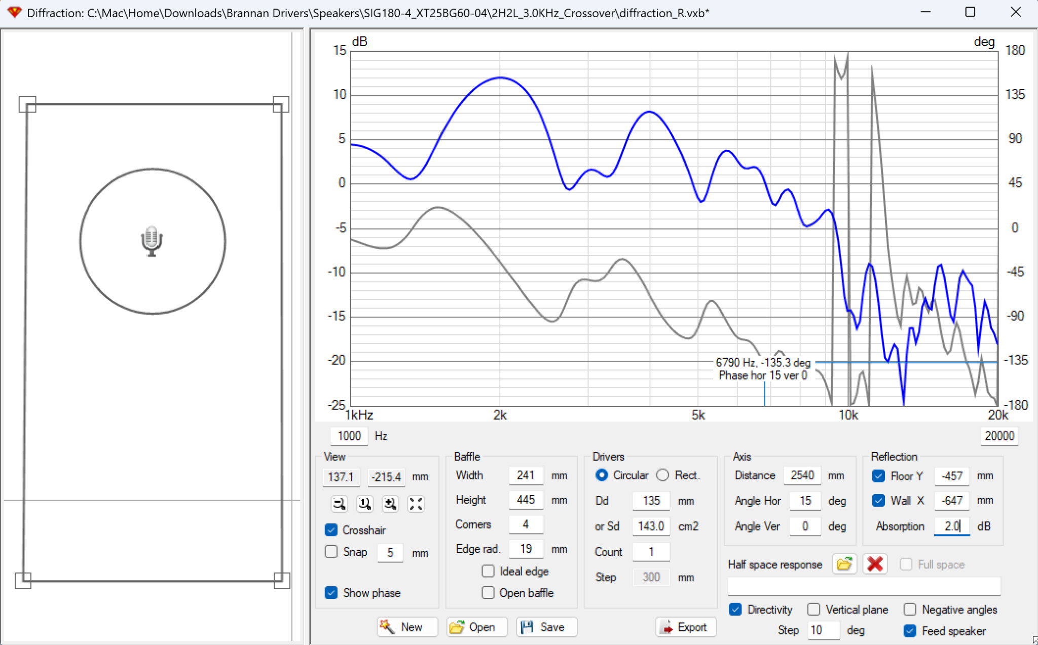

I tried to get diffraction plots for the left and right speakers. The right is further from the wall than the left. Because of the way the tool works I modeled both as a distance from the left wall with the right speaker being farther. Here they are:
The images I posted earlier are of course the wrong way round the second one has your original component values and the first my attempt to flatten things a bit.
As its a metal driver and the Dayton info pack for it had lots of information including a distortion plot, I thought I should try to get the woofer rolled off relatively sharply. Additionally trying to decide on dimensions and baffle may need a few iterations. Can you measure this when the drivers are fitted. All that felt is probably going to modify the response as well.
I made the woofer baffle at 241 x 444 mm, with the woofer centred at 290 mm vertical height and centre width at 120mm. with mic on axis at the same location.
The tweeter baffle I assumed at width 164 mm by height 144. with tweeter and woofer aligned in the middle for its measurement, maybe combining the baffles would make it look nicer and improve the vertical directivity.

You have one thing most of us would do differently: you measured everything and simulated everything where listening point is not in line with tweeter. From the picture in #4 post I see that tweeter is more or less in ear height, so measurements, simulations and everything else should be with X, Y, Z = 0 for tweeter.
Then... You are Imperial units dude and probably do not understand, that "m" and "mm" kinda differs - 1 "m" = ~1.1 yards, 1 "mm" = 0.001 "m" = ~1/25.4 of inch. In your case distance between tweeter and woofer is ~ 187mm. Picture shows 187m
Forget about the room reflections in VituixCAD. First make the neutral crossover, simulate it and then make room corrections if needed. Diffraction tool should be used without floor and wall bounces for this.
Ok. That is the first part. You are making huge jumps in design, but are making big miscalculations. The best bet would be to follow this:

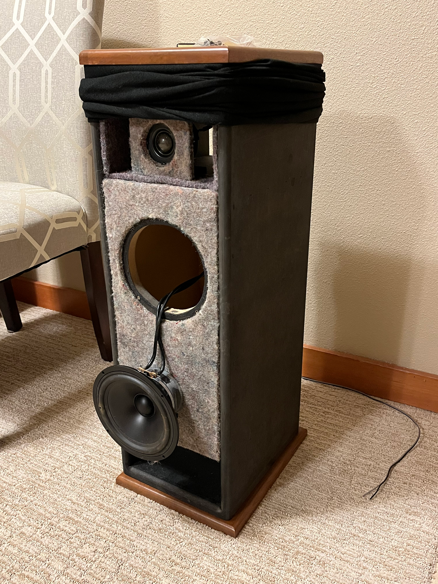

The existing tweeter baffle is 102mm square. The new one will be 104mm.
The woofer enclosure is 21.6 Liters. It is ported with a 50mm ID and a length of 84mm. It is not flared at either end. The enclosure is about 20% full of fiberglass insulation a little denser than in USA home walls. If it might improve the box, I have 3mm bitumen sound deadening material that might be adhered to the wall. (difficult to do through the woofer's mounting hole.)

- Floor 0
- Bottom of woofer enclosure 140mm
- Woofer Center 454mm
- Top of woofer enclosure 584mm
- Tweeter Center 641mm
