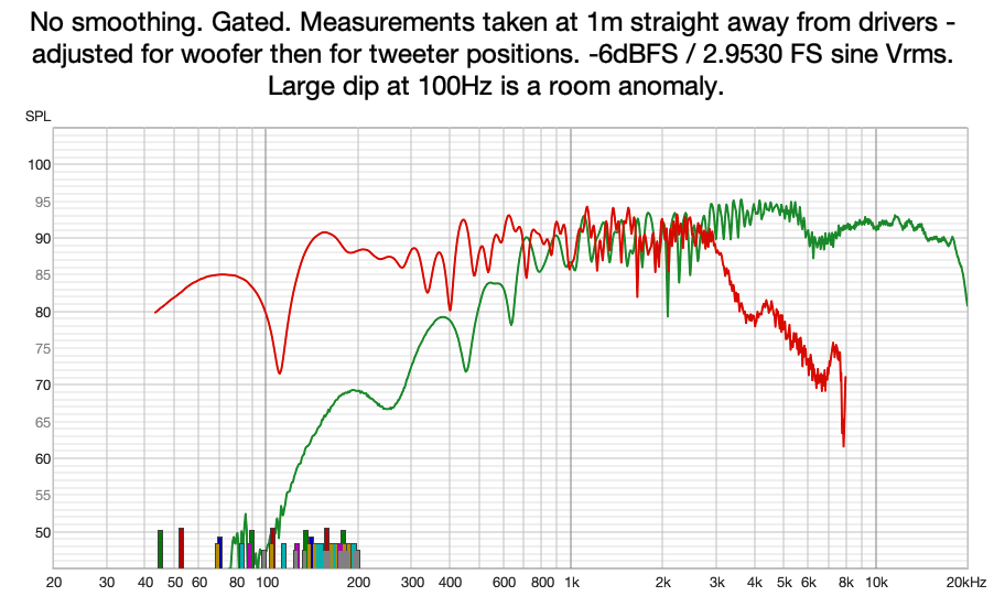

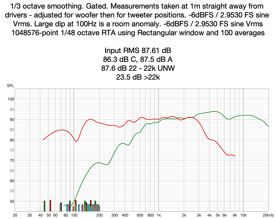

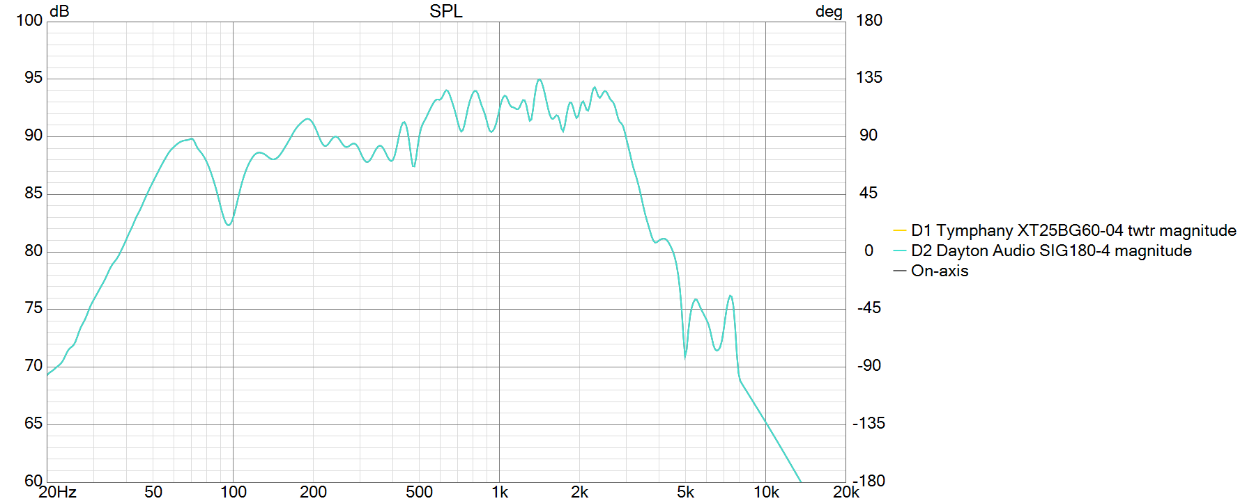

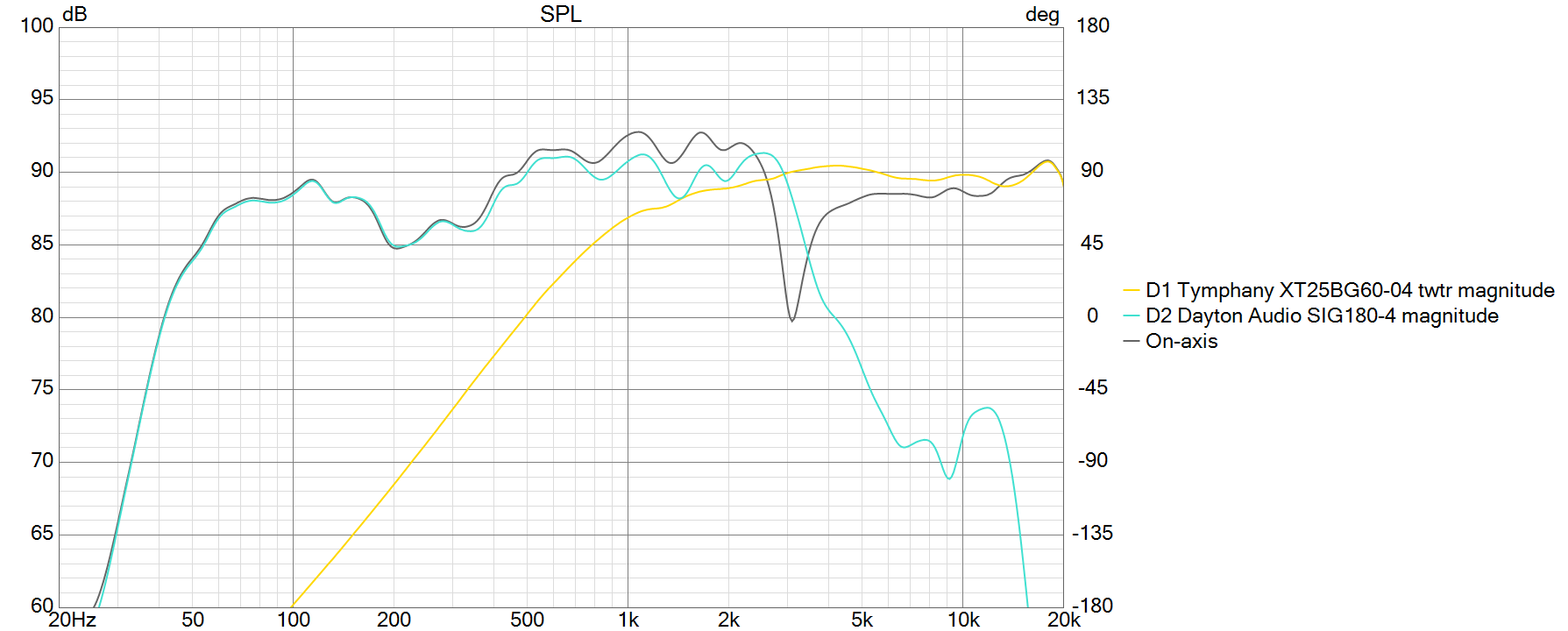

I thought I might invite comments upon the measurements I've taken. Below is the Vituixcad2 graph of how the woofer and tweeter were expected to perform without a crossover. After that are two graphs follow from REW, one without smoothing and one with it, representing SPL sweeps taken indoors. There are, of course, room modes affecting the graphs, so I gated the empirical data. This helped somewhat, however, there is a pronounced dip at 100Hz which I hope is a room anomaly. With my little experience, I'm not sure if I should be happy with the measurements or not. I'm trying to figure out how to modify the crossover given actual SPLs.
I am doing additional measures of +/-15, 30, and 45 degrees. I'm not yet sure how to use that data to get a directivity graph (baby steps).
that's very probably the case.
What gating times did you use?
Getting response down to 100 Hz is usually not possible when excluding reflections.
Usual gating times for anechoic results will be around 5 ms.
Did you use the impulse response graph to set your gating?
Reactions: Inman
@stv I used the IR graph to set a gate time of 23.2msec past the peak. When I used a point closer to the peak I began losing the lower frequencies output in the SPL graph. I haven't thought that through, so I don't know why these frequencies disappear when the gate time is closer to the peak. I didn't change the left parameter, only the right.
Its good that you are back on the measurement path.
Loosing low frequency data information does seem a bit strange, Maybe the gate moves as you adjust one parameter? I wonder can the gate can be locked somewhere just in front of the impulse at approx 300mS for a microphone positioned at 1metre.
I often use a overall viewing window of 10mS for indoor type work. I have a small room, and the reflections come back within that viewing window setting.
Moving the right hand window cursor closer to the first cursor at 3mS I loose low frequency data which is to be expected. Typically crossing to a tweeter at 2KHz and above its not an issue as you are using the hi resolution data from the 1-4kHz and higher, with its associated minimum phase data to show you how the drivers and crossovers interact.
Good luck with the next stage of measurements.
Reactions: Inman
That's why you either just disregard the low frequencies with your measurements and rely on simulation of your woofer enclosure or you do a nearfield measurement of driver and eventual port, merge those using the correct ratio, apply baffle step simulation and splice the measurement.
See vituixcad manual for details!

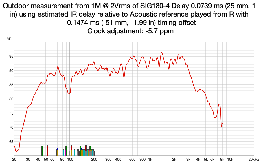

I'm having a problem with my woofer. I believe it's caused by interactions with the box dimensions. There is a dip at about 100Hz that seems to causes additional dips and rises with its harmonics. Given its low frequency, I'm not sure how to best dampen it within the box? Can anyone suggest the best way to approach this? The box internal dimensions are: 8"x10"x16" or 203mm x 254mm x 406mm. The baffle is the 8"x16" surface. The Dayton SIG180-4 woofer I'm using is vented on its backside and perhaps this contributes to the problem, however, opposite its vent is two inches of fiberglass insulation. The box is ported with a vent sized: 2"ID x 3.3" length or 51mm x 84mm. I believe that it's tuned for about 57Hz and wonder if it might be a little longer? Remember, I'm stuck with this box size. I have fiberglass and sheets of aluminum/bitumen 3mm thick dampening materials. I could purchase other materials but I'm not sure what to do.
I have attached empirically measured SPL curves as they appear in REW and Vituixcad2. Measurements were take outdoors with a calibrated mic from 1M at 2Vrms with the speaker elevated such that the woofer was about 1.2 meters about the lawn. The Vituixcad2 image is without a crossover. I'm not sure why it does not better match the REW image since it is using that as input. Comments on how to address the issue would be very much appreciated. Thank you.

You are correct. I did the measurements at 2M and the 100Hz dip went away.
It's very unnerving seeing a speaker precariously perched so high. My neighbors don't really know what I'm doing - I think I'll put on an aluminum foil hat for their benefit.

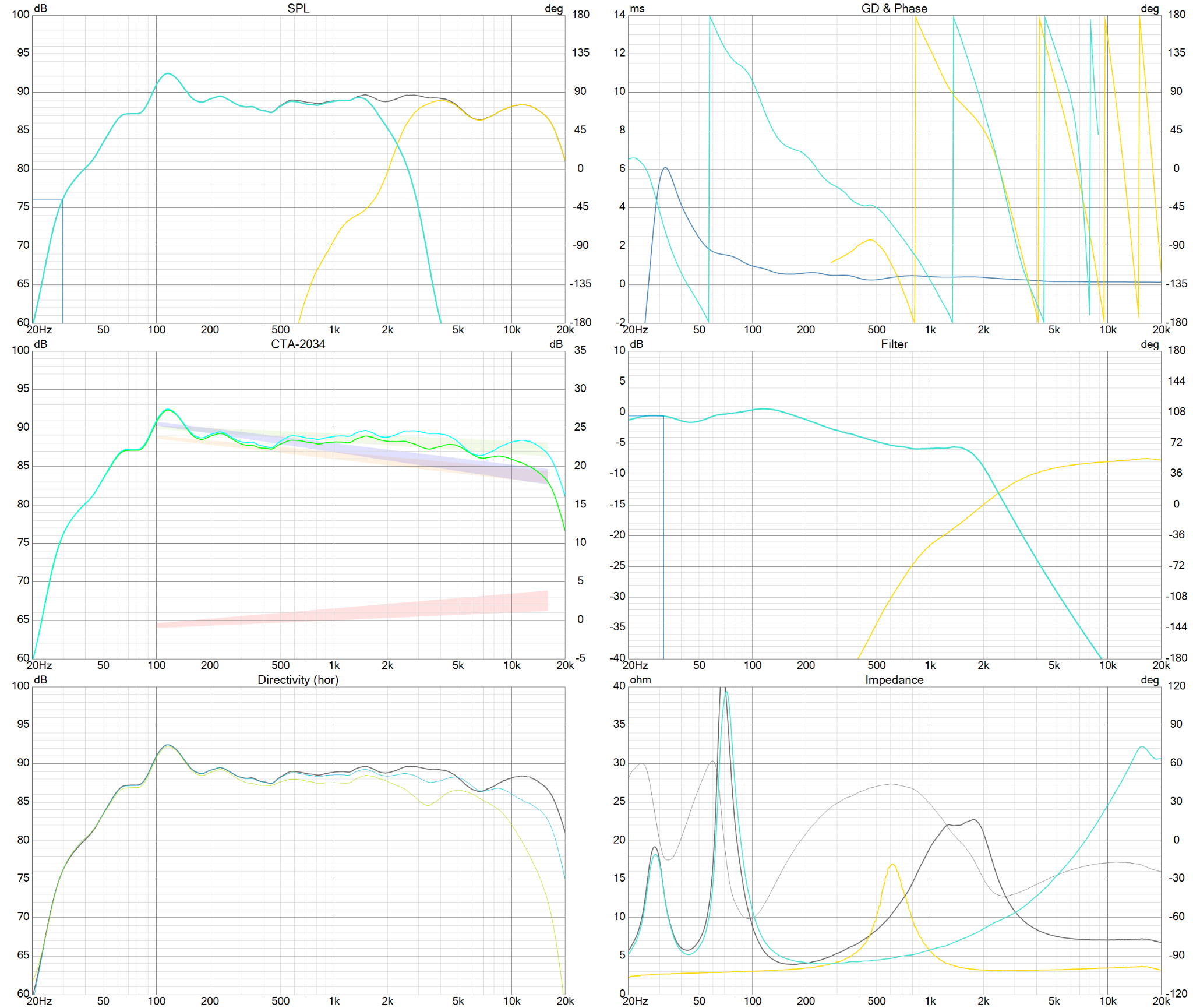

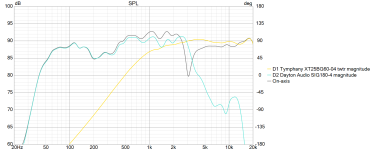

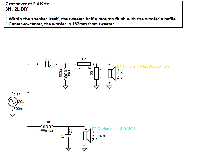

After tuning the port to 41Hz, and getting new impedance values, I took the new SPL measurements elevated to 2M, on-axis, +/-15 degrees, and +/-30 degrees. I had a technical difficulty doing +/-45 degrees, the speaker sitting on a small perch, when turned to 45 degrees, could fall. I loaded these measures from REW to Vituixcad2 and came up with the attached results. What do you think?
