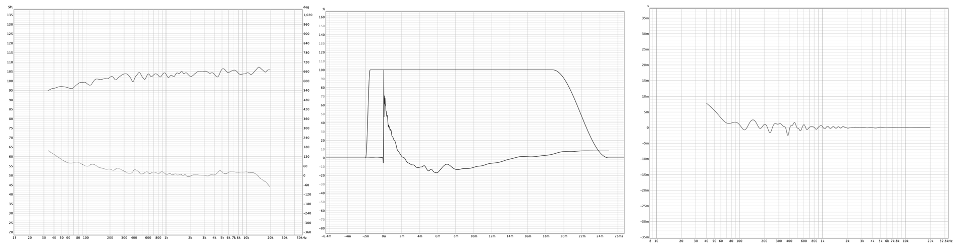

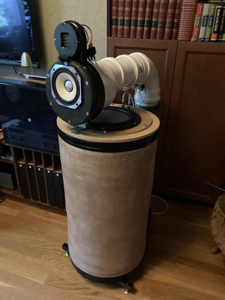

My contraption looks like this. It works very well, and I am trying to understand why.
The low end is a ceramic 70 liter flower/treepot, a more practical solution than concrete when you want to avoid enclosure sidewall emission.
The driver is a 10-inch SEAS H1411_A26RE4, I choose to use a CB enclosure Q≤0.71 because I wanted to avoid resonant components.
The higher end is a Fostex FX120 mounted to a 1.5 meter long drain pipe, commercial brand name "Uponor DECIBEL" intended to reduce flush noise in indoor plumbing. Thicker walls and a special polymer mix with high damping, works very well for my purposes. The pipe is closed and well damped for the same reasons as for the low end, I wanted to achieve a non-resonant "infinitely long transmission line". Not completely successful but it works ok.
On top of this is a Dayton AMT-2 with a series cap of 1 uF only, first order high pass, simply adding to the roll off of the full range driver.
It might be obvious to anyone that my prime objective is to make a system with a "perfect" time coherent step response, and I am driving this with a DSP phase linear Linkwitz-Riley FIR crossover filter, dividing at 240Hz. I am more or less happy with the result, if the time coherent step response is audible and important could be anyone's guess. Science says it is not important but I wanted to try it anyway.

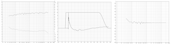

My main simulation workhorse has been lspCad, but this is now quite old and does not work well with off-axis configurations, this is why am now trying to learn and understand VituixCad. I use REW for measurements, and I cannot say I have any expertise there either.
A few more VituixCad questions:
Can the room response be smoothed? It is usually too wild to give any useful information when correlating to the listening impression. Or actually, too much information..
Are the main SPL graphs in the tab "crossover" always free space? My outdoor measurements look a bit like the simulated SPL I get for best step response, the low end is about 6-10dB less than the midrange. This is still working well in the listening room, and I can imagine that a flat free space SPL in my room would be a disaster.
The manual is a bit thin on 2pi and 4pi conditions, and what it really means. I have the impression that 2pi SPL export is removing the diffraction effects completely. The enclosure export of diffracted SPL is not even mentioned in the manual. If it is I have missed it.
[Edit: I should have mentioned that this design is OBVIOUSLY inspired by Linkwitzlab PLUTO, and the detailed description of this system has been very useful to me. However, this implementation is very different in the details, I hope I will not be accused of infringement. My design will not be commercialised.]

To simulate this properly with any capable simulator, you may have to break the process up into several steps and take things under manual control. Vituixcad would have the tools to help you in these stages, it's just that the standard development process may not suit the configuration and you may want to do some hand holding.
The differences will be that if you measure an up firing driver from the side of the speaker in a standard H&V style, the weighting will not be correct. If you measure it from the top, the angular selector in VC will not correspond. And if you simulate it as a front firing driver, the responses won't correspond to the angles.
But it's all possible. May I suggest you consider the original intent of the configuration and don't forget that the reflections are going to be significant in nature and level compared to the direct, and can't be left out.

The main problem right now is that you are trying to simulate complex conditions with very limited information. Results will be inaccurate at best. It sounds like you have a mic and the speaker is already built so my suggestion would be to utilize it as much as possible for analysis of real world conditions.
2pi is nearfield or "infinite baffle" result, enclosure data is 2pi result.The manual is a bit thin on 2pi and 4pi conditions, and what it really means. I have the impression that 2pi SPL export is removing the diffraction effects completely. The enclosure export of diffracted SPL is not even mentioned in the manual. If it is I have missed it.
4pi is far field including baffle diffraction/ "baffle step".
If you have multiple measurements and average them together, each measurement will be averaged with equal "weight". Adjustment of weighting simply means the impact each response has on the averaged result, for example forward facing response is of higher weight than response at 90 degrees to the listener.Thanks for the info. Please explain the meaning of the term "weighting", I am not 100% familiar with the audio science terminology. I have been a hobbyist for 30 odd years, but I am still learning.
